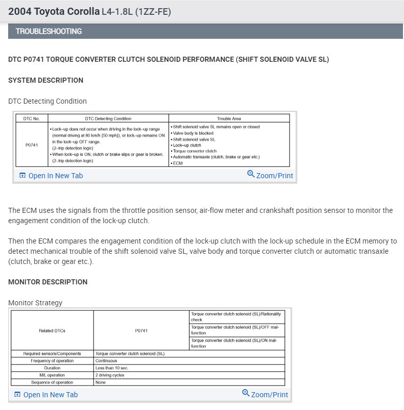

P0741 code. How do I troubleshoot this?
Apr 14, 2022 at 2:56 AM
SQM
  • 6,383 POSTS
The code: P0741 Torque converter clutch solenoid performance (shift solenoid valve sl).

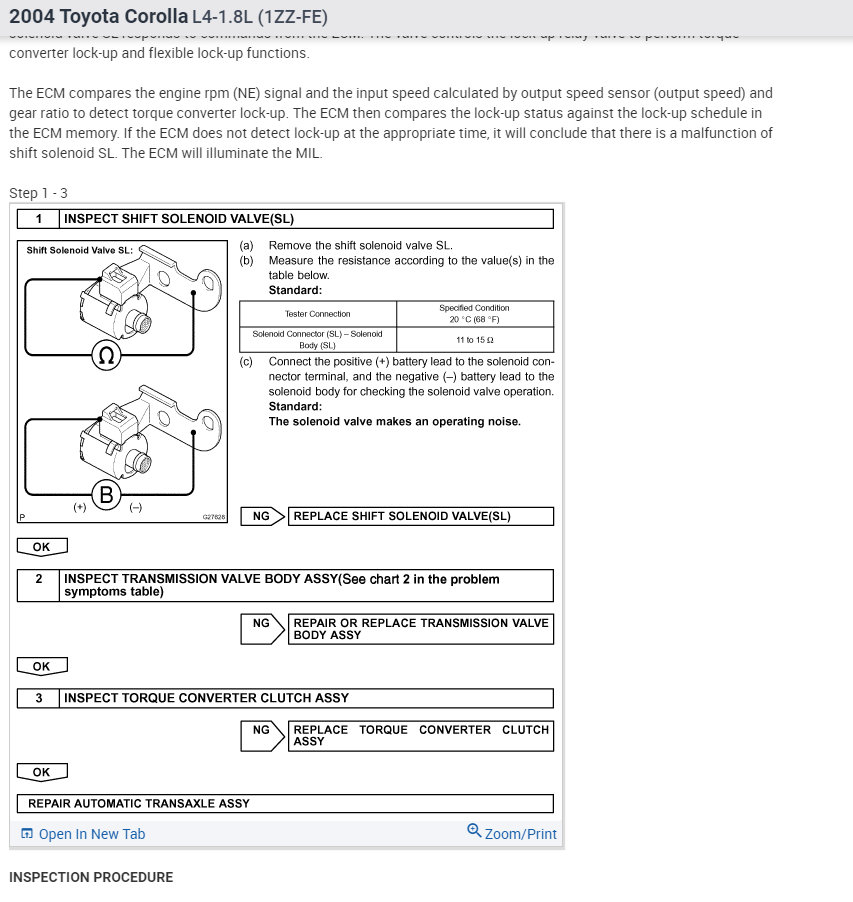

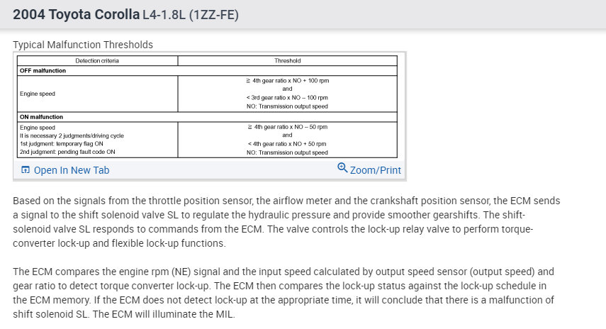

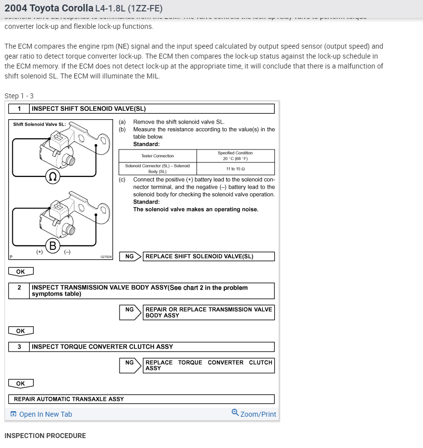

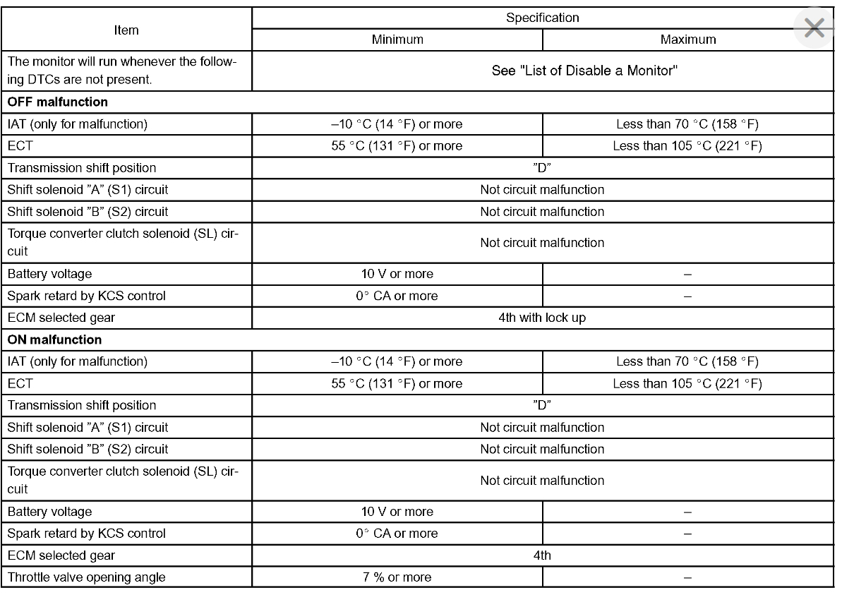

This code typically gets triggered when there are shifting issues.
I have attached the troubleshooting guide for this code below.
