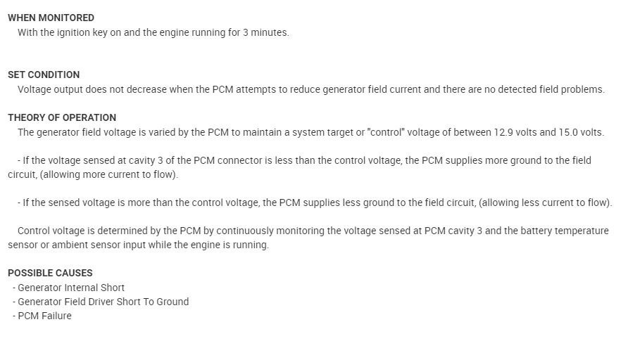

Check engine light on Error codes: 12 32 41 54
1994 PLYMOUTH GRAND VOYAGER
178,000 MILES • 3.4L • 6 CYL • 2WD • AUTOMATIC
WILLYOK
Error codes:
12
32
41
54
May 27, 2020 at 5:06 AM
Good afternoon,
I attached the code chart for you.
12 is the battery disconnect. Do not worry about that.
55 is the end of the sequence.

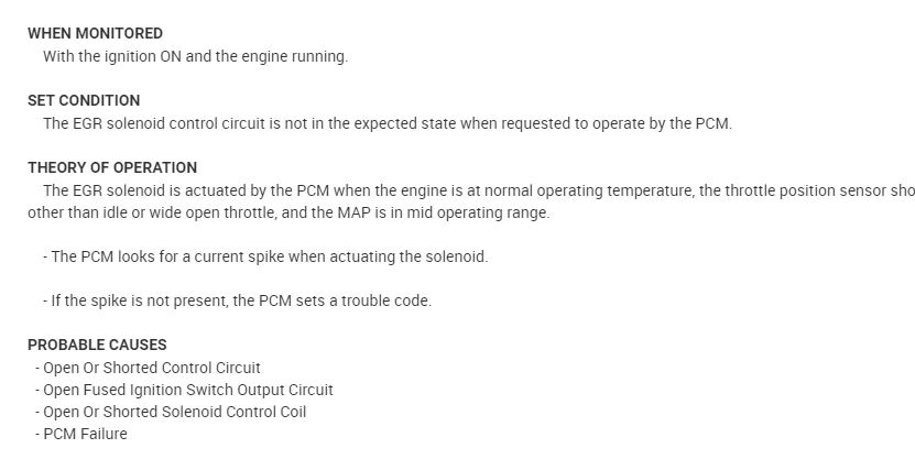

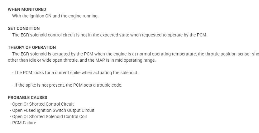

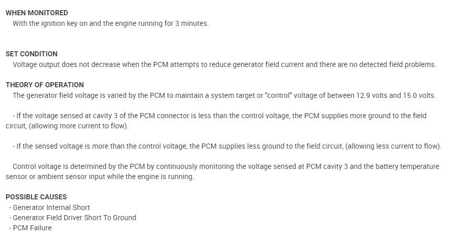

32 and 41 are for the EGR solenoid and the generator field circuit.

TROUBLE CODE NO. DRB II DISPLAY DESCRIPTION OF FAULT CONDITION
11* No crank reference signal No distributor reference signal detected during engine cranking.
12* Battery Disconnect Direct battery input to PCM was disconnected within 50 Key-on cycles.
13** Slow change in MAP signal MAP output change is slower and/or smaller than expected at idle.
or
No MAP pneumatic change No difference recognized between engine MAP reading and barometric pressure reading at start-up.
14** MAP voltage too low MAP sensor input below minimum acceptable voltage.
or
MAP voltage too high MAP sensor input above maximum acceptable voltage.
15** No vehicle speed signal No vehicle distance (speed) sensor signal detected during road load conditions.
17* Engine is cold too long Engine coolant temperature remains below normal operating temperatures during vehicle travel (thermostat).
21** O2S stays centered Neither rich nor lean condition is detected from the oxygen sensor input.
or
O2S shorted high Oxygen sensor input voltage maintained above normal operating range.
22** ECT sensor voltage low Engine Coolant Temperature sensor input below the minimum acceptable
or voltage.
Coolant sensor voltage high Sensor input above the maximum acceptable voltage.
24** TPS voltage low Sensor input below the minimum acceptable
or voltage.
TPS voltage high Sensor input above the maximum acceptable voltage.
25** IAC motor circuits A shorted condition detected in one or more of the IAC control circuits.
27** Injector control circuit Injector output driver does not respond properly to the control signal.
31** Purge solenoid circuit An open or shorted condition detected in the EVAP purge solenoid circuit.
32** EGR solenoid circuit An open or shorted condition detected in the EGR transducer solenoid
or circuit.
EGR system failure Required change in fuel/air ratio not detected during diagnostic test.
33* A/C clutch relay circuit An open or shorted condition detected in the A/C clutch relay circuit.
34* S/C solenoid circuits An open or shorted condition detected in the speed control vacuum or vent solenoid circuit.
35* Radiator fan relay An open or shorted condition detected in the high or low speed radiator fan relay circuit.
41** Generator field circuit An open or shorted condition detected in the generator field control circuit.
42* ASD relay control circuit An open or shorted condition detected in the auto shut down relay circuit.
or
No ASD Relay PCM did not detect ASD
Output voltage at PCM sense signal, after grounding ASD relay.
43** Ignition coil # 1, 2 or 3 Peak primary circuit
primary circuit current not achieved with maximum dwell time.
46** Charging voltage high Battery voltage sense input above target charging voltage during engine operation.
47** Charging voltage low Battery voltage sense input below target charging voltage during engine operation. Also, no significant change detected in battery voltage during active test of generator output.
51** Lean O2 signal Oxygen sensor signal indicates lean fuel/air ratio condition during engine operation.
52** Rich O2 condition Oxygen sensor signal indicates rich fuel/air ratio condition
or during engine operation.
Excessive leaning Adaptive fuel value leaned excessively due to a sustained rich condition.
53* Internal controller Internal Powertrain Control Module (PCM) fault condition detected.
55* None Completion of Diagnostic Trouble Code display on the Malfunction Indicator Lamp (Check Engine Lamp).
