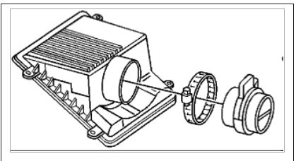

The truck is running smoothly cold and hot. Code P01071 turned on light. Codes P0174 and P10102 were also present but had not triggered light yet.
Jan 4, 2018 at 3:14 AM
  • 55,758 POSTS
We do not know what the P01071 is it needs to be five digit but the lean mixture code P0174 is usually caused by a cylinder misfire or the MAF sensor needs to be replaced. I would use all AC Delco parts to do the tune up with wires as well. I would also get the MAF for ACDELCO as well.
Here are guides that will help us get started:
https://www.2carpros.com/articles/how-to-replace-a-mass-air-flow-sensor-maf
and
https://www.2carpros.com/articles/how-to-tune-up-a-car-engine

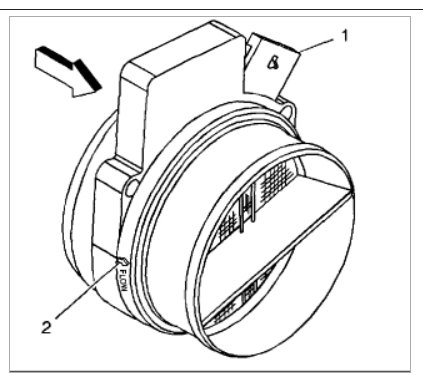

It was P0171 lean on the other bank. I now suspect a larking intake manifold gasket.
Jan 5, 2018 at 7:56 AM
BDOML
The light went out the day after I cleaned the MAF.
Jan 5, 2018 at 7:58 AM
  • 55,758 POSTS
Nice work, Cleaning does not always help that why I suggested replacing it. We are here to help, please use 2CarPros anytime.
