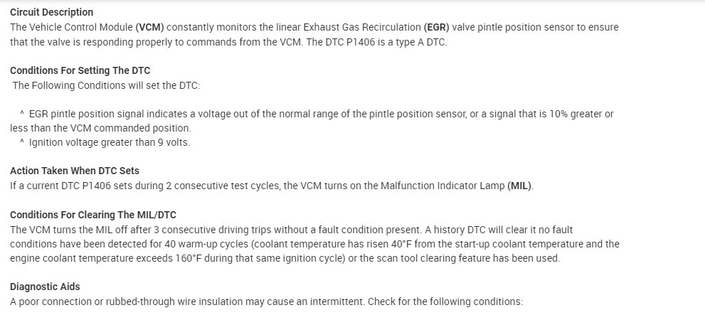

Code p1406 and check engine light on?
175,000 MILES • 4.3L • 6 CYL • AUTOMATIC
SARAHLUU
reads p1406 error code.
Nov 30, 2022 at 6:22 AM
  • 110,248 POSTS

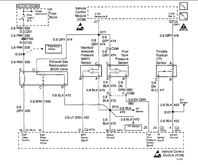

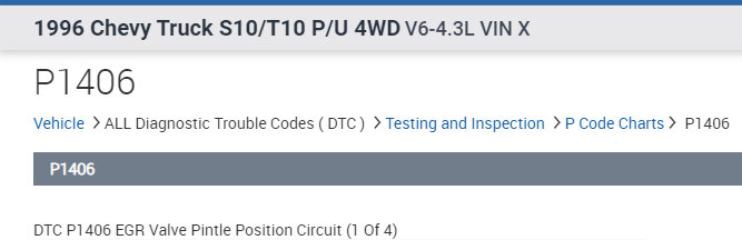

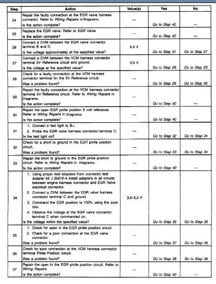

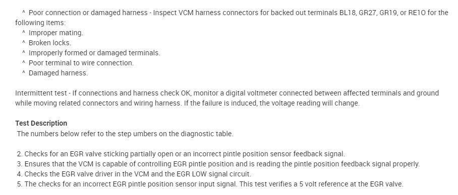

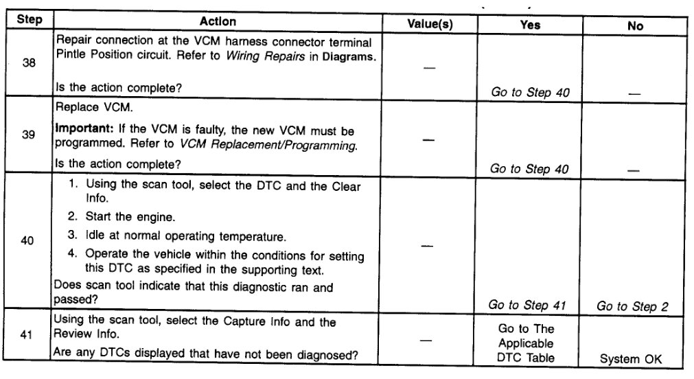

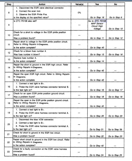

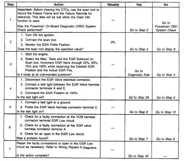

The code is related to the positioning of the pintle valve in the EGR. Have you checked to make sure the pintle is closing fully?
I attached the diagnostics below. Take a look through them and let me know if you are comfortable performing them.
Let me know if this helps or if you have questions.
