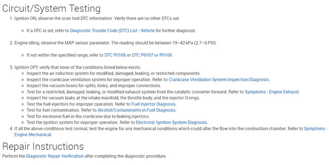

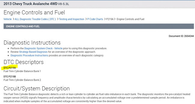

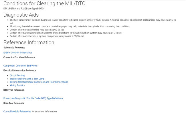

  • 110,248 POSTS
A vacuum leak would cause a lean fuel mixture. Do you know what the short-term fuel trims are? Also, since it is only one side, make sure you don't hear a ticking sound from in front of the catalytic converter (manifold) which can cause a lean mixture.
I attached the description and possible causes below. Note: that one is an exhaust leak pre catalytic converter. That's why I'm suggesting it could be an issue.
Also, toward the end of the descriptions are directions specific to circuit testing. Take a look through them and let me know if you feel comfortable doing them.

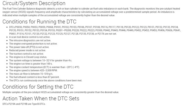

  • 110,248 POSTS
Interestingly, the P2200 isn't listed on this year and model. See pic 1.
The code itself indicates that NOx gases readings are out of parameters. In most cases, the code is set due to a faulty catalytic converter. However, that usually happened due to a different problem such as a misfire, rich fuel mixture, high fuel pressure, and the list goes on.
Again, both the P219A and the P2200 are related to bank one, so that is where the issue is.
So, I have a question. Are there any exhaust leaks? Do you have an infrared thermometer?
If you do, allow the engine to reach operating temperature. Check the temperature of the exhaust pipe before and after the bank 1 converter. See if there is a big difference in the temperature. If there is, chances are it is the converter.
If there is an exhaust leak before the converter, it will indicate a lean fuel mixture causing the computer to compensate by adding fuel. (The high fuel trim 33%)

  • 110,248 POSTS

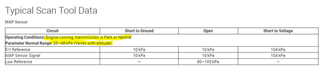

With the engine running, the reading on the scanner should be approximately 8 to 9 inHg which is approximately 4 PSI. I'm questioning if the sensors you got are good.
Take a look at the attachment. It indicates the normal range of 20 to 48 kPa based on altitude. That works out to 2.9 PSI to 6.9 psi. You are double that.
See pic below.

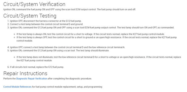

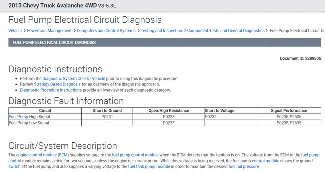

  • 110,248 POSTS

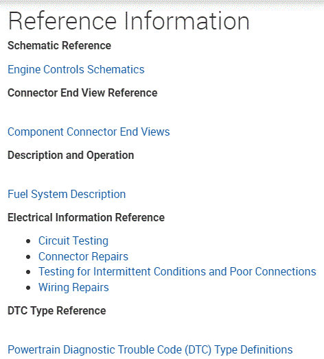

I suspect you are correct. However, even a partially plugged fuel filter can cause the issue. Also, there is a fuel flow control module mounted above the spare tire. Basically, this module is what controls fuel pressure by changing the voltage to the pump based on need.
I attached a description below along with a test you can perform to confirm if it is good or not. However, this should have set a diagnostic trouble code.
Take a look through the pics below and let me know if you have questions.
May 3, 2022 at 10:49 AM
