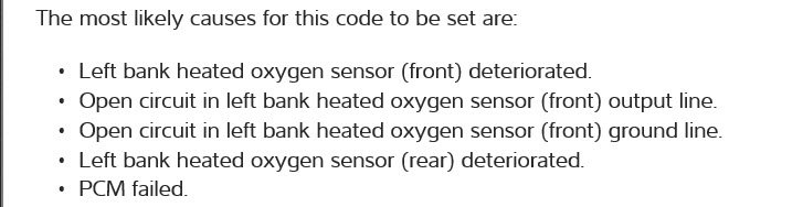

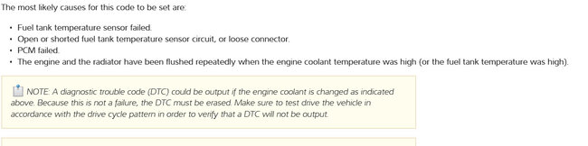

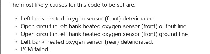

Check engine on found code p 0181 and p0154 am cheng oxigenio sensor bank 2 sensor 1 light stil one pless help thank you

Check for deteriation on O2 sensor or wires check for shorted wires as well see pic for descriptons.181 is fuel tank sensor
