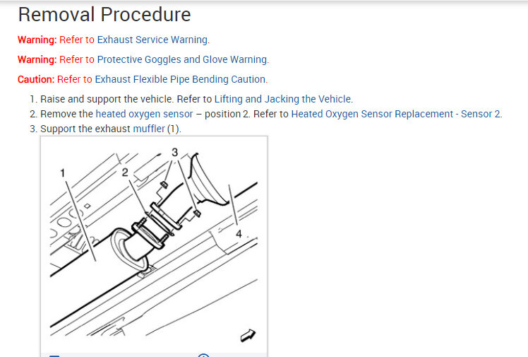

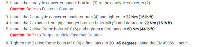

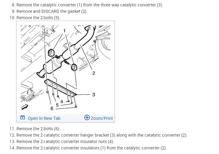

My catalytic converter is going bad and I'm needing to know if there are two catalytic converters on my car.
Mar 15, 2024 at 7:26 AM
  • 110,240 POSTS

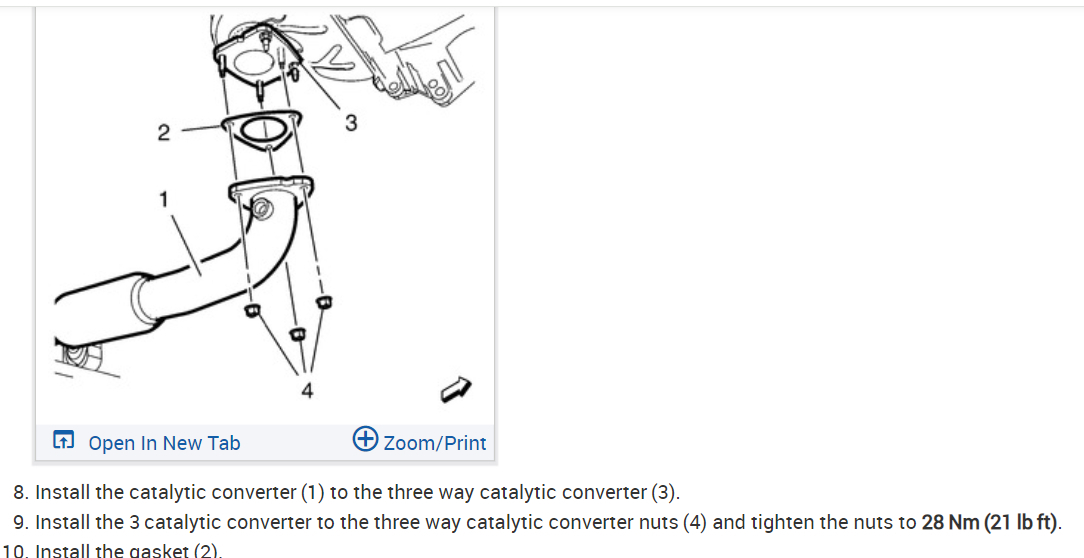

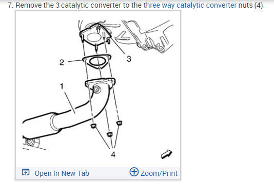

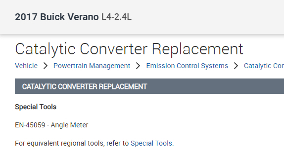

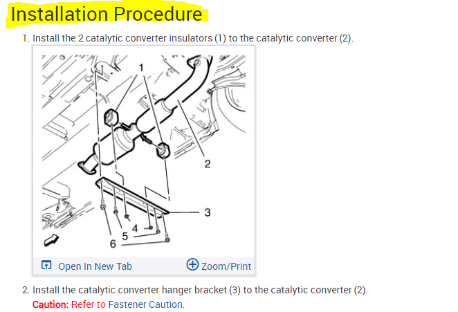

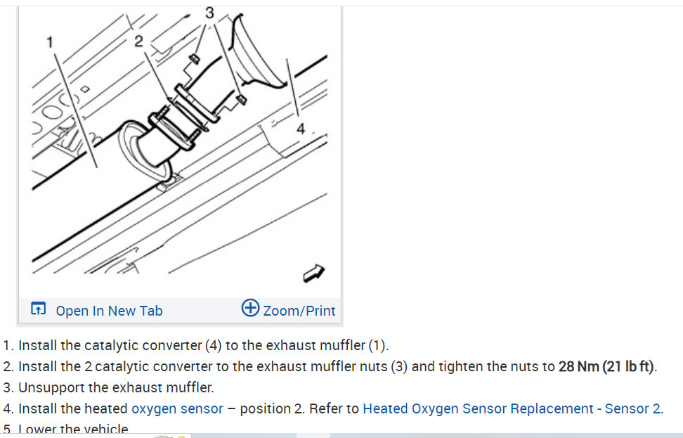

On this vehicle, there are two. I attached the directions below for the removal and replacement of the catalytic converter. One is under the vehicle and the other one is integral to the exhaust manifold.
Take a look through the directions and let me know if you have any questions.
See pic below.
