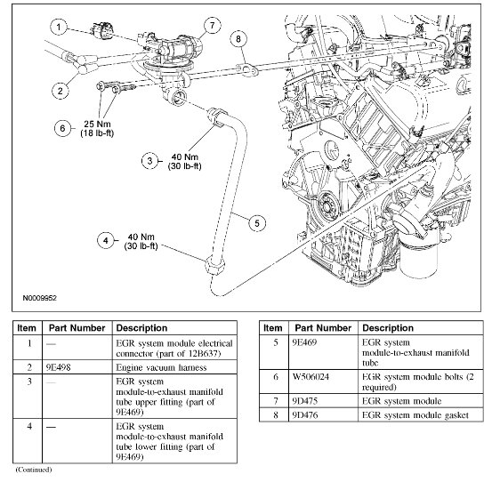

Thank you for your reply. I took those codes from a real basic reader. I will use a more detailed reader and see if I can get the voltage changes that you suggested. Not sure where the EGR solenoid is or what it looks like? Could you help me out with that one? Thanks
Greg
Jan 3, 2023 at 11:23 PM
  • 110,244 POSTS
Hi Greg, I attached a pic below showing the EGR and components. Take a look at them and let me know if that helps.
See pic below.

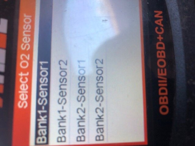

Not sure if this GIF will go through or not. Let me know. My reader does not do fuel trims.
Jan 7, 2023 at 5:30 AM
  • 110,244 POSTS
Yes, the pic did attach. It shows oxygen sensors. Are you able to check the voltage for each sensor?

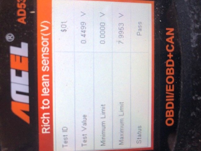

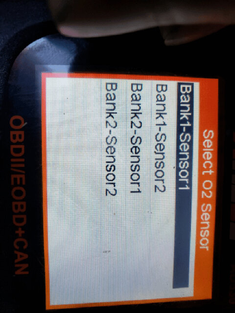

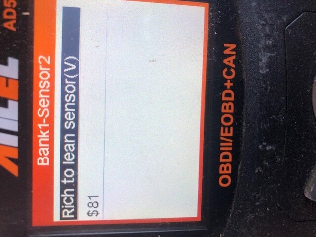

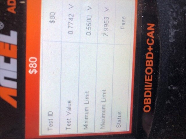

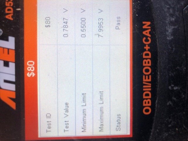

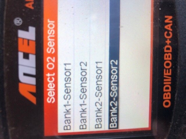

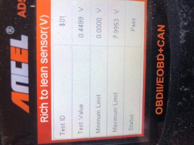

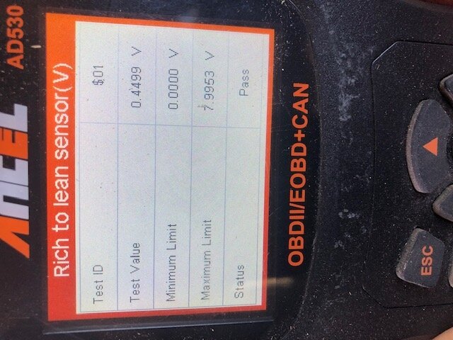

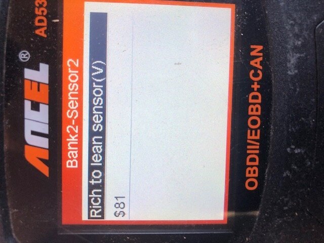

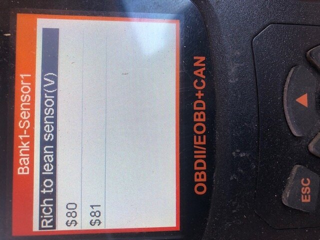

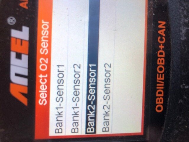

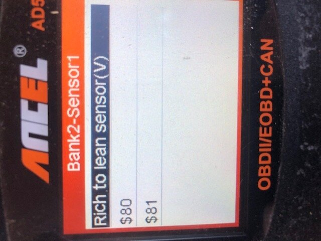

Hello Joe, I am attempting to send Bank 1 Sensor 1 reading. Let me know if you receive it and I will forward the other readings. Thank you.
Jan 12, 2023 at 3:12 AM
PAINT 4440
  • 14 POSTS

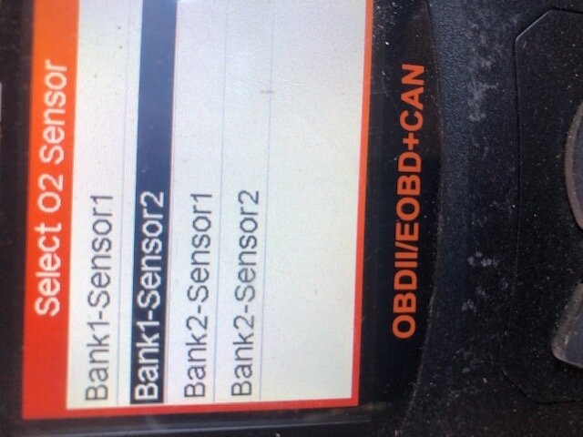

Joe, Bank1,Sensor 2.
Jan 12, 2023 at 3:19 AM
PAINT 4440
  • 14 POSTS
Joe, Bank 2, Sensor 1.
Jan 12, 2023 at 3:25 AM
PAINT 4440
  • 14 POSTS
Joe, Bank 2, Sensor 2.
Jan 12, 2023 at 3:28 AM
  • 110,244 POSTS
I got them. I'm not familiar with your scanner, but everything appears okay. While the engine is running, do the voltages change when you hit the throttle? Also, were you able to get the short-term fuel trims?

I have some readings for you. These are off a data stream that I froze
Short term fuel trim B1 0.0%
Long term fuel trim B1 5 5%
Short term fuel trim Bank 2 0.0%
Long term fuel trim Bank 2 7%
Oxygen sensor output voltage
(B1-S1) .925 V
(B1-S2) .090 V
(B2-S1) .930 V
(B2-S2) .915 V
Feb 9, 2023 at 3:02 AM
  • 110,244 POSTS
The short-term fuel trims are at 0. Was it checked when the engine was at operating temperature? In a perfect world, 0 is perfect. However, it is unlikely.
The O2 sensor voltages are within spec but to the high side. Let me know if you checked the trims when it was warm or if the saved data was when it was warm.

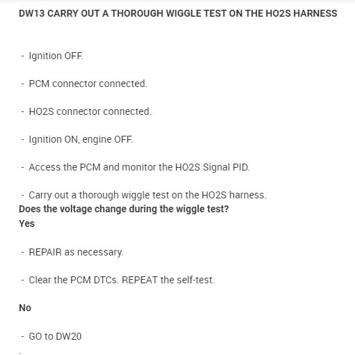

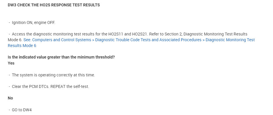

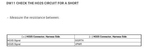

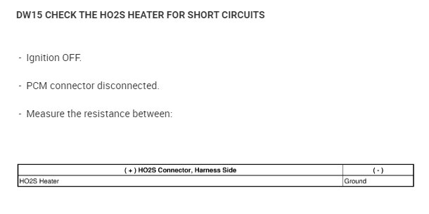

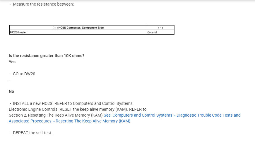

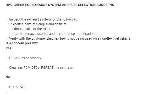

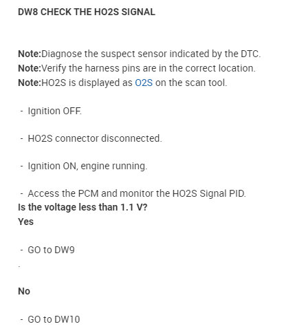

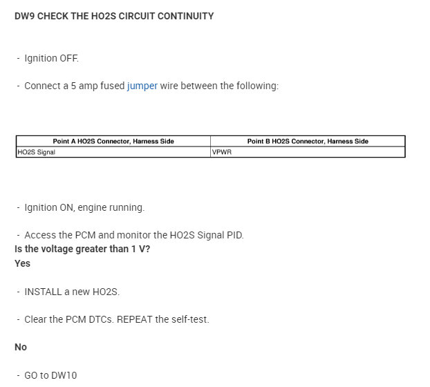

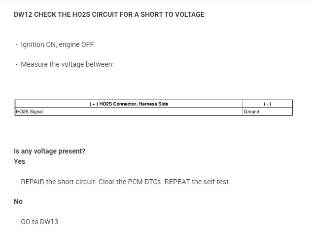

  • 110,244 POSTS

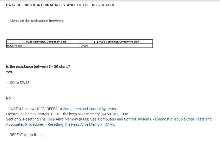

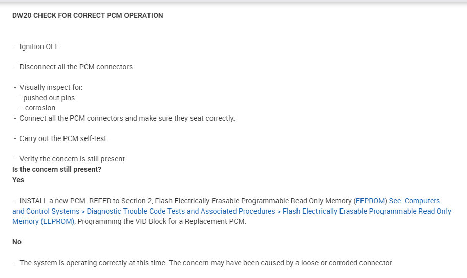

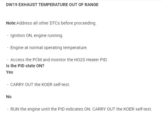

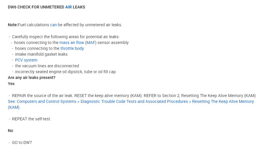

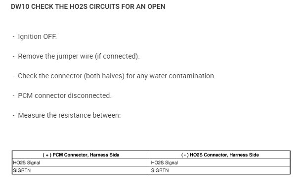

The fuel trims are good. Did you not if the voltages changed when you hit the throttle? They are at the outer limits, so I'm curious how they reacted.

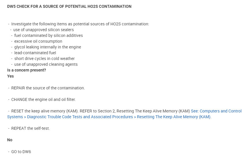

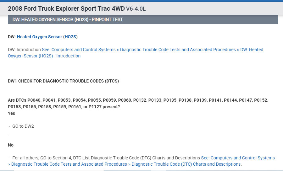

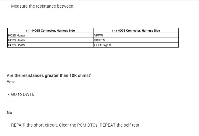

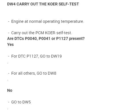

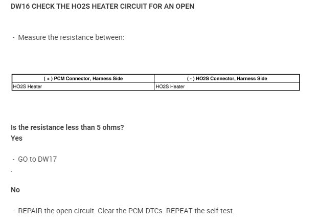

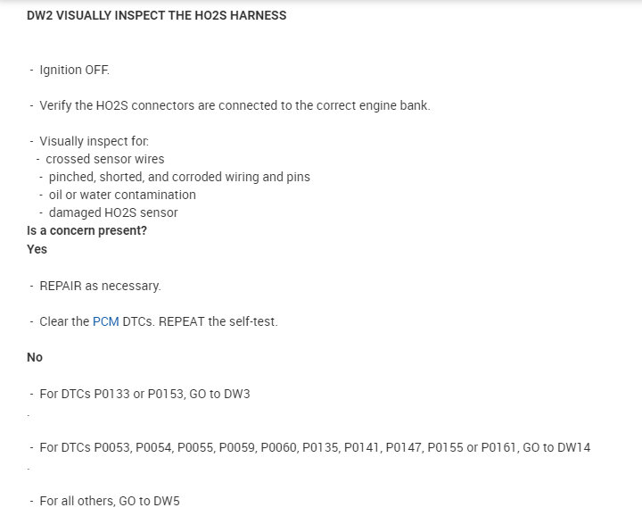

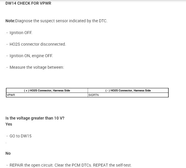

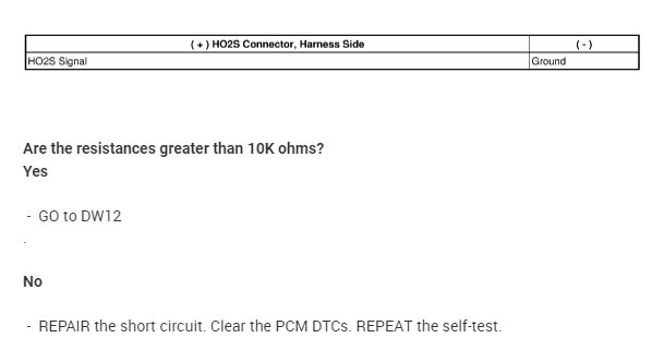

I went through the manual again. I attached the diagnostics below that we need to follow. Don't be overwhelmed. Take a look through them and let me know if you are comfortable performing them.
Take care and let me know your thoughts.
Feb 19, 2023 at 2:18 PM

Hello Joe,
I haven't started checking out the list of diagnostic info you sent but let me run something by you and get your opinion. Is it possible for a bad or going bad PCM OR ECM to throw faulty codes? The reason I ask is on this rig you can check your average mpg running through a sequence on the dash. The last time I checked this it was going bonkers. Anywhere from 8 to over 50 mpg. So, I am wondering if the computer is bad?
Thanks,
Greg
Feb 26, 2023 at 11:31 PM
  • 110,244 POSTS
Yes, the PCM could cause a false code. However, the code diagnostics are usually related to checking the PCM.
