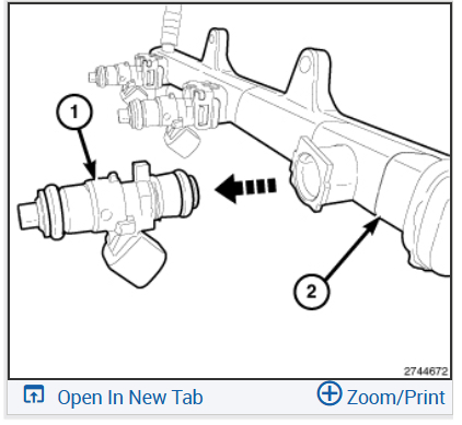

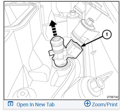

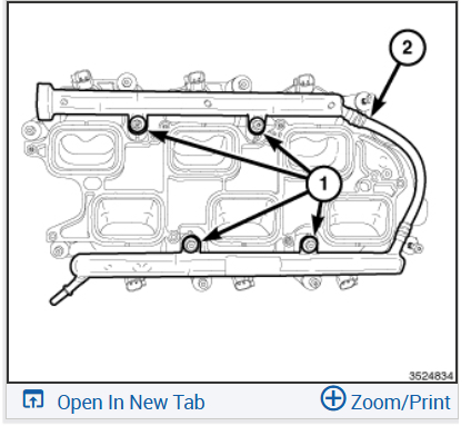

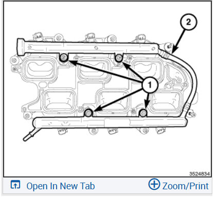

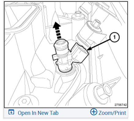

O sorry I saw the 2025 in the year from the post. So with these codes you just need the fuel injector replaced or it is unplugged.
P0303 - Cylinder 3 Misfire Detected
P0203 - Injector Circuit/Open - Cylinder 3
The upper timing chain cover must be leaking and has nothing to do with the engine codes or how it runs, can I ask if you see oil drip on the ground where you park the car? If not I would let it go and just watch the oil level. Unless it is leaking too much then it much be fixed, sometimes a dealer will see a "seep" and call it a leak FYI.
To replace the fuel injector you must remove the fuel rail, check out the images (below). Please upload pictures or videos in your response so I can see how bad the problem is.

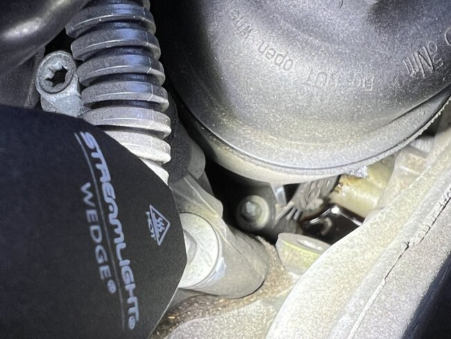

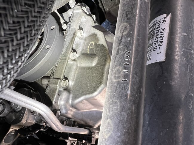

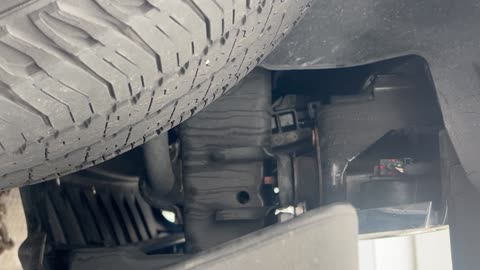

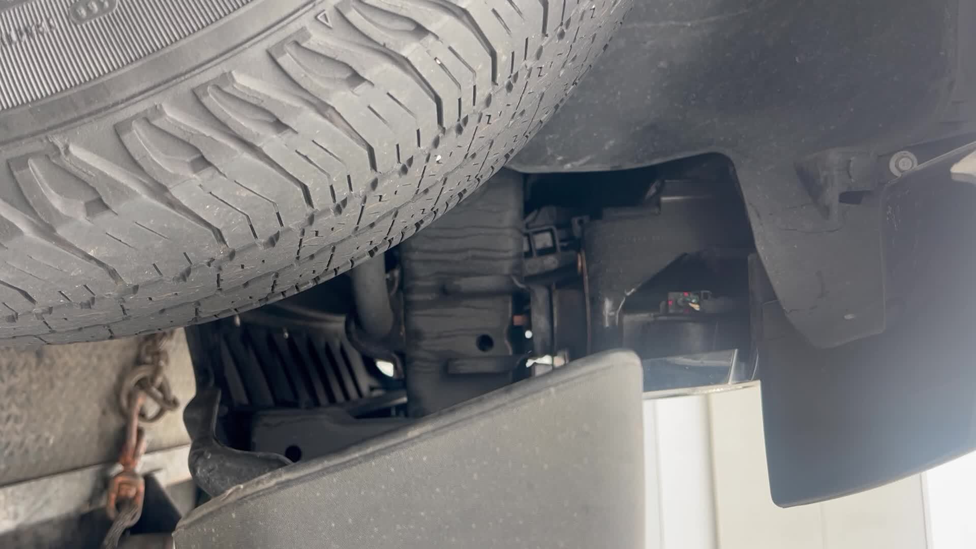

Hi Ken for the upper timing gasket , I did not notice any oil on the ground , but did notice something leakinv. Please see attached photos of the potential leak and let me know your thoughts? I appreciate your help . Thanks
Jul 13, 2025 at 1:20 PM
  • 55,433 POSTS

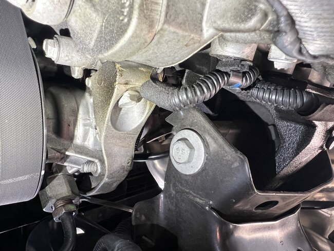

That is a nice Jeep, what you are looking at is not oil leaking, can you raise the hood and take an image of the front of the engine and serpentine belt area? For the 1k are they doing all of the injectors or just one? If just one yes, that is too much money. The cost for one fuel injector is:

Thanks Ken! I really appreciate your insight. To answer your question, the vehicle is at the dealer right now. I am assessing if I want the work done. I can request they take an image of the engine and serpentine belt but I may get push back.
I am probably leaning towards having them hold off on the upper timing gasket so I can vet more quotes and for now get the fuel injectors done if the price is accurate. My only concern is how big is the leak for the upper timing gasket and how long I could drive on it. Ideally I want to get it done asap if that's the issue.

STEVENLEE03
  • 8 POSTS

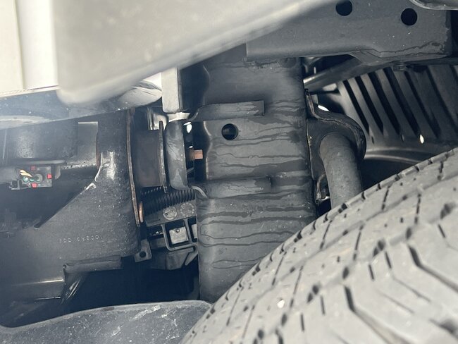

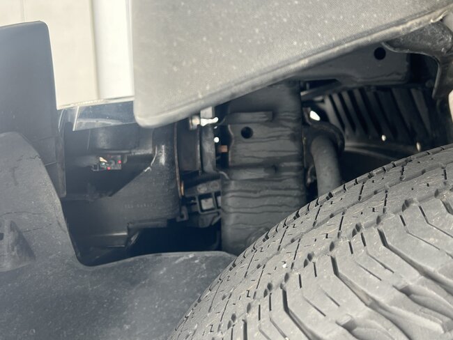

Hi Ken,
Pease see dealer response quote
"Yes the $797 price is labor cost to replace only the 1 faulty injector in cylinder #3
The leak from the timing cover is oil and I have attached some pictures"
Jul 14, 2025 at 5:52 PM
  • 55,433 POSTS
Hmm,, the labor on the high side is $300.00 for the fuel injector, I would take it to a shop that is good in town, I would check google reviews of the shop first. The oil leak must not be bad because I cant even see it? Lol some dealers are this way, they have a lot of mouths to feed. I would take the Jeep somewhere else.
