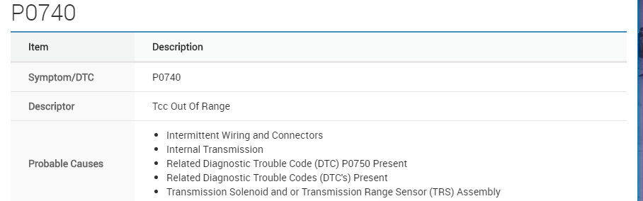

I went to Auto Zone in August after someone had suggested a tune up and got them to check it and the codes were P0700 P0740 P0700. I don't know how reliable they are but really don't know what the next step should be. I don't want to spend $1200 when the problem could be something less extreme. The P0700 reads that a signal was received that the transaxle control module has a fault..

The 700 is a code for general transmission fault. The 740 is the actual fault code for the trans. I attached possible issues for you to view
