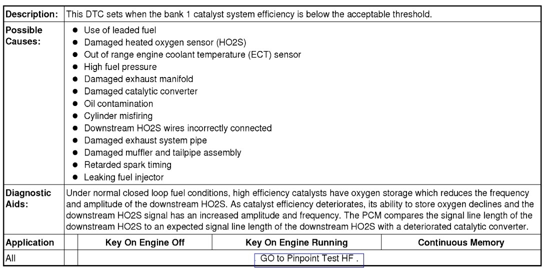

AL514
  • 5,587 POSTS
Here's a list of possible causes that will set a P0420 code, but we should be able to figure out what's going on by scan tool data. Were there any other codes set?
