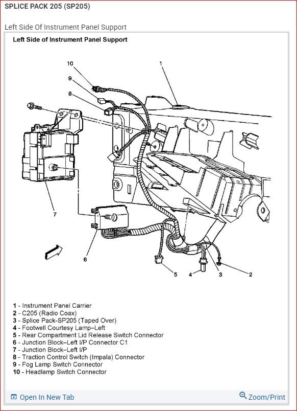

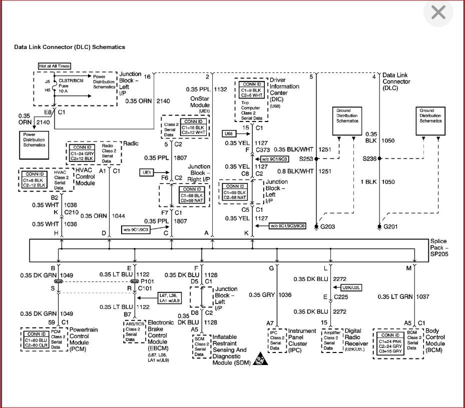

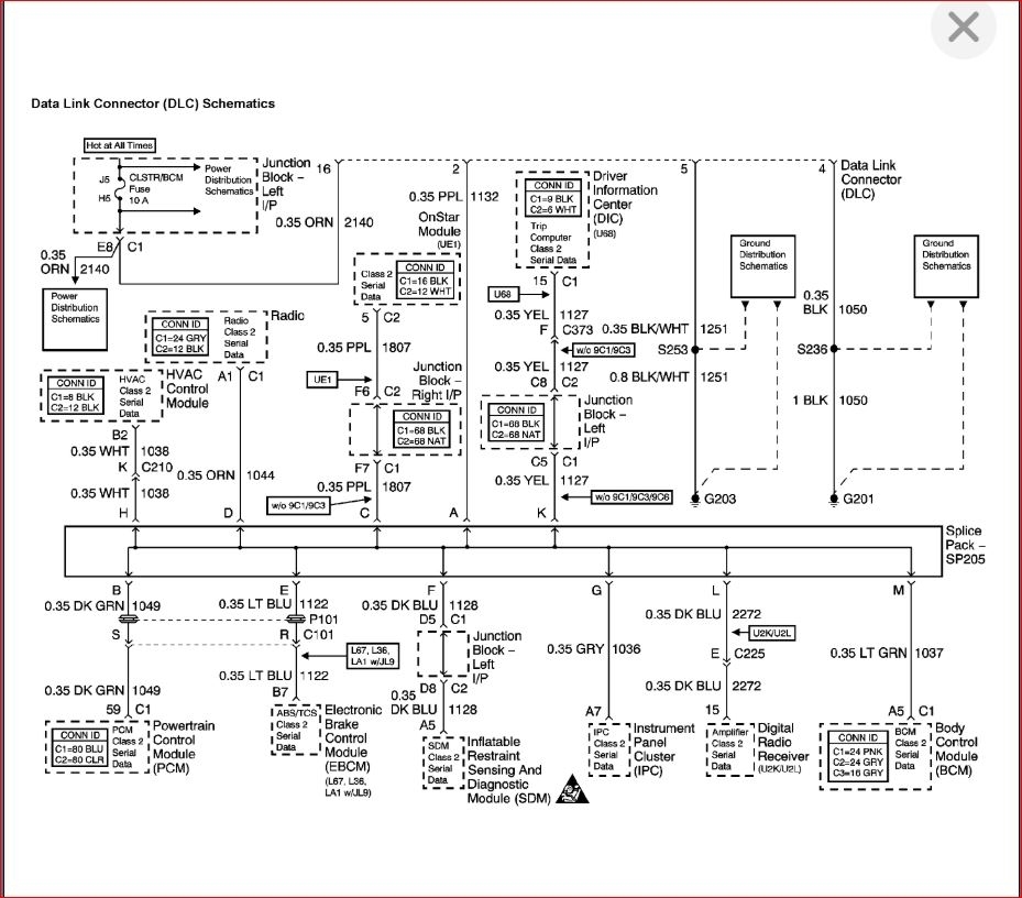

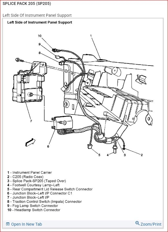

This sounds like to me that the splice pack - SP205 has an issue. The way these code readers work is when it is plugged in it communicates with each module to pull the codes. If it reads ERROR and does not pull any code from any module then it is something that effects all modules.

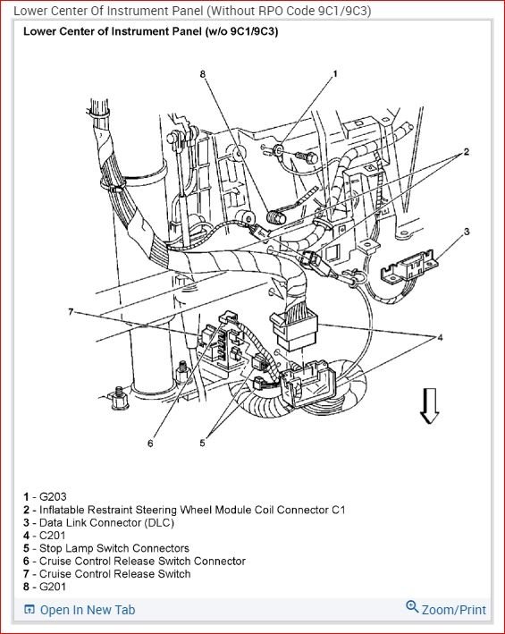

In this same idea, it could be one of the grounds for the DLC, pin 4 or 5.
Please let me know if you have more questions. Here are some guides in the event you want to tackle this yourself. If you are going to and want to bounce some other ideas off me, feel free. Thanks
