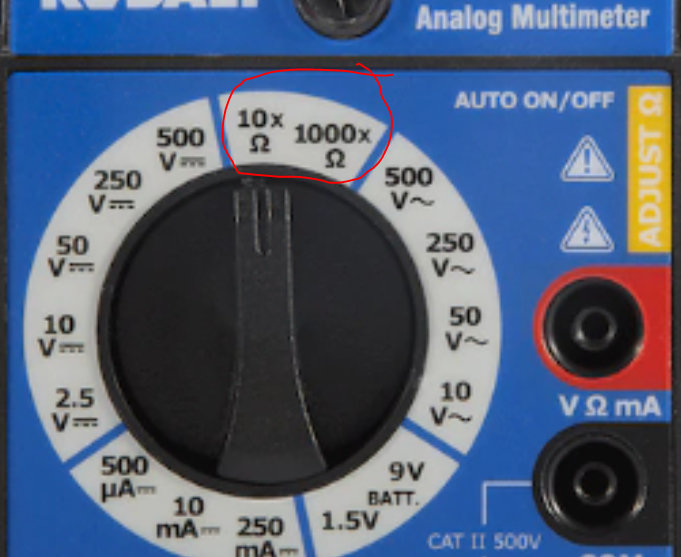

Sorry for my usual delays but I finally bought the Analog Multimeter you suggested but I don't see where I set it to continuity. Can you please let me know how to do that?

No problem. I attached your pic below and circled the two settings for resistance (Ohms) That is what is used to check for continuity.

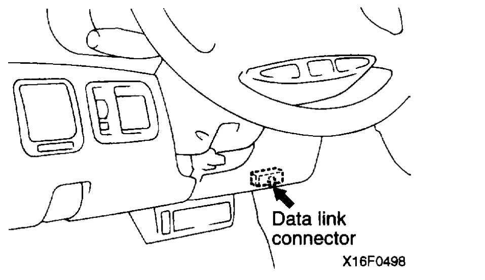

I do not like to be such a pain, but I cannot find the connector anywhere on the 1994 3000GT. Any idea where it could be? I can't seem to find it anywhere need the fuse box or surroundings.

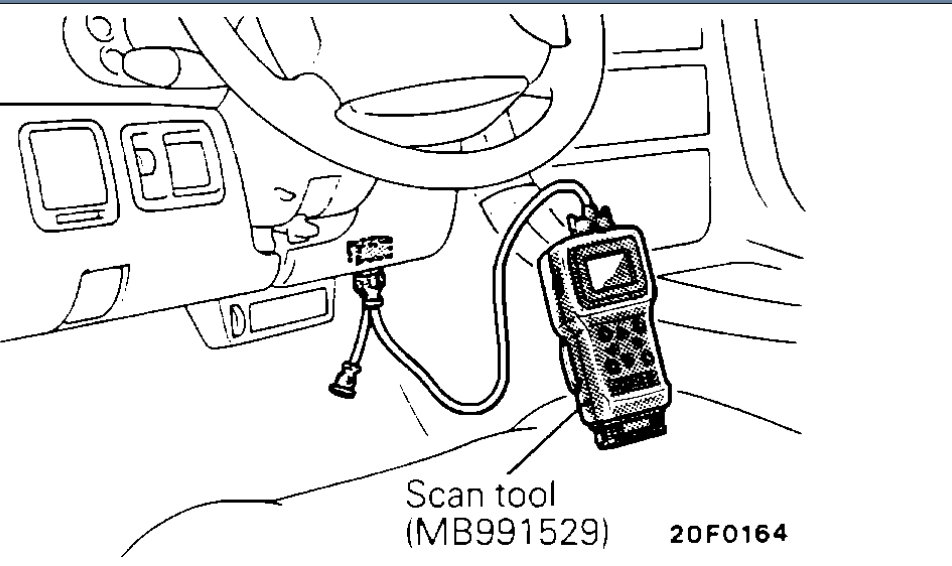

The DLC is located on the left side of the vehicle's passenger compartment under the dash. I attached two pics below. Let me know if you are able to find it.
Sep 25, 2022 at 11:55 AM
