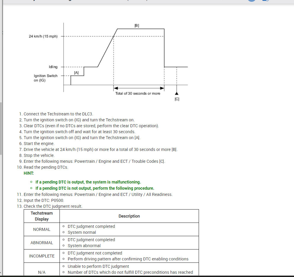

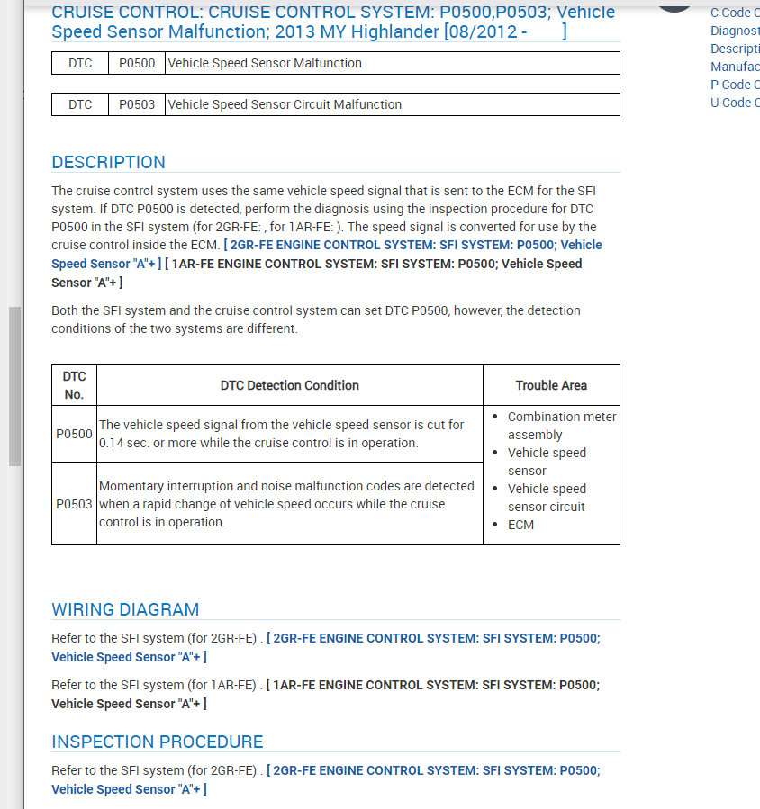

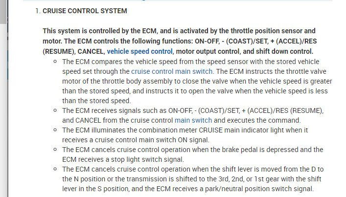

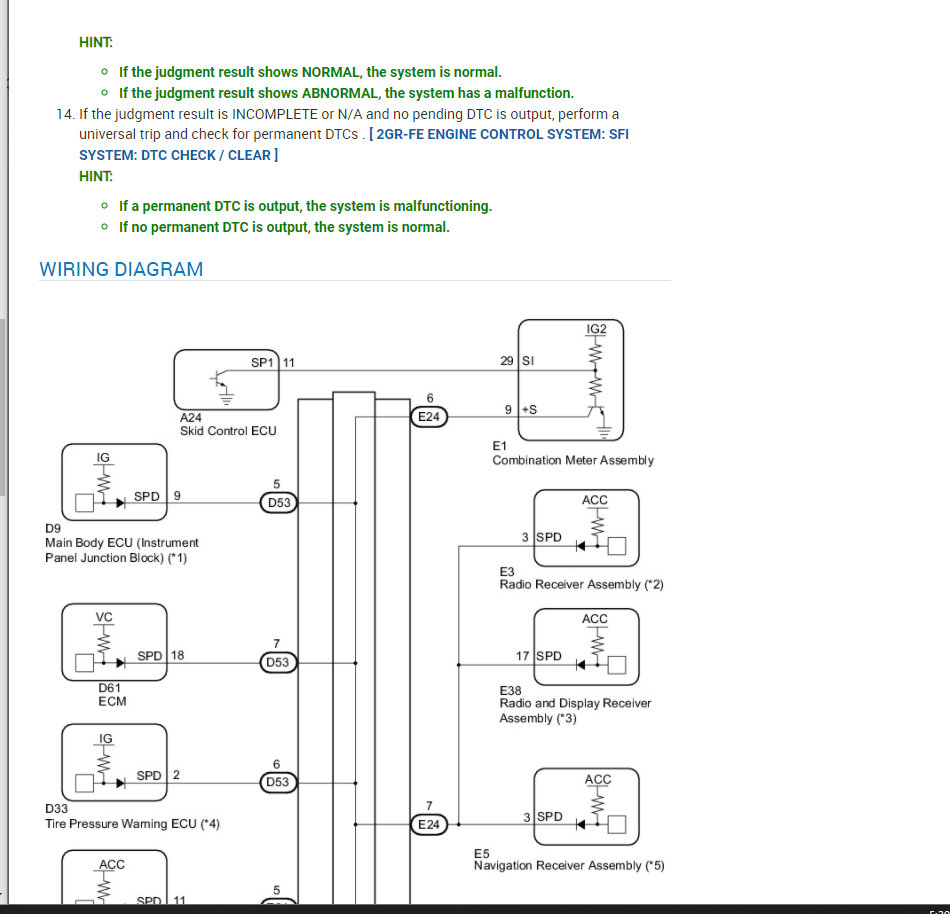

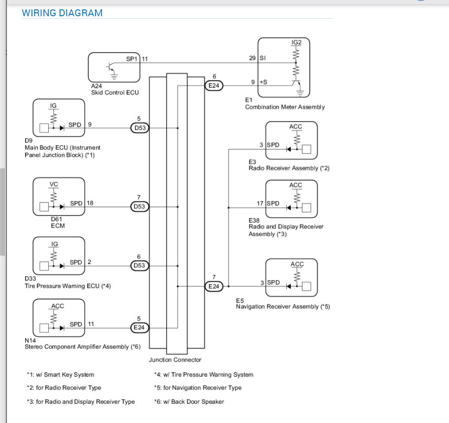

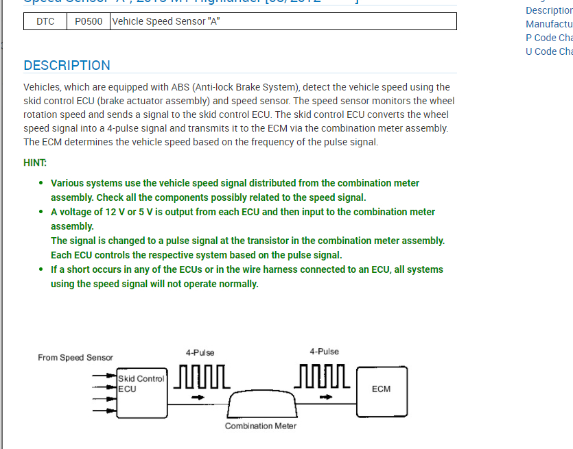

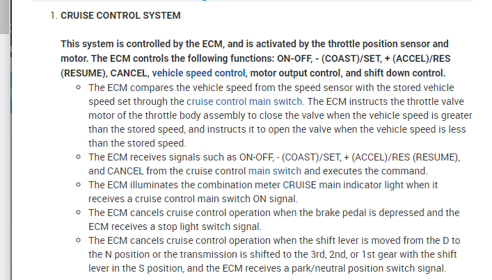

Did you unplug the radio and clear the code to see if it comes back? More than likely this is causing the issue. If you take a look at the wiring diagram below you will see that the speed sensor is used for cruise control operation. So I suspect your cruise control is not working at this point.
If it is not then unplugging the radio will more than likely get it operating again. The wiring diagram on page 7 below shows that the radio system and speed sensor are on the same network that the speed sensor is on. This means when you plugged this aftermarket radio in, it is corrupting the bus communication for the radio to properly communicate with the other system. So the speed sensor is trying to send its signal to the body computer but it is not able to do that because the radio is disrupting this communication.
Here is a guide that will talk about this CAN bus network:
If unplugging the radio and the code is able to be cleared then you will have to contact the radio supplier and ask if they have any solution for this.
Please let us know what you find with this. Thanks

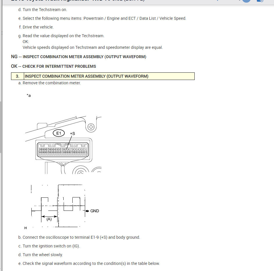

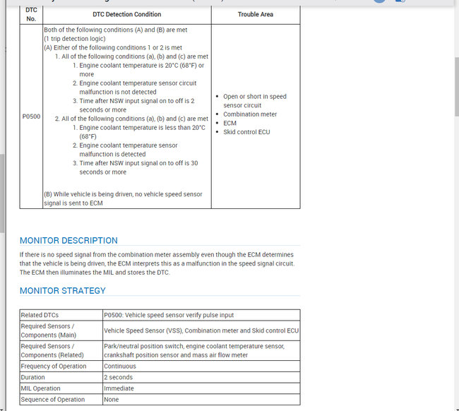

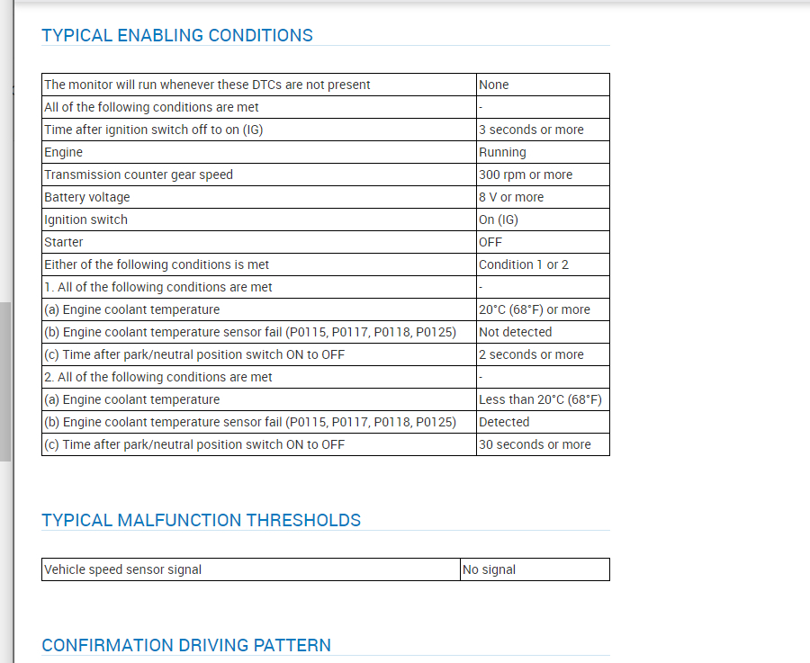

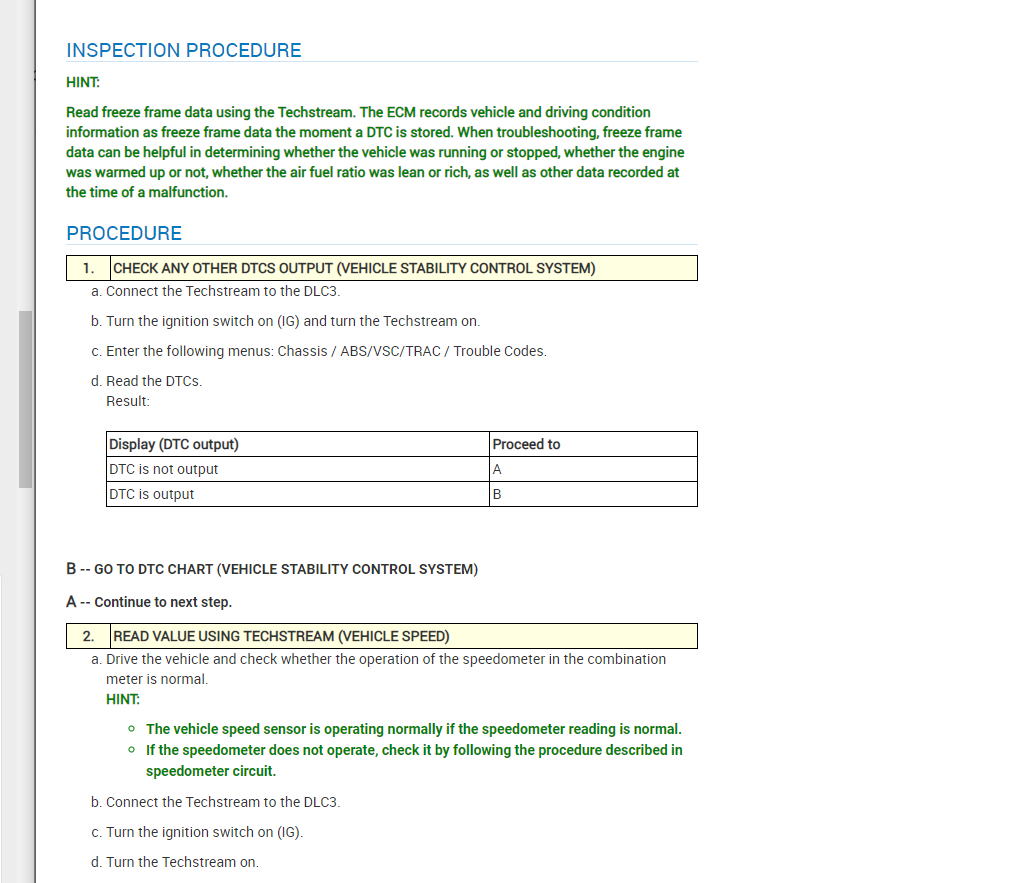

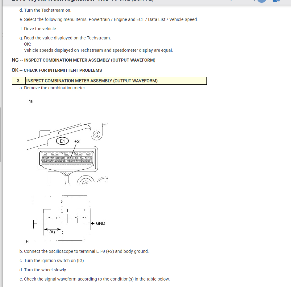

If that is the case, it could be a coincidence. Normally if this was the issue that the network was being corrupt then as soon as it is disconnected then the network clears up and the issue goes away.

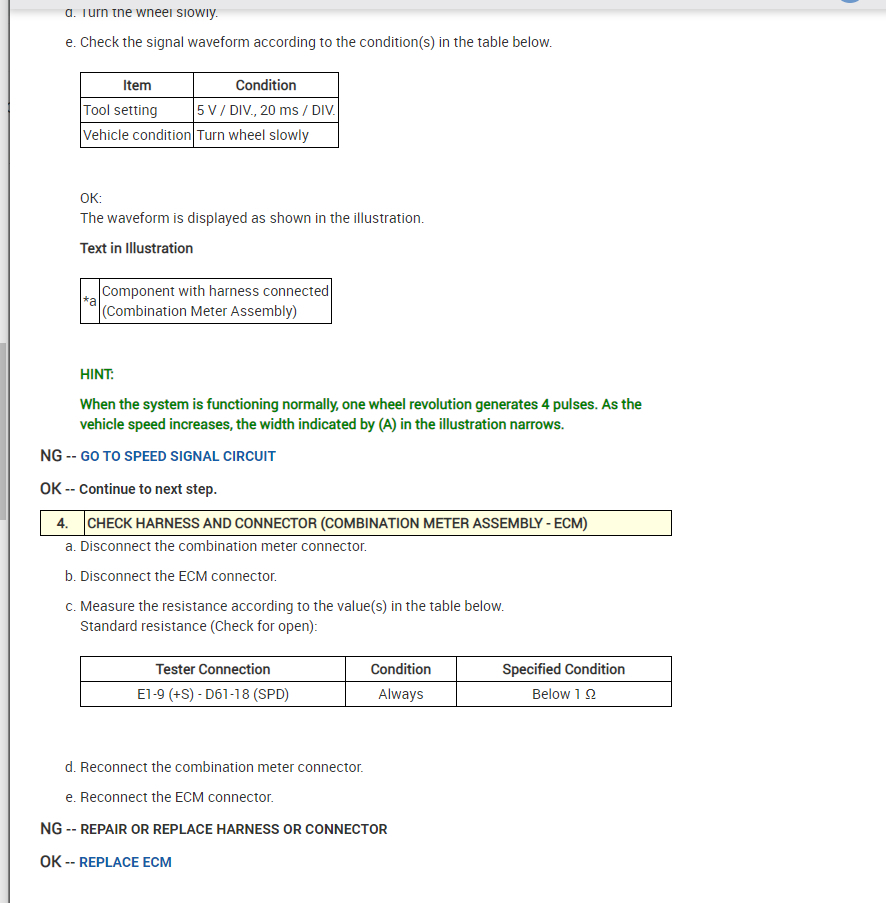

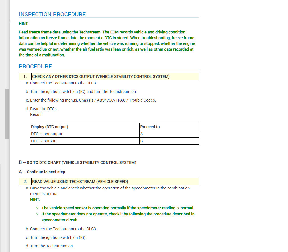

So if this is still there then we have an actual fault and it is not the sensor if you replaced it.
I would suggest we run through this testing attached above and find out what it brings us to. It may be the ECM but let me know if you have questions as we work through this.

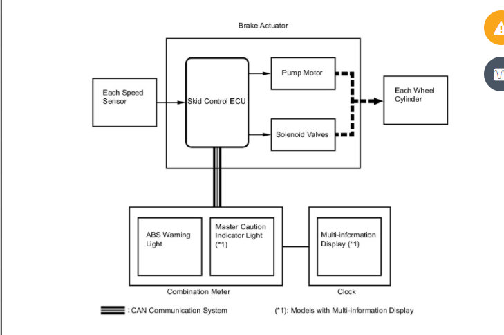

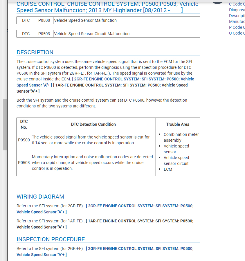

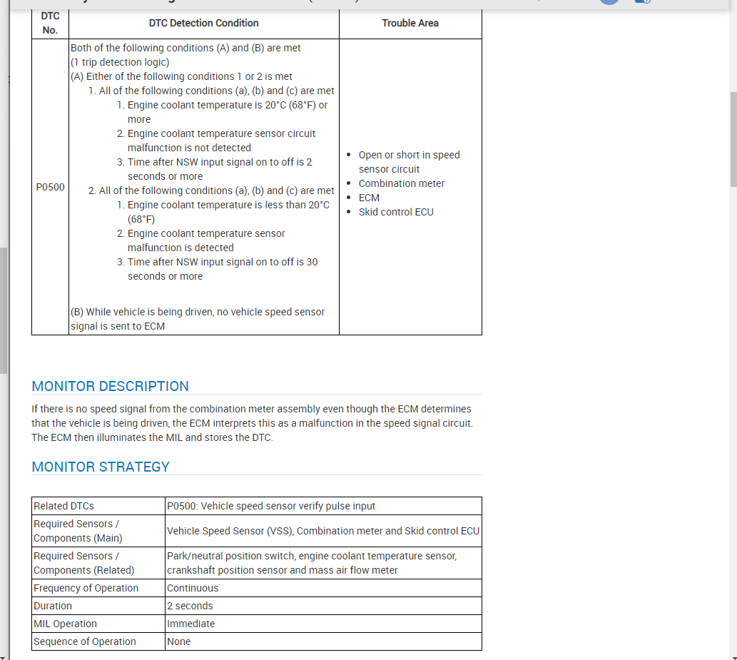

Normally that is the case with a vehicle speed sensor on older vehicles. This is a common problem on forums as it is full of people that may not have correct info.
On more modern vehicles like yours the vehicle speed sensor is not used for such things as traction control, shifting, or ABS activation like it was on older vehicles.
So they are correct that on older vehicles when a speed sensor would fail, it would cause all sorts of issues with these other systems.

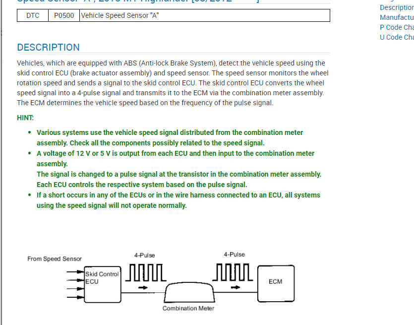

However, your vehicle is "smarter" than others and it can take the vehicle speed sensor data and compare it to the wheel speed from each wheel sensor. If it does not match then it will ignore the vehicle speed sensor for all these other functions. It will turn the check engine light on and most likely disable the cruise control.

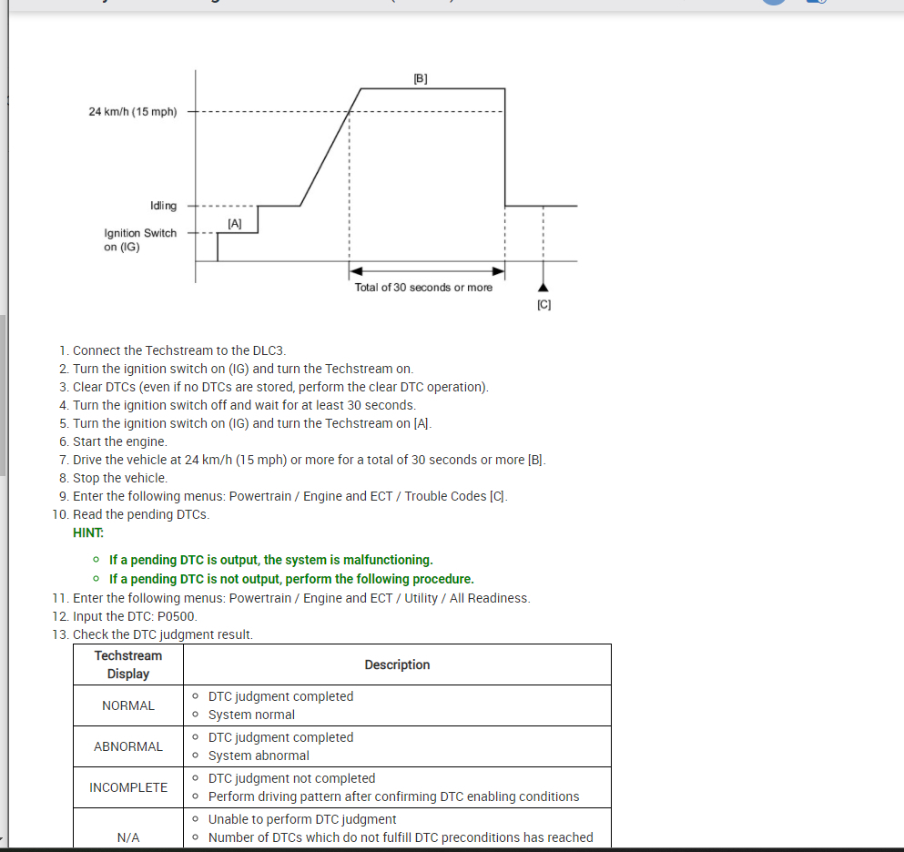

I attached some info on this but I would suggest running through all the diag for that code as it may not be the sensor. Just because the sensor was not an OEM one does not mean it is the issue. It could be but I would suggest going through the testing before spending the money on another sensor just to find out that was not the issue.

Totally understand. If the issue is that the aftermarket radio is causing it then I would unplug the radio and clear the code.
Confirm that the radio is in fact causing the code because it does not come back.
If it is then you more than likely have a connector kit or jumper to connect your aftermarket radio to the OEM harness. At that point you want to make sure the connector on the jumper side of the connection does not have a wire in the speed sensor terminal. If it does, just remove this wire from the terminal. That way it is the same effect as cutting the wire as the circuit will be open. However, the OEM harness is left intact so if you ever sell it and someone puts the OEM radio back in, this function will work again.
If there is no jumper harness, then contact the radio supplier and see if they have a work around as their radio is causing the issue.
At the very least leave a note or something telling the next owner that you did this. Just think about how you would feel if you bought a vehicle, and something wasn't working, and you found that the previous owner just cut something. Those man-made issues are the hardest to find.
However, if the code returns with the radio unplugged then you have an issue with this circuit so the testing that I attached previously is what we need to do in order to figure out the issue.
