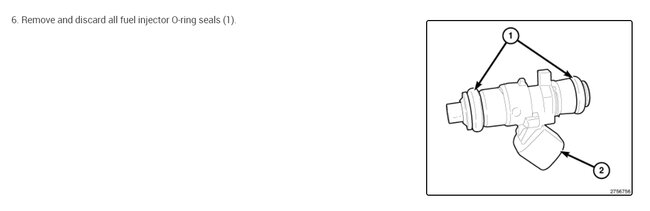

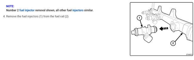

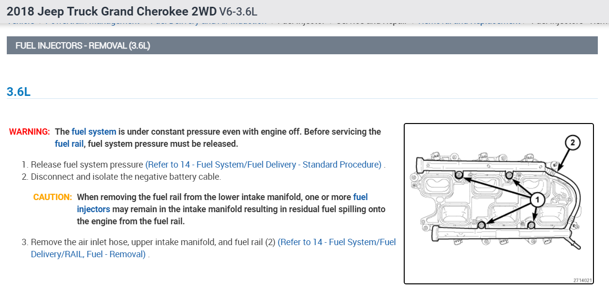

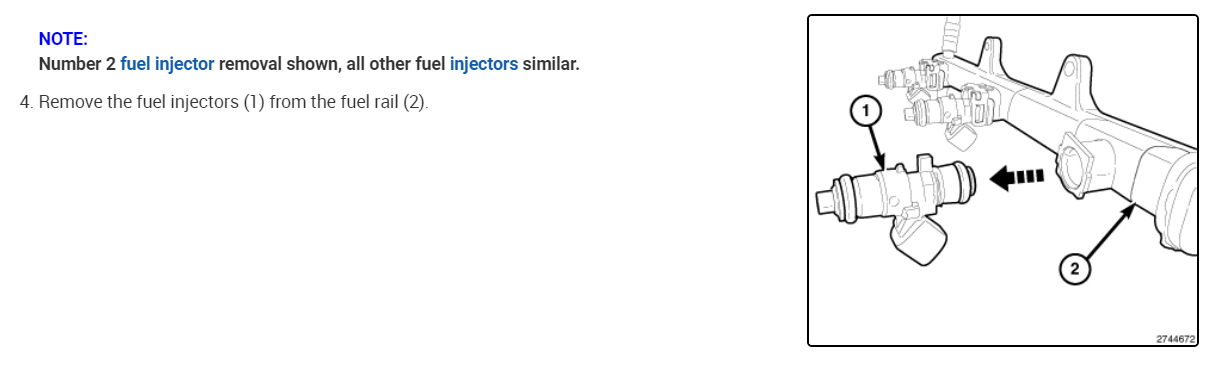

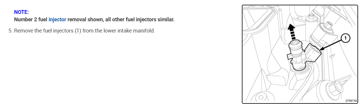

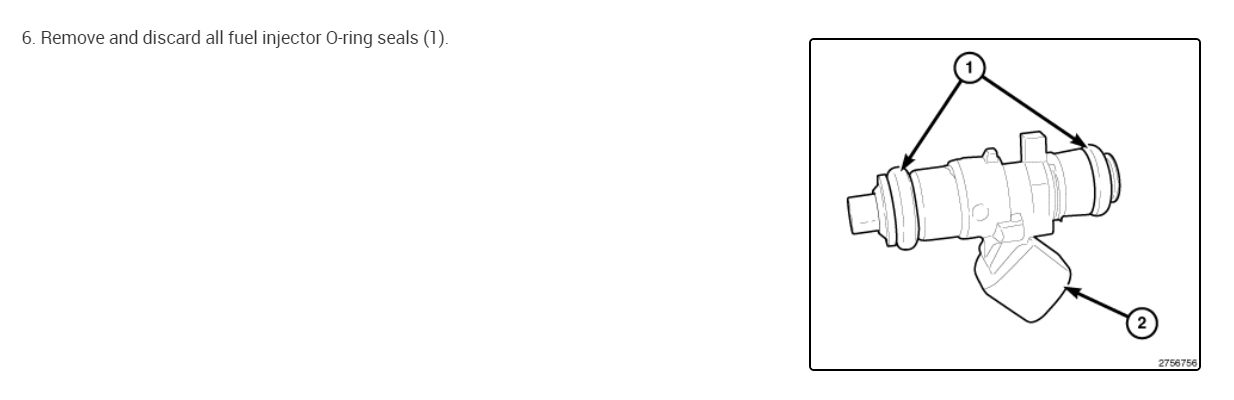

It could be the fuel injector has gone out, but we should remove the spark plug on #3 to see what it looks like, if it has very little color on it the fuel injector could be bad. Here is a guide on misfires that can be helpful, and I have included how to change the fuel injector out.
These engines had problems with the valve train, when the engine is running can you hear ticking coming from the #3 cylinder? Check out the images (below). Please let us know what you find.
