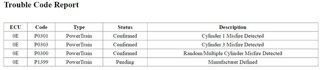

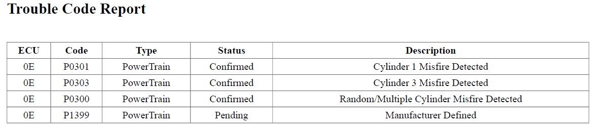

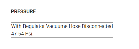

My car has been running rough recently and I thought it was having trouble shifting. It has been inconsistent. Today the check engine light started flashing. I have 3 confirmed codes and 1 pending code. The confirmed codes are P0301 [Cylinder 1 Misfire Detected], P0303 [Cylinder 3 Misfire Detected], P0300 [Random/Multiple Cylinder Misfire Detected]. I have a Pending P1399 [Manufacturer Defined] code. Where do I start?

Good evening,

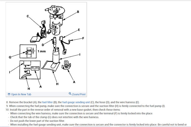

I would start with the basics. Replace the plugs and I would also check the compression to be sure the timing is correct. You should have 140-160 pounds.

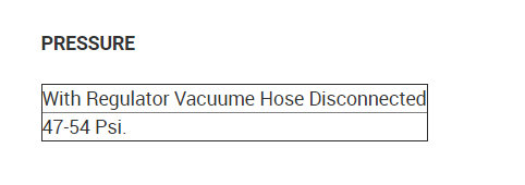

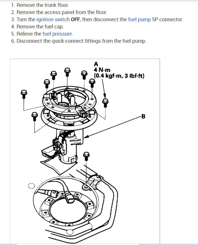

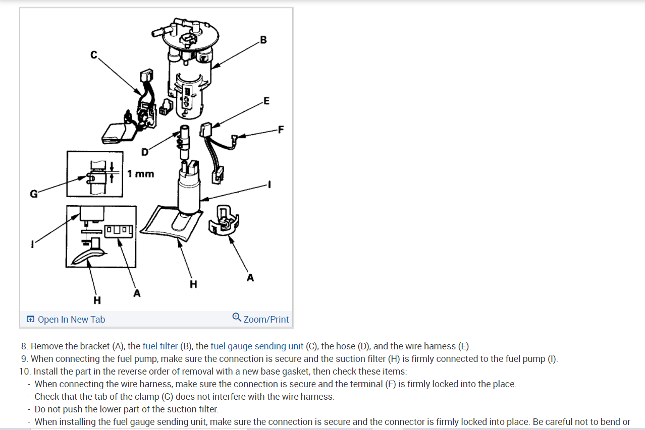

I would also check the fuel pressure low pressure from a bad fuel pump will cause these misfire codes.
