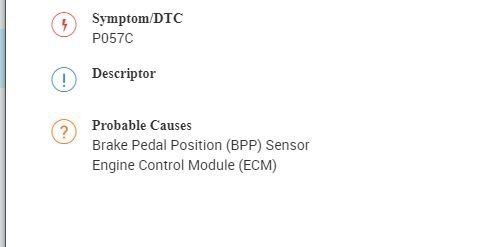

The code is p057c.
Apr 25, 2020 at 12:44 AM
Okay I attached the code description for you below. This code has nothing to do with the flashing check engine light.
You will need someone with a real scan tool to look at the history codes as I still think you have the misfire issue I listed in my previous post.
