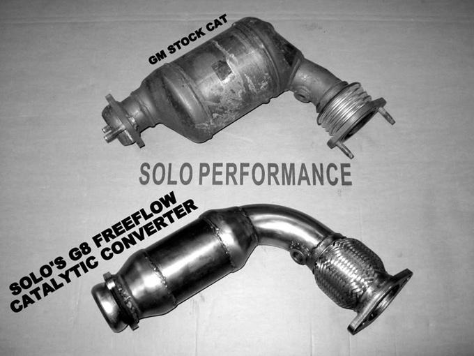

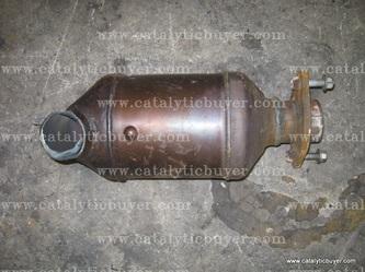

ABDULLAHZAFAR617
  • 8 POSTS
these are pretty much similar
Oct 19, 2013 at 1:51 PM
SATURNTECH9
  • 30,869 POSTS
So is the car a federal emissions car not a California car?Also which engine do you have?These are the cat's that come right off the exhaust manifolds?Unfornately the computer is set up to run with cats so it looks for the difference in o2 sensor readings from your upstream o2 sensor to your downstream o2 sensor. If it doesn't see the readings it wants it sets the cat low efficiencie.
