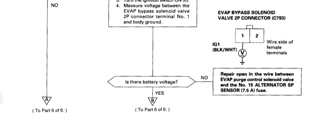

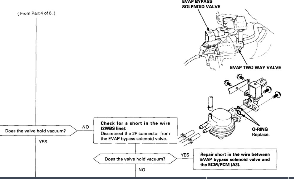

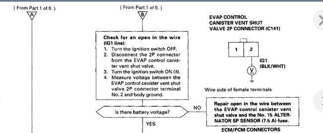

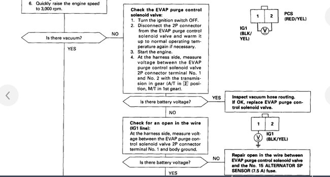

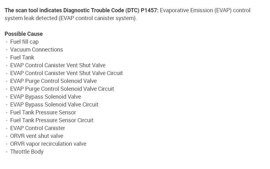

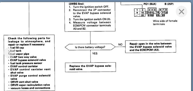

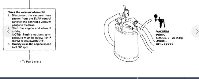

There is a code P1457 comes and tells leak near vapor canister area. I changed canister and shut off valve but two days check engine light was off but third day it came again and still tells the same code. I don't know that I have to change EVAP line or what I have to do.

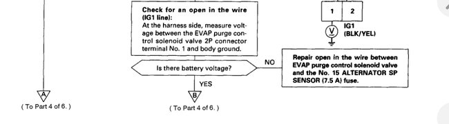

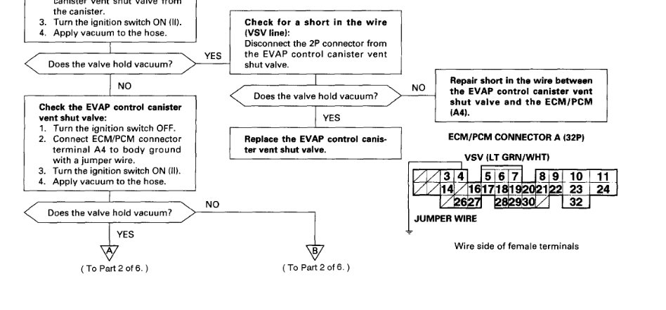

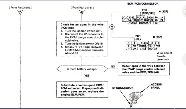

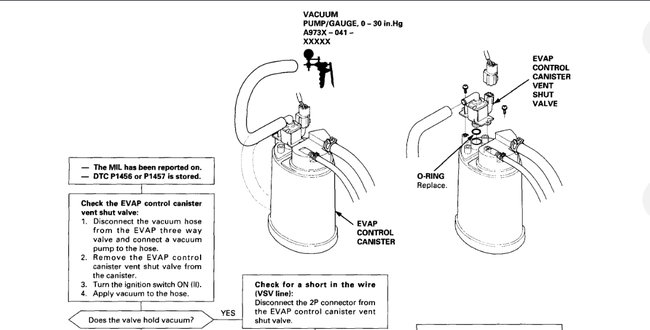

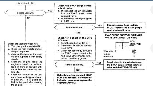

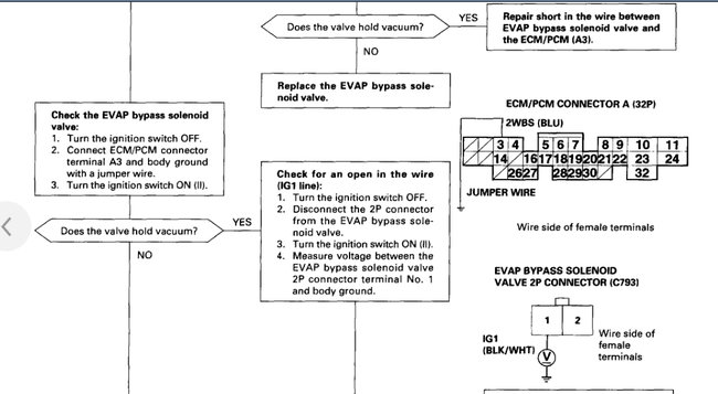

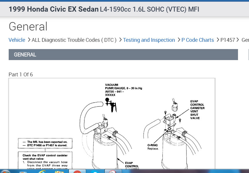

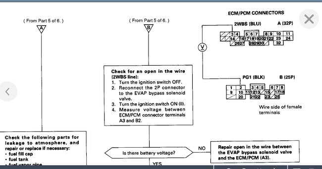

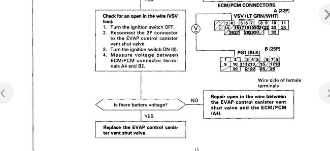

I have included in the diagrams down below all the information that Honda of North America has provided for tracking down your vehicle's problem that is causing Direct Trouble Code (DTC) 1457 to set. Included are a list of all the possible causes and a diagnostic troubleshooting flowchart that will pin down the culprit causing this DTC. Please go through this guide and get back to us with what you are able to find out.
Thanks,
Alex
2CarPros

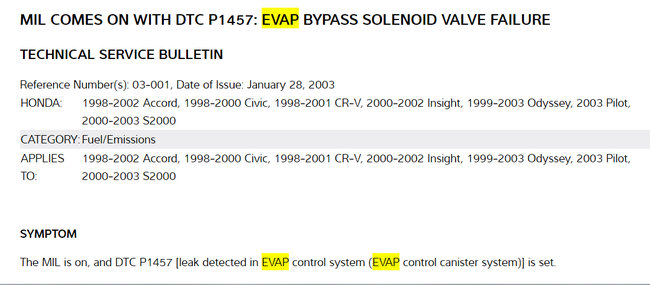

Can you tell that there is EVAP line in this car 1999 Honda civic lx 4 door 1.6L. Can you tell the part number of EVAP line and the name of the store where I can buy.

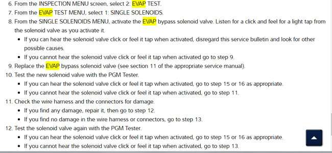

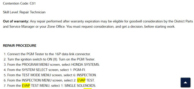

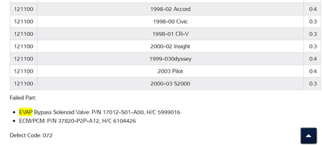

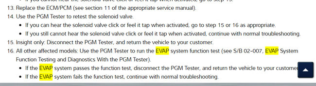

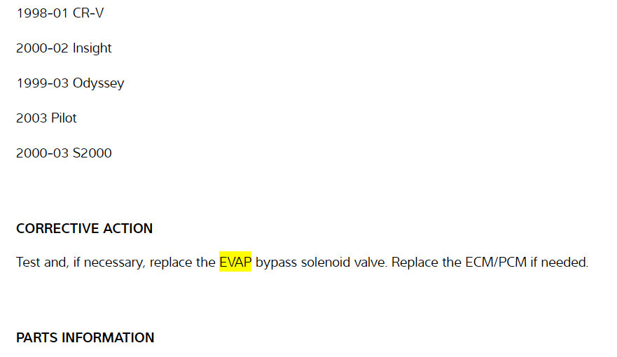

SCGRANTURISMO
  • 4,897 POSTS

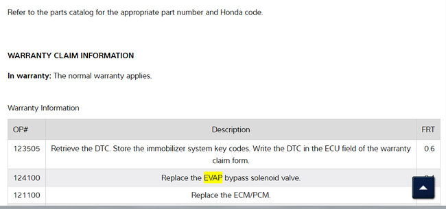

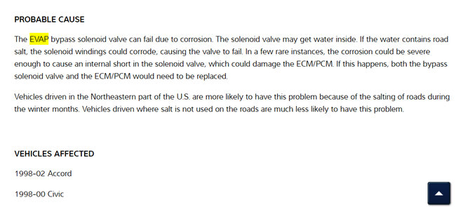

Hello again,
I'm sorry, I didn't see this the first time I answered your question. In the diagrams down below I have included a Technical Service Bulletin for your vehicle about this DTC. Although the warranty period has elapsed, it does state that the Service Manager can give you Goodwill Consideration for free repair work, and that decision can be made before any work is to be done. You might want to call your local dealership and talk to the Service Manager. There's a good possibility that you can get this repaired for free. Get back to us with what you are able to find out, please.
Thanks,
Alex
2CarPros
