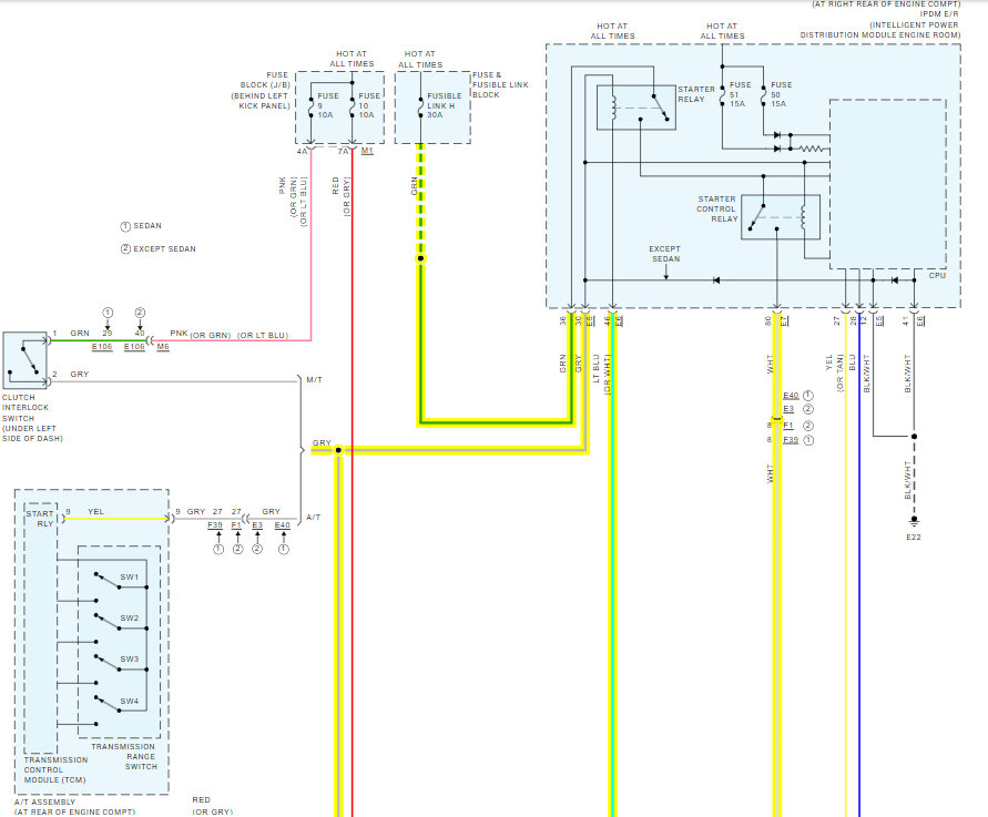

Code P0615, check engine light on?
2010 INFINITI G37
200,000 MILES • 3.7L • V6 • 2WD • AUTOMATIC
JWARD47
  • 6 POSTS
2010 Infiniti G37 X 3.7L 3696CC V6 FI VIN: VQ37VHR
Vin No: JN1CV6ARXAM453165.
It has a check engine light on dashboard, P0615: Starter, Module type: Transmission, I have no problem starting the engine. I had O’Reilly Auto run a general diagnostic and check the battery, alternator, and starter. They said that each one checked good, except the battery was a little low. I was thinking about change the starter relay but unable to locate it, but since it is starting good I not know if it would help any by replacing it.
I would appreciate any help you can give me on resolving this issue..

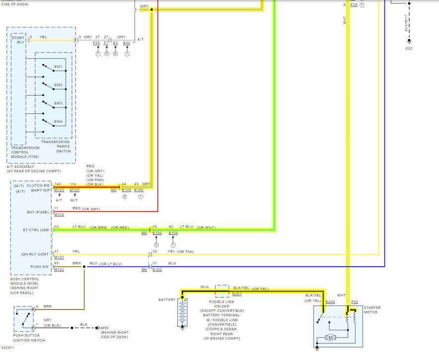

Please note, P0615 stands for "STARTER RELAY CIRCUIT" which is general yet more specific than just the starter. What flags this code is when the starter monitor system is OFF when the ignition is turned ON while the car is in Park or Neutral. This is an electrical diagnosis and I will be happy to walk you through this if you'd like. I will paste the diagnostic instructions below and an electrical diagram of the relay circuit. It could certainly be possible that the relay may have something to do with it, but we don't know for sure.
Diagnosis Procedure
1.CHECK STARTER RELAY SIGNAL
1. Turn ignition switch ON.
2. Check voltage between IPDM E/R connector terminal and ground.
Is the inspection result normal?
YES - Check starter relay circuit. Refer to See: Starting System > Electrical.
NO - GO TO 2.
2. CHECK HARNESS BETWEEN A/T ASSEMBLY AND IPDM E/R (PART 1)
1. Turn ignition switch OFF.
2. Disconnect A/T assembly connector and IPDM E/R connector.
3. Check continuity between A/T assembly vehicle side harness connector terminal and IPDM E/R vehicle side harness connector terminal.
YES - GO TO 3.
NO - Repair or replace damaged parts.
3.CHECK HARNESS BETWEEN A/T ASSEMBLY AND IPDM E/R (PART 2)
Check continuity between A/T assembly vehicle side harness connector terminal and ground.
YES - GO TO 4.
4.CHECK INTERMITTENT INCIDENT
Refer to See: Vehicle > Initial Inspection and Diagnostic Overview > Intermittent Incident.
YES - Replace A/T assembly. See: Automatic Transmission/Transaxle > Removal and Replacement > Exploded View

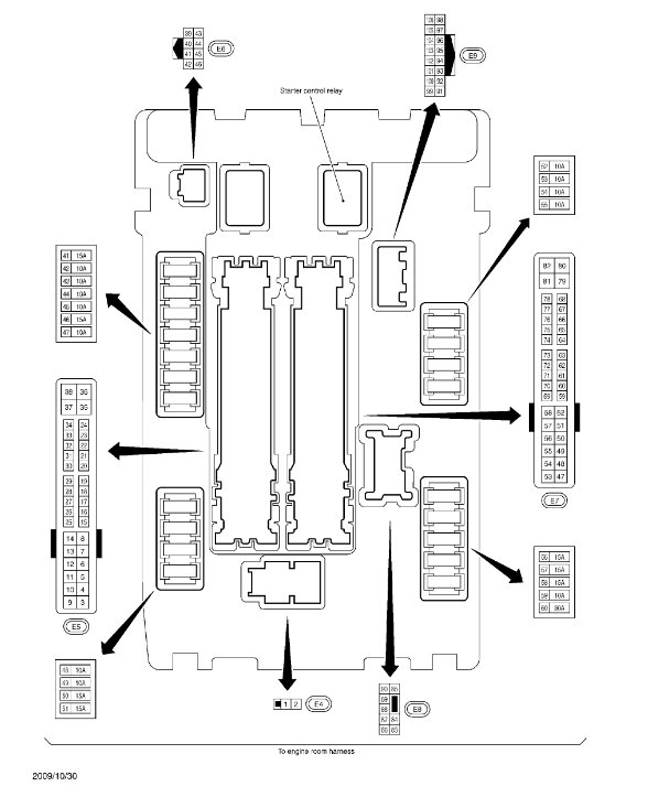

Note that the starter relay is in the IPDM box, which is located in the right rear section of the engine bay. Some of the relays in this section are internal to the IPDM, so be careful during your testing. Let me know if I can help any further.

On the images the harness shown in color and goes to a connector terminal's letter and number. To be assured that I'm checking the correct harness wire could you indicate in steps 1, 2, and 3. I what to make sure I'm doing it correctly. Thank you so much.

No problem. However, the diagram above is for the starting circuit. The procedure will begin with checking Terminal 30 of connector E5 of the IPDM, make sure you get battery voltage (12.6v) when the transmission is in Park or Neutral, and 0 volts in any other gear.
If it is normal, then we can focus on the wiring diagram I sent above. If it is not normal, then we need to keep probing wires between the transmission and the IPDM because the TCM plays a part in starting the vehicle.
