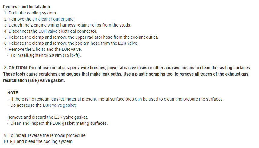

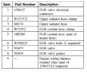

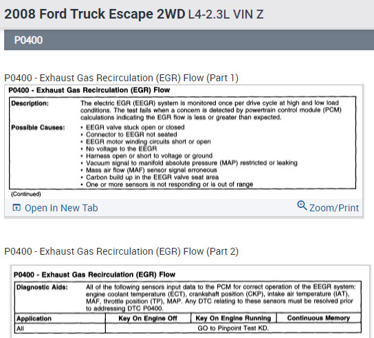

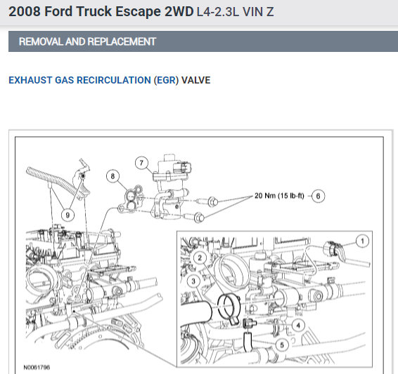

The code is P0400 which is the EGR. It is an electronic EGR and not the vacuum type. I had the same problem last year and I removed the EGR, very easy on my Escape, Gave it a good cleaning and lasted about 9 months. I'll probably try the cleaning again but order one to replace it if the cleaning doesn't work this time.
Aug 23, 2021 at 12:09 PM
DANNY L
  • 5,648 POSTS
Hello again.
Sounds good. I've attached picture steps below on how to remove and replace the EGR valve on your Escape but sounds like you already know how to do this. Thanks again for using 2CarPros and we hope you will use our site again in the future when needed.
