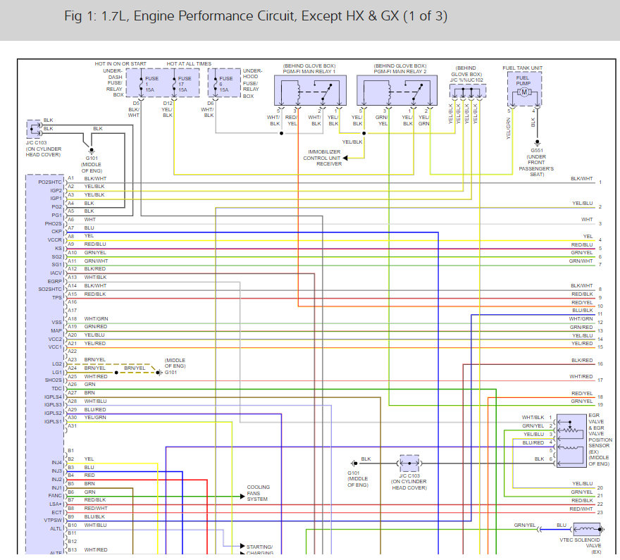

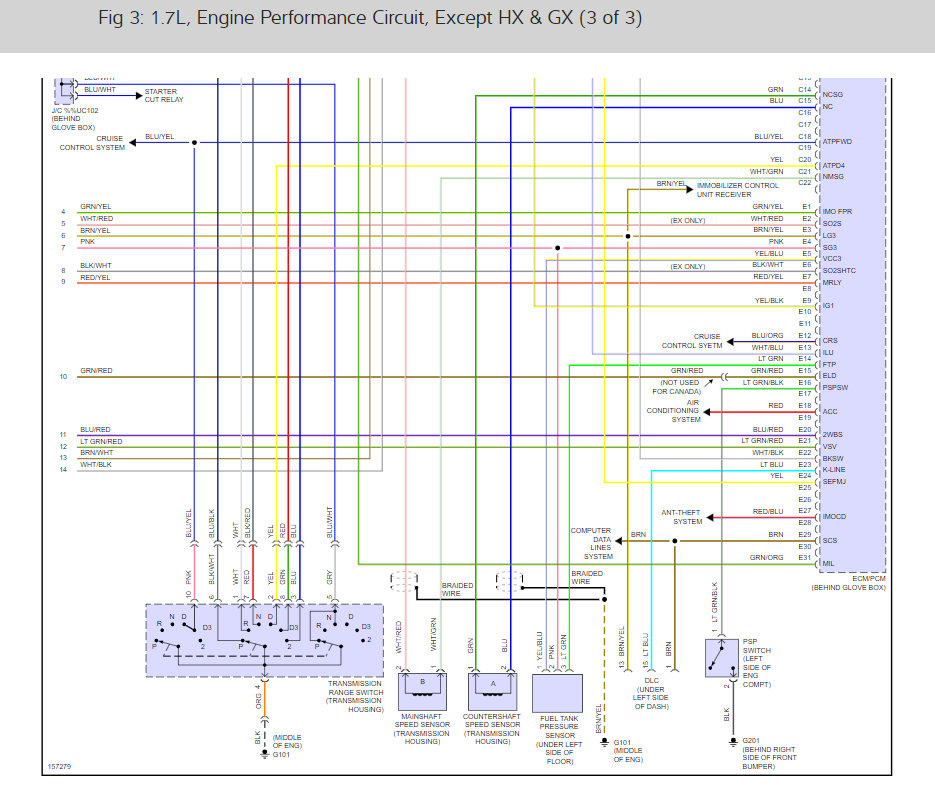

Car has no spark and no codes popping up. Changed ignition relay still no spark, but the check engine light blinks five times when I put key to on position. What could that mean?
Nov 17, 2018 at 5:31 AM
  • 55,691 POSTS

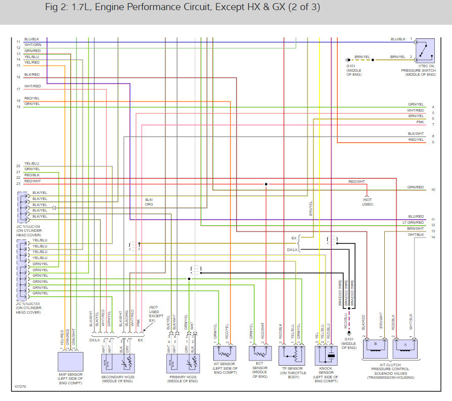

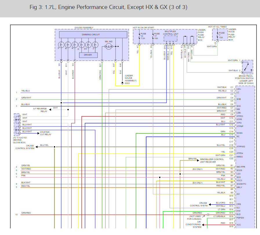

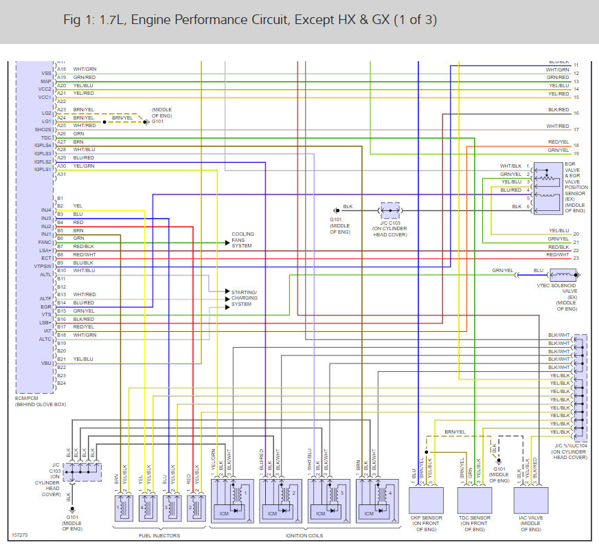

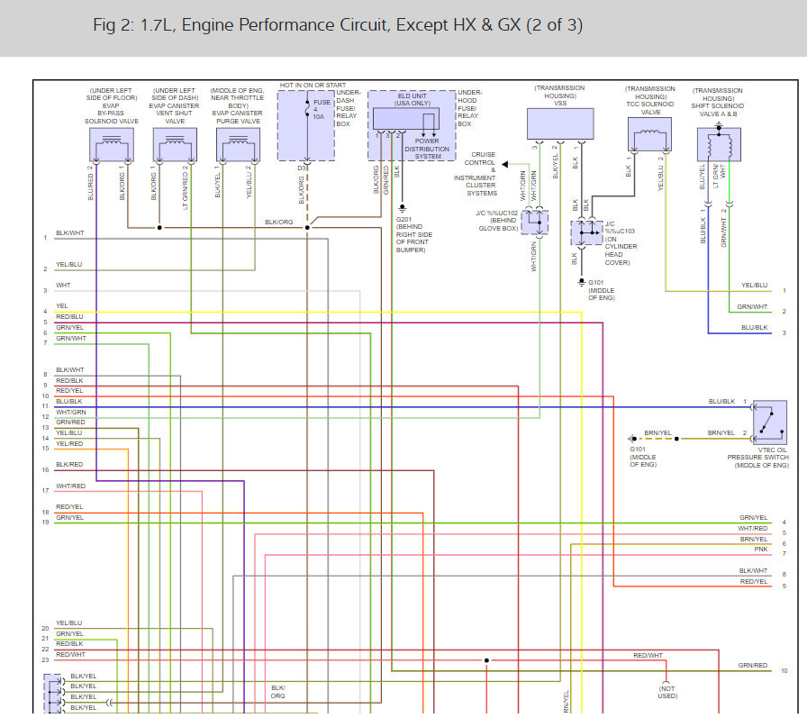

It sounds like the PCM is bad but to be sure lets make sure its getting power and grounds. Here is a guide to help you check with the engine computer wiring diagrams so you can see how the system works:

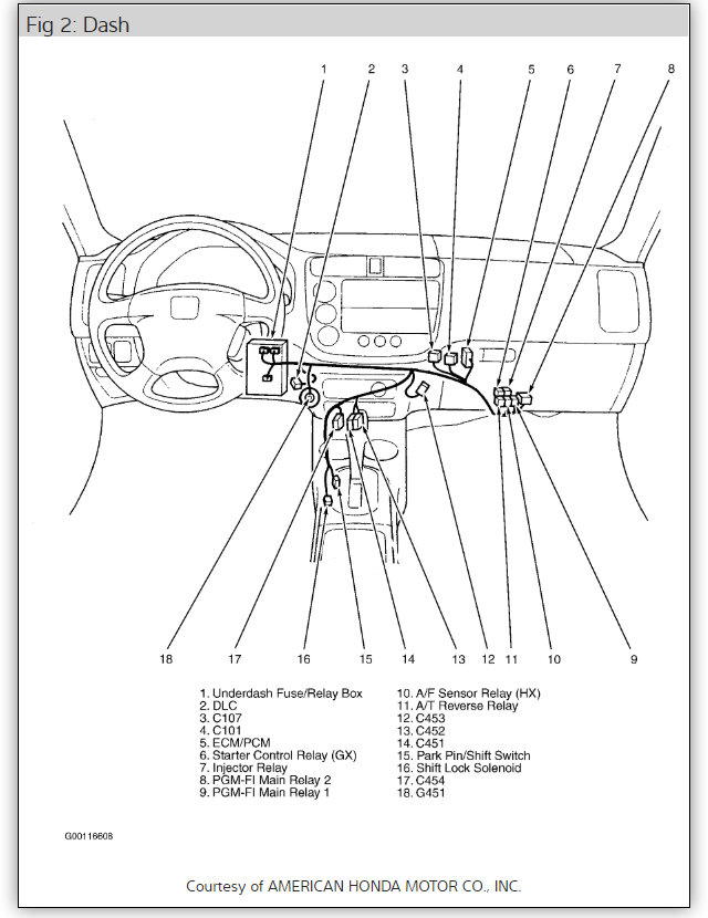

Here is the location of the PCM I would check it for water damage. Then try a used/rebuilt computer to see what happens.
