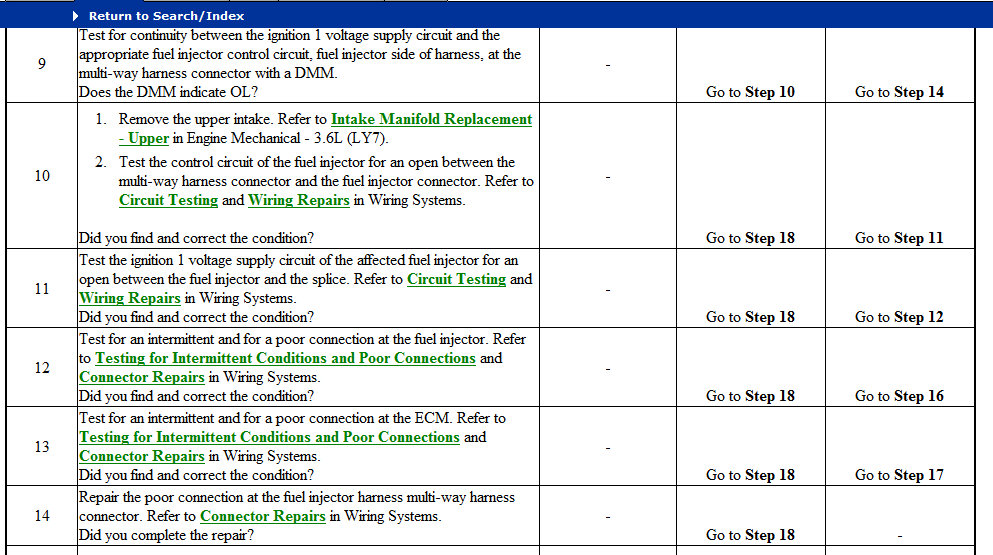

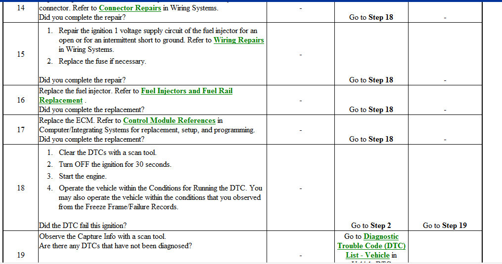

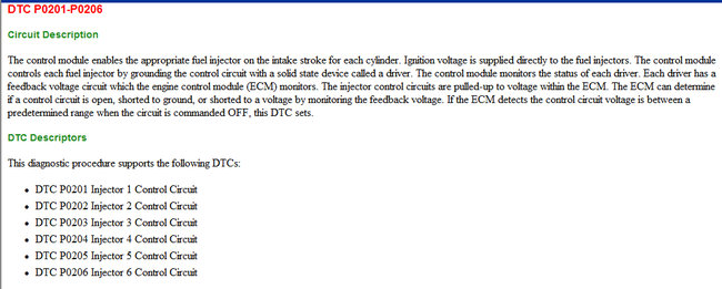

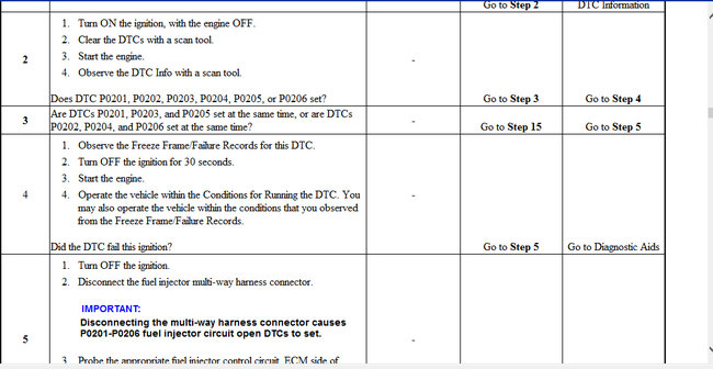

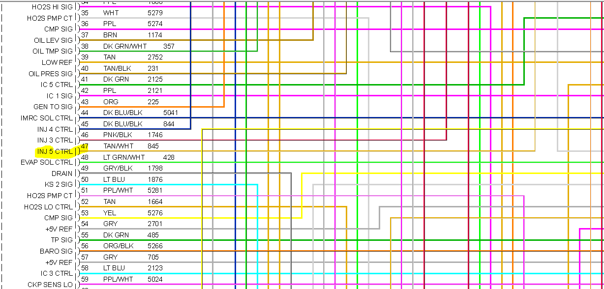

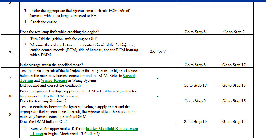

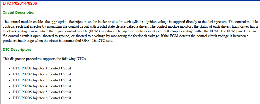

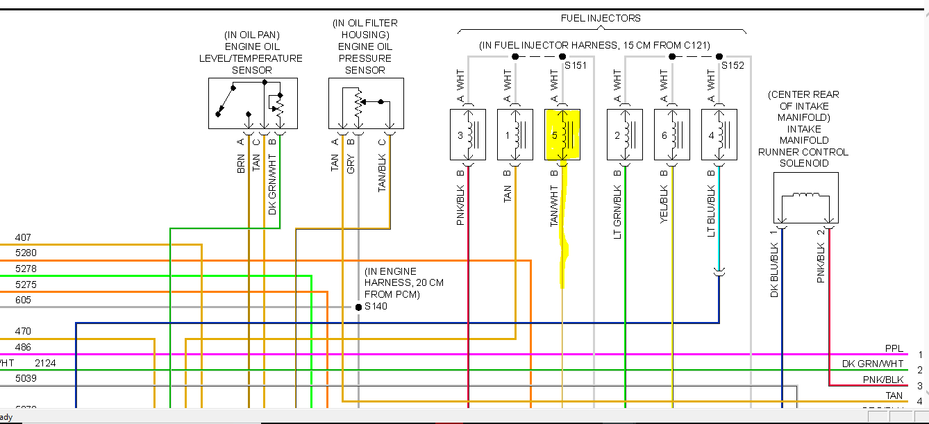

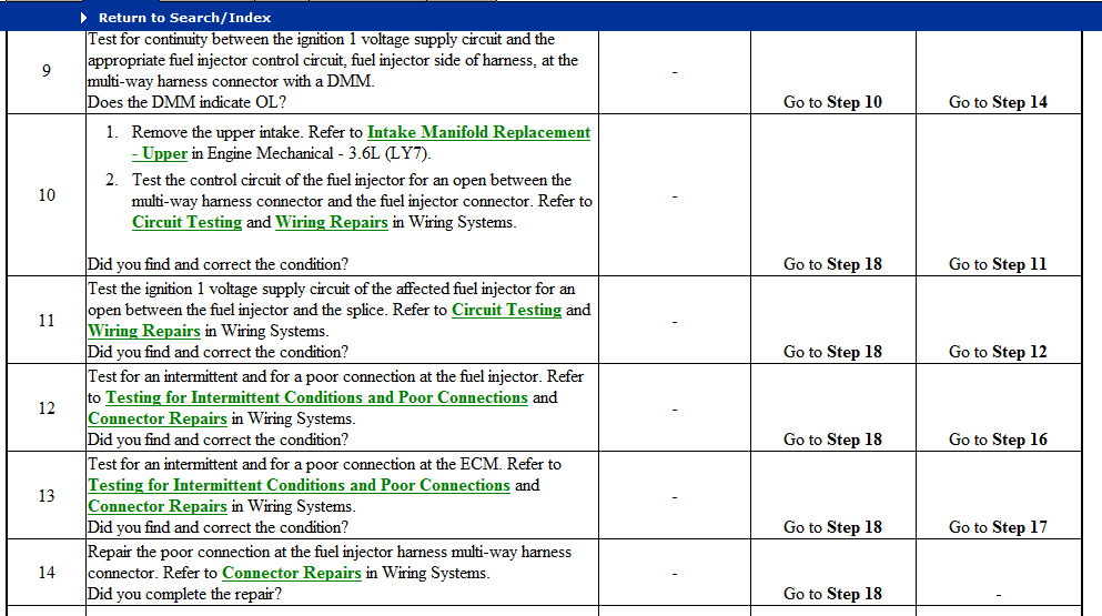

The main fault code that causes the problem is p0205 injector 5 control circuit,which causes miss fire cylinder 5 appear fault code p0305. as a first step check injector control line (fig 6) between injector pin B color tan/white and control unit connector pin 47 (fig 7)check control unit location(fig 8), check for open circuit and resistance if the wire is good,swap injector with other cylinder if the fault still the same then the injector is good problem can be from bad engine control unit.
for complete diagnosis step by step check the fig 1,2,3,4,5 for trouble shooting.
