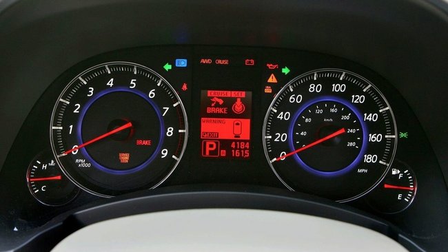

The image is not my cluster, it's just for reference.

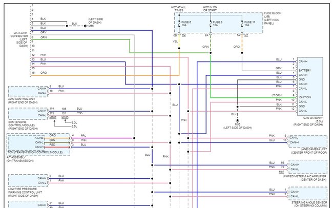

I just recently got the car listed above fx35 and noticed four lights on the cluster are missing when the ignition is in "on" position.
And they are:
1. Check engine
2. AWD
3. Cruise and
4. IBA off
With the check engine light not present, the obd2 port doesn't connect to a scanner.
I've checked fuses and found some missing and shorted and replaced them but no luck.
I need help here.

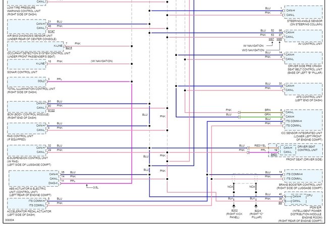

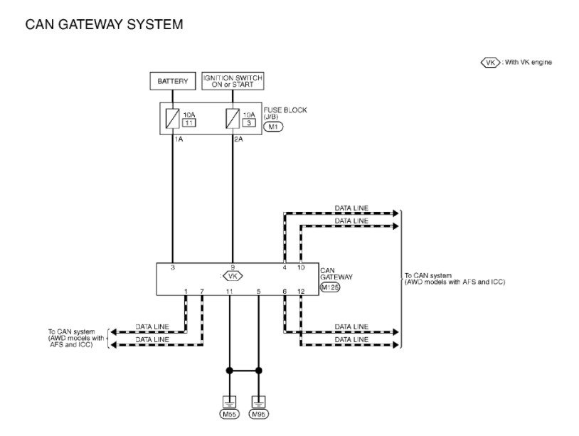

It sounds like the data link connector may not be receiving power. I've attached a few diagrams (below) so that you can see which fuses power the data link connector. The computer data lines schematic is in two parts so it should be a little easier to read.
If you locate the junction box at the left kick panel, fuse 6 (10 amp) should have power at all times. Fuse 3 (10 amp) should have power with the ignition on.
Additionally, you may find this video tutorial helpful. It discusses a few of the reasons that you may not be getting power to the OBD port:
https://youtu.be/6Tlg3JmgNSQ
This repair guide discusses how to scan a CAN system:
Please let us know what you find, and we would be happy to assist you further.
