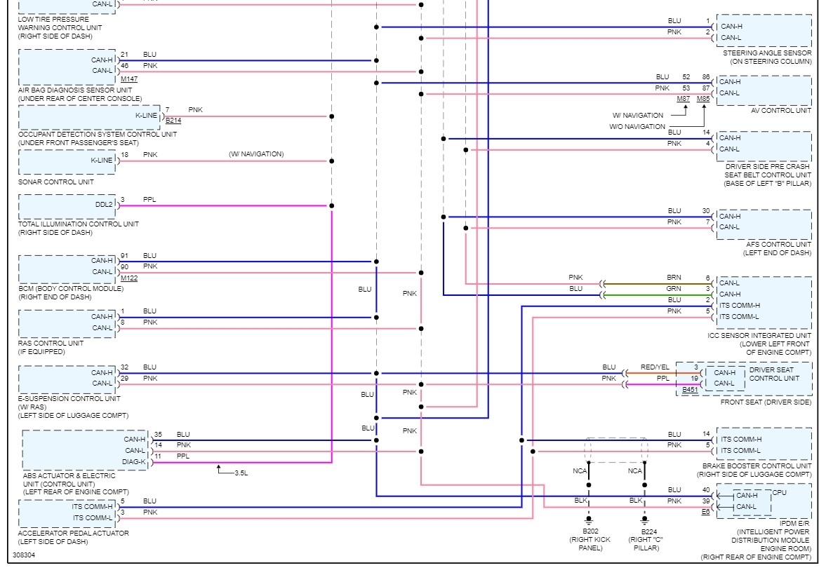

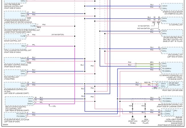

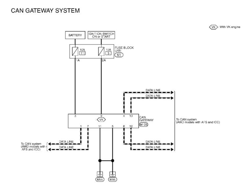

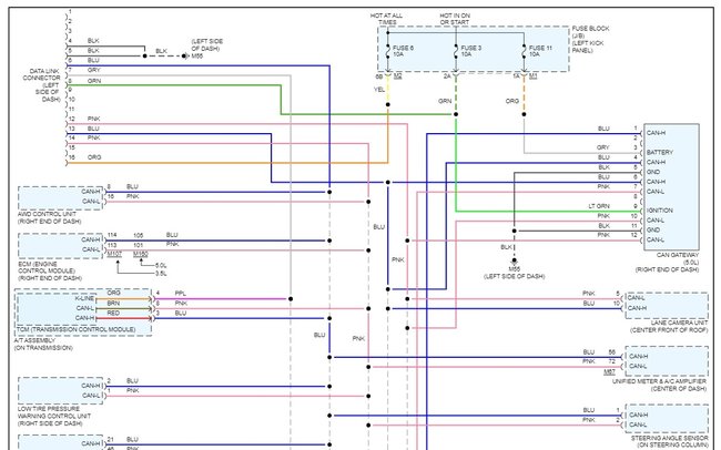

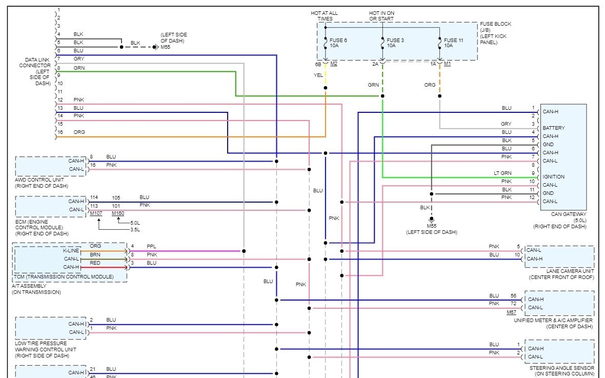

It sounds like the data link connector may not be receiving power. I've attached a few diagrams (below) so that you can see which fuses power the data link connector. The computer data lines schematic is in two parts so it should be a little easier to read.
If you locate the junction box at the left kick panel, fuse 6 (10 amp) should have power at all times. Fuse 3 (10 amp) should have power with the ignition on.
