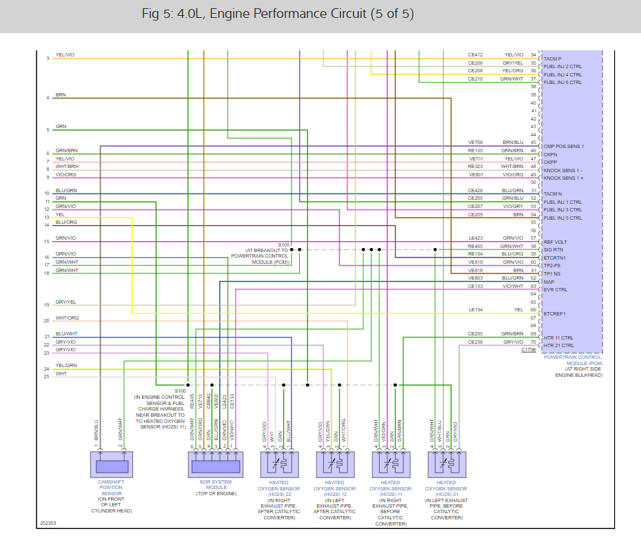

need a wiring diagram for the engine and ECU?
2007 FORD EXPLORER SPORT TRAC
200,000 MILES • 4.0L • 6 CYL • 4WD • AUTOMATIC
JOSE CORDERO

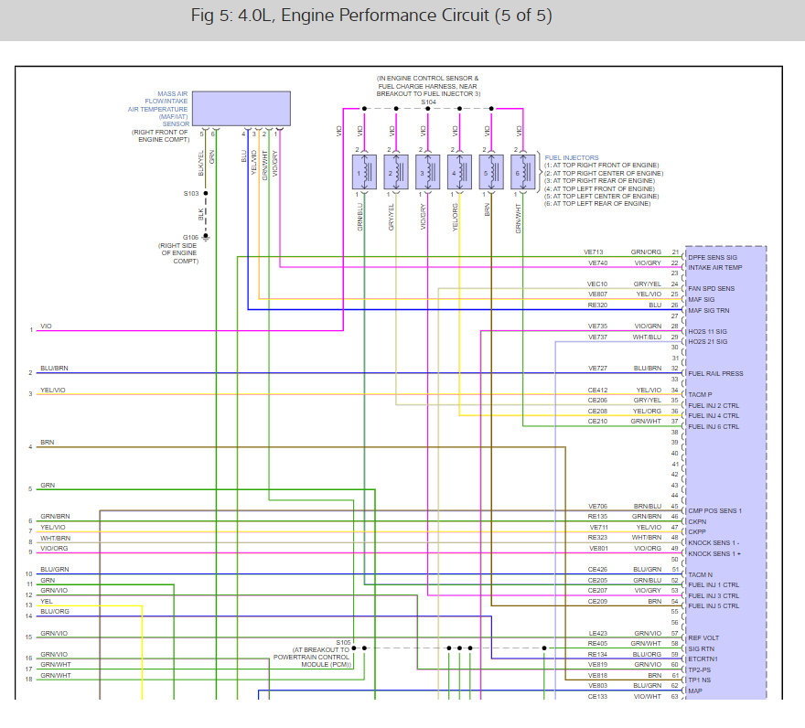

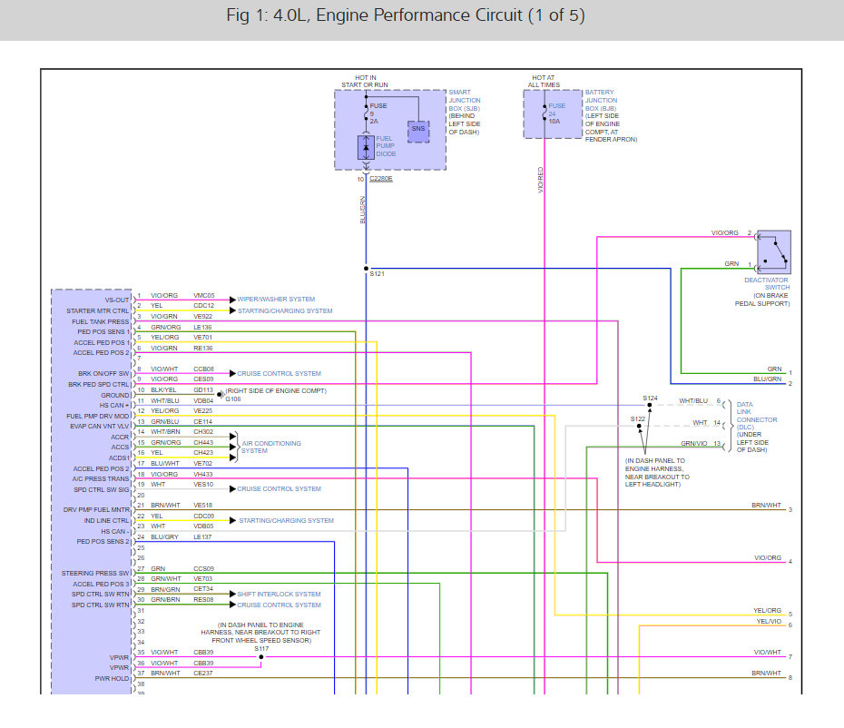

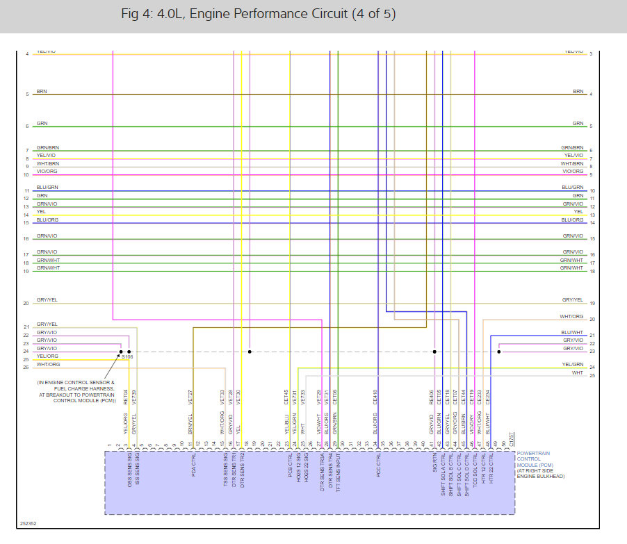

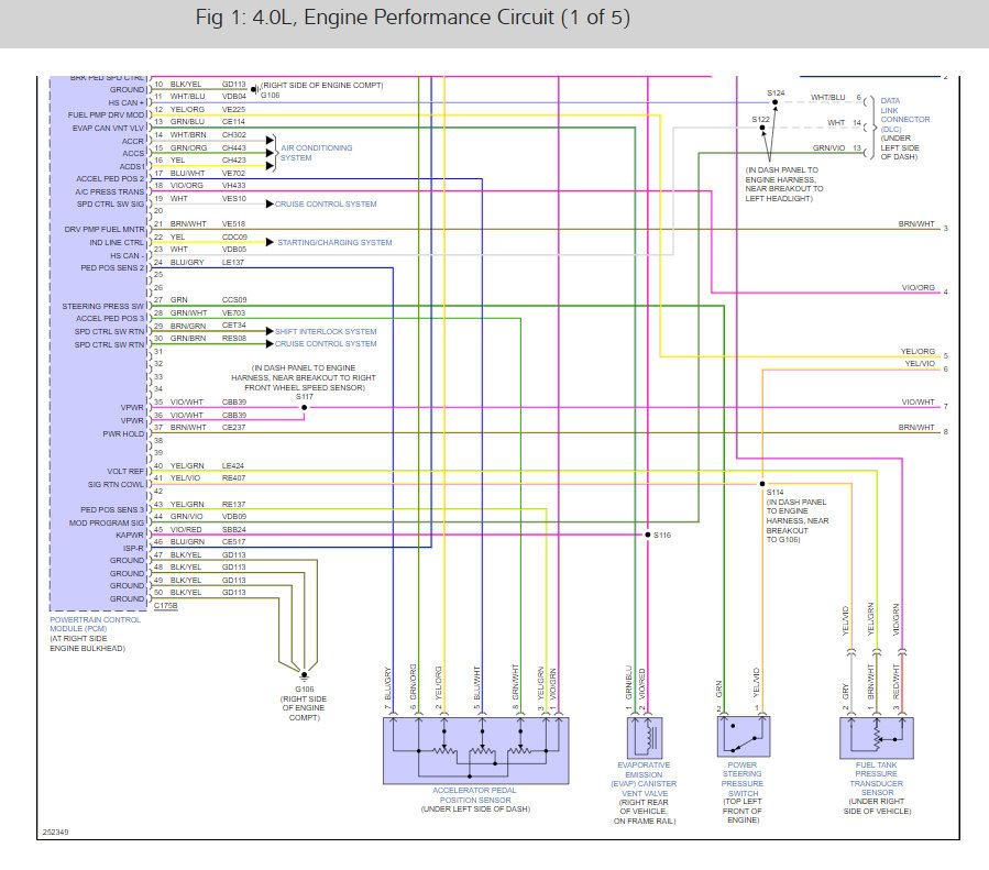

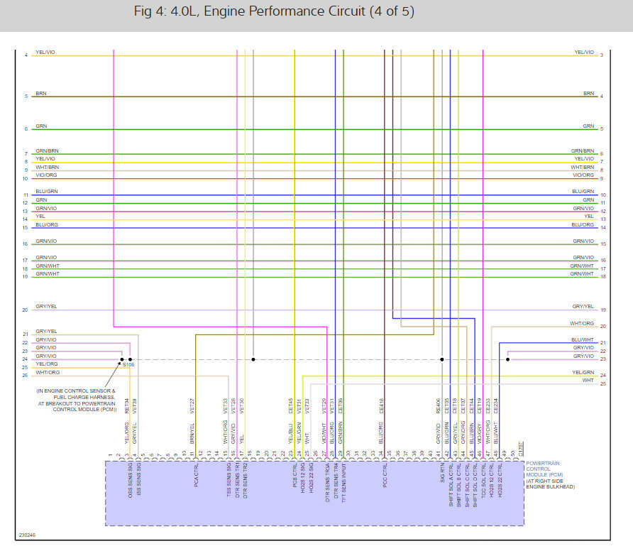

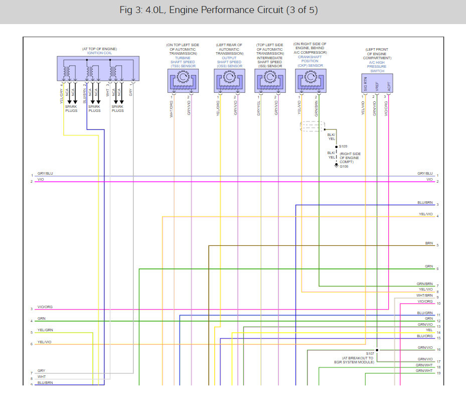

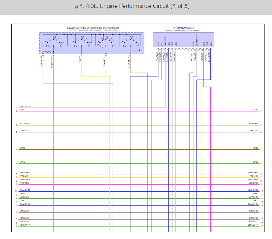

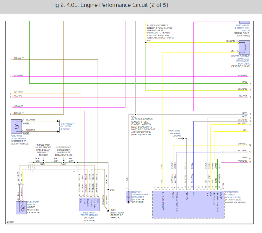

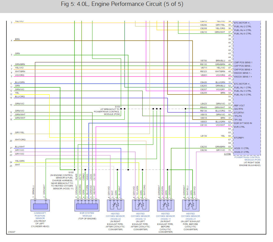

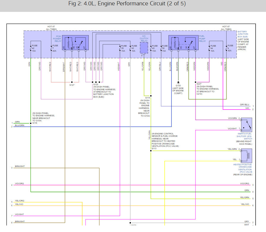

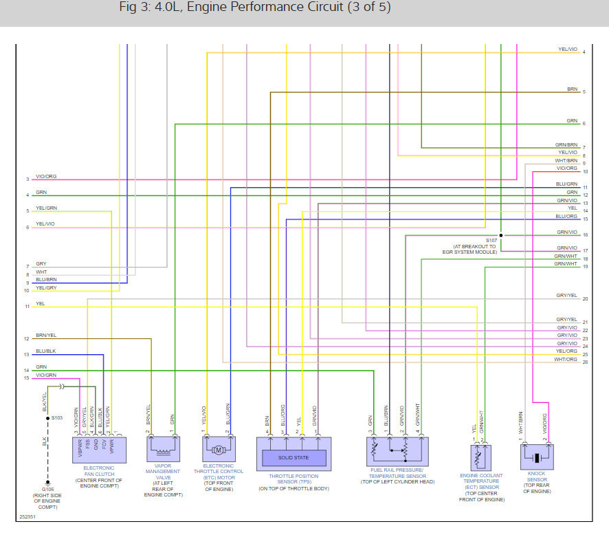

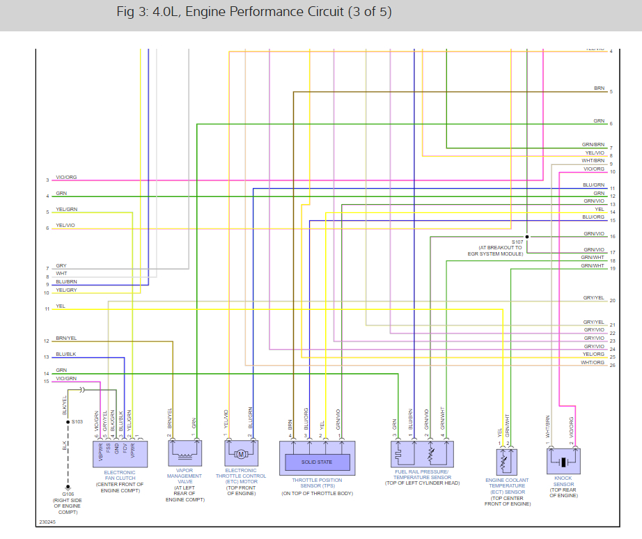

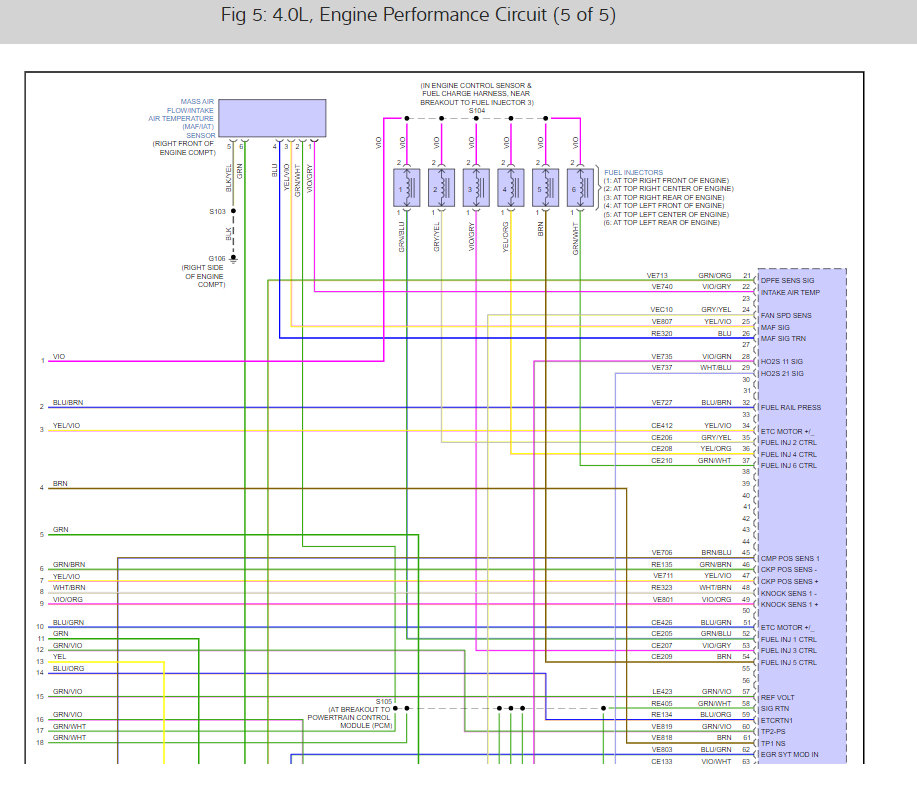

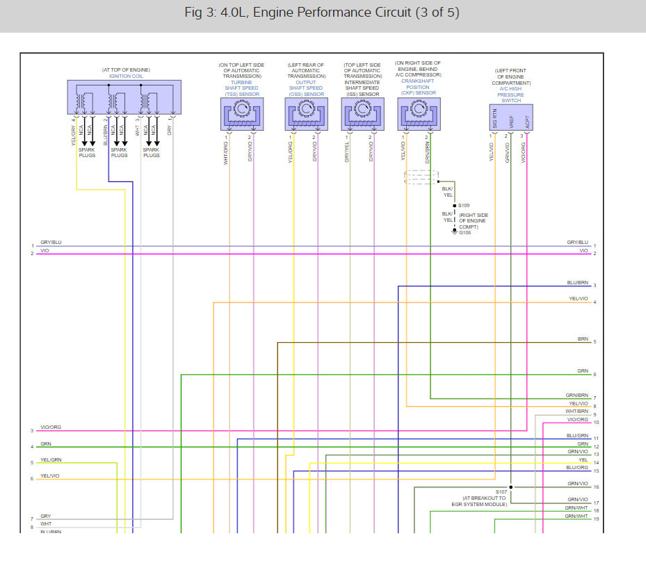

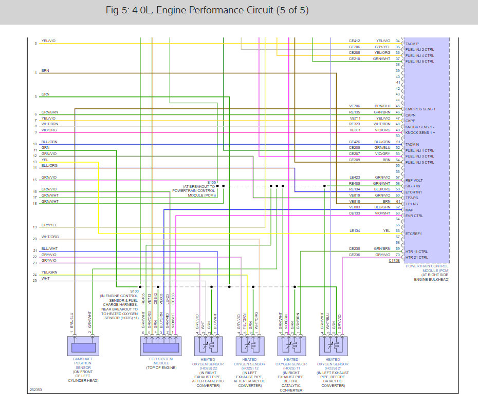

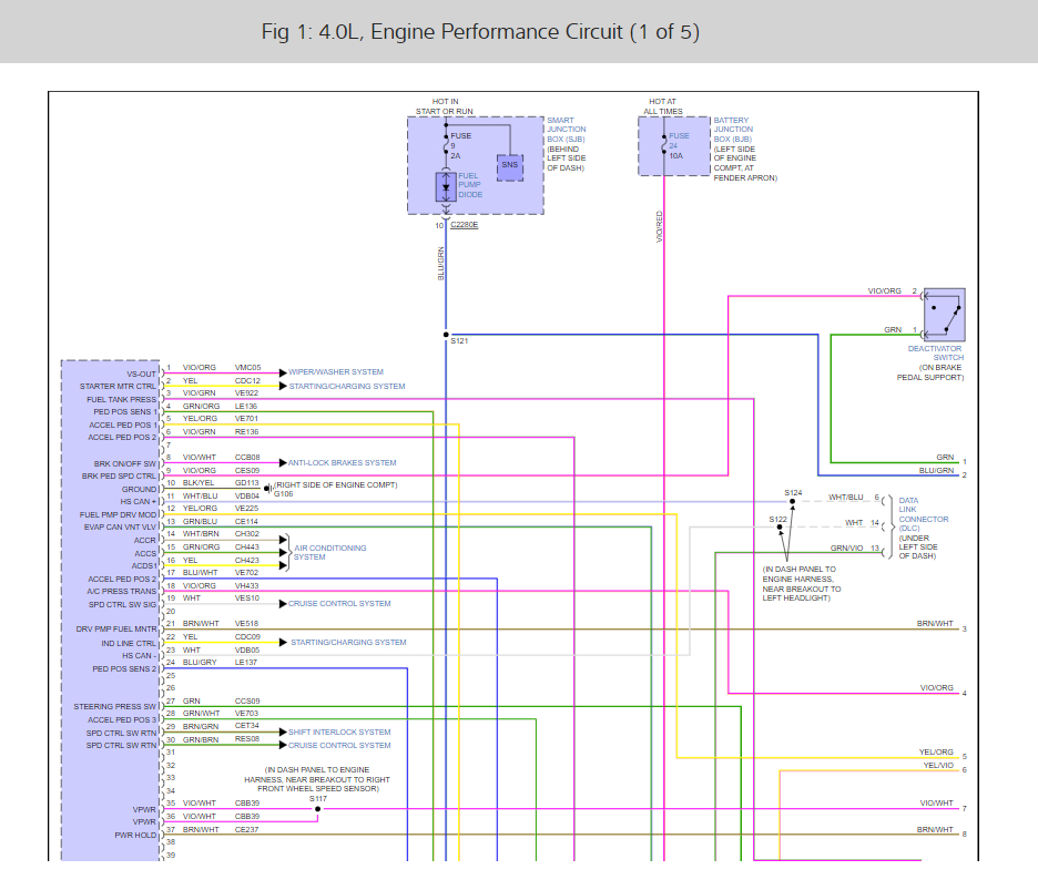

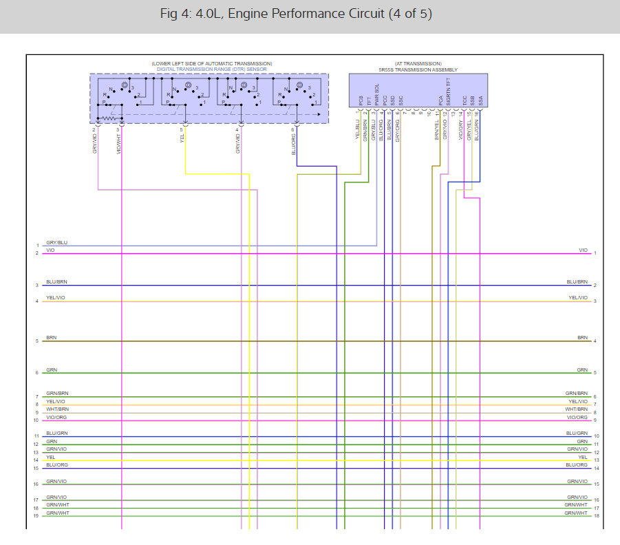

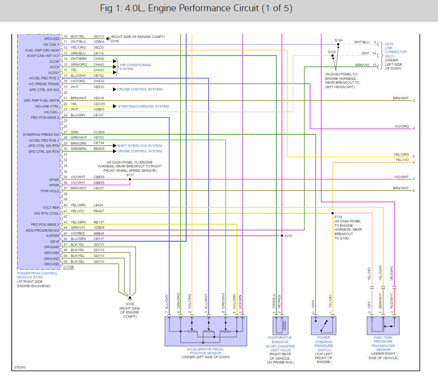

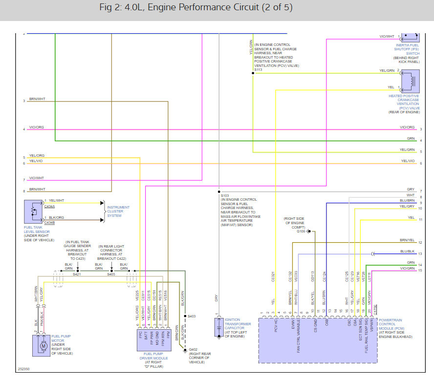

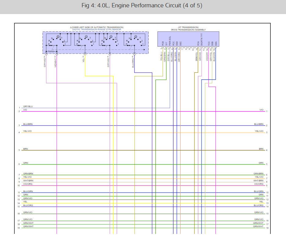

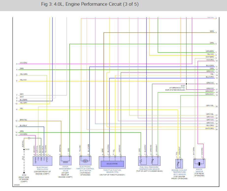

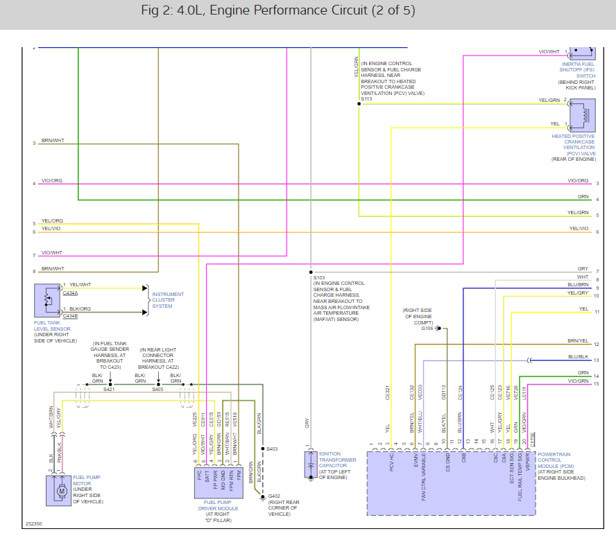

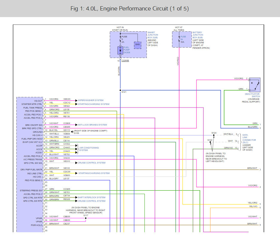

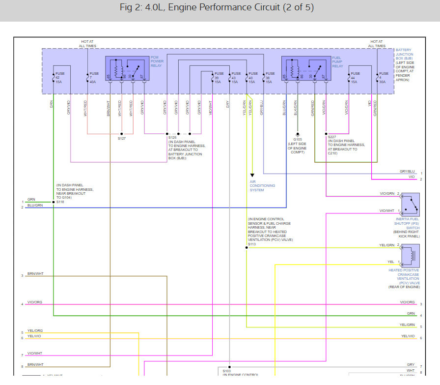

Codes p0135, p0141, p0155, p0161, p0403, and p0443. I need a wiring diagram of the engine's ECU. i pulled the ECU from this car found out the ECU came out of a 2006 Ford Explorer part no 6l2a-12a650-bbd the one for this VIN doesn't not match for 2007 Ford Explorer Trac 03/06. The right one is 6l2a-12a650-cba. I need both wiring diagrams to see if any difference. It won't pass inspection if the ECU was changed before i bought the car.
Sep 12, 2022 at 9:48 PM
  • 54,832 POSTS

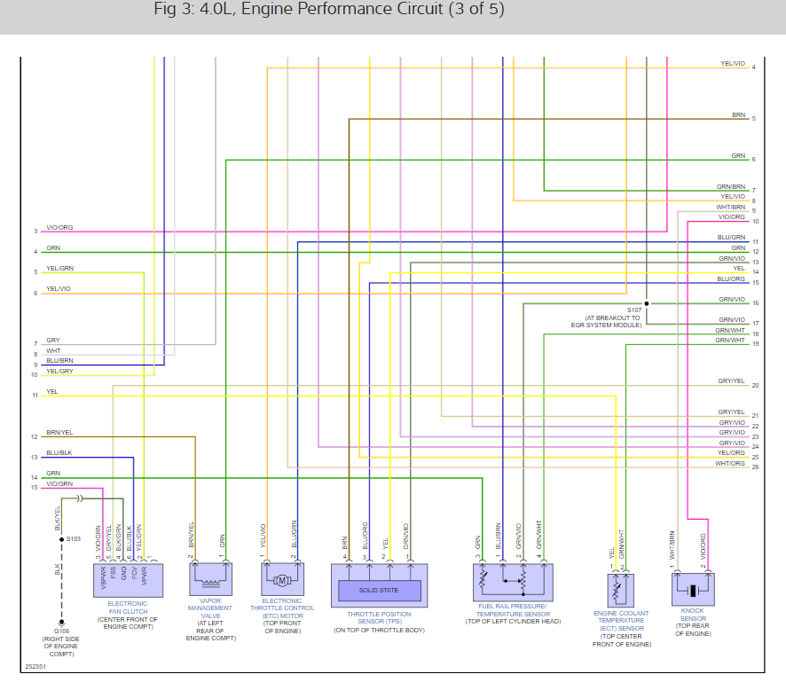

Yep, here are both the 2006 and 2007 engine and PCM wiring diagrams with a guide to help you see how to check the connections.
Check out the images (below). Please let us know what happens. The first set of engine wiring diagrams are for the 2006.
