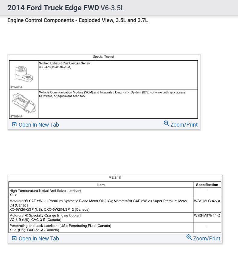

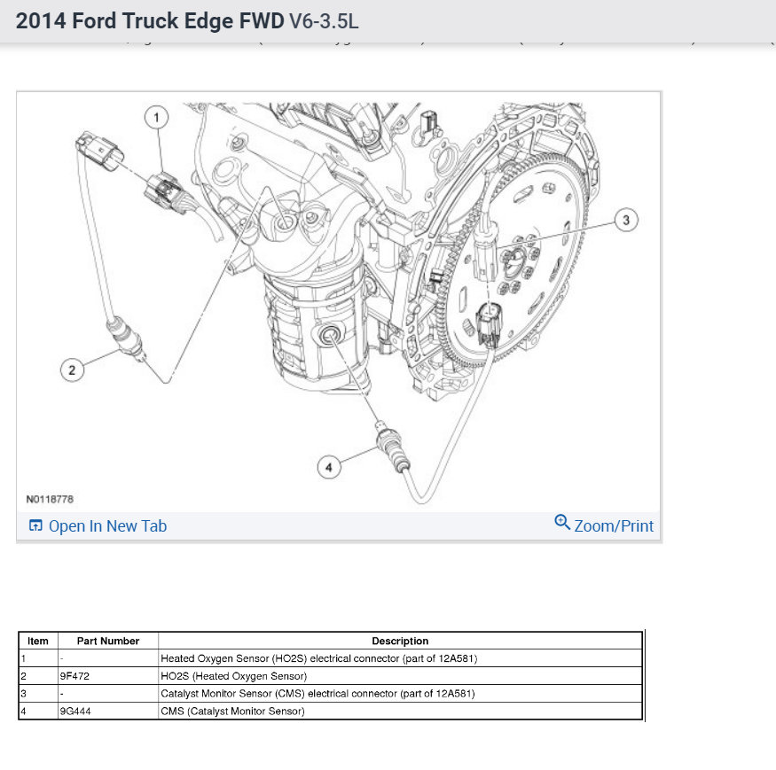

When they replaced the catalytic converters were they new from the dealer or rebuilt? If they were not new tis should be the problem, you can try to replace the oxygen sensors, but we have had little luck with that being the problem. Here is the location of the secondary or monitor sensors in the diagrams below. Check out the diagrams (below). Please let us know what happens.
