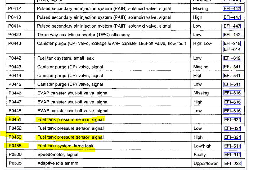

I did find some notes from one of the mechanics and this is what it said:
453, 543,451,454 and 455 - all the misfire codes. I’m going to ask them to note all codes from now on. That will be helpful.

If those are P codes, none of them are related to a misfire. I was able to find three of them and they are all related to the fuel tank pressure sensor. Take a look below. Note: P0454 and P0543 are not listed for this vehicle as a P-code, but I know 454 and 543 aren't misfire codes.
See pic below.

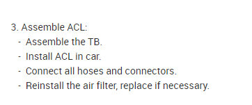

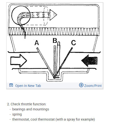

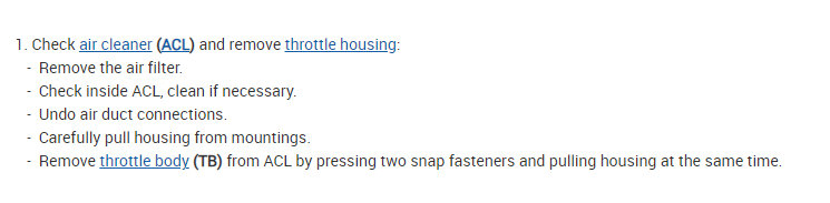

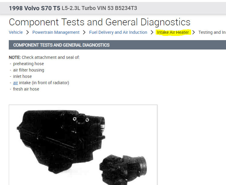

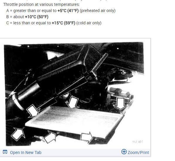

Something just clicked in my mind. The P0543 is related to an intake air heater. That could be causing issues. I attached diagnostics below. See if this is something they checked as well. I'm not sure why the code isn't listed for this vehicle, but the symptoms are there. It's a theory. See what they say.

I would need to determine the cause of the failure. It shouldn't be too expensive. Let me know if this is something they can check for you.
As far as difficulty, it should be attached to the air filter box. There is a thermostat that will pull a flap in different directions. One direction allows outside air to enter and the opposite direction allows heated air to enter.
