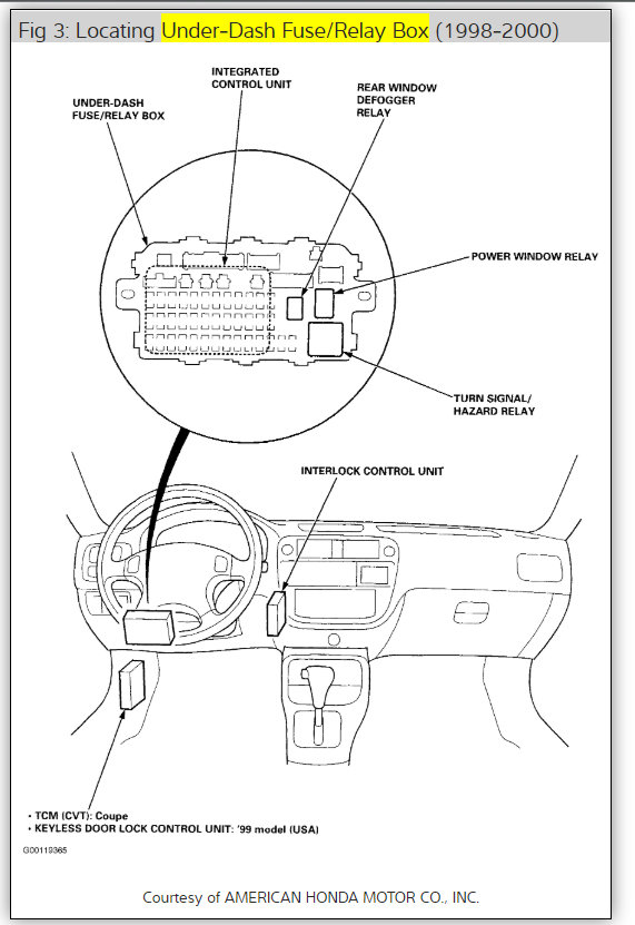

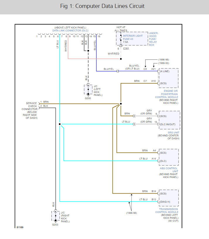

I have no check engine light never coming on at all. No codes. Bulb is new.
Dec 13, 2020 at 4:33 AM
  • 55,710 POSTS

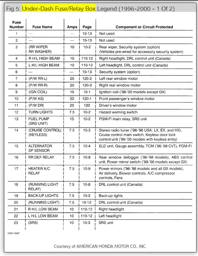

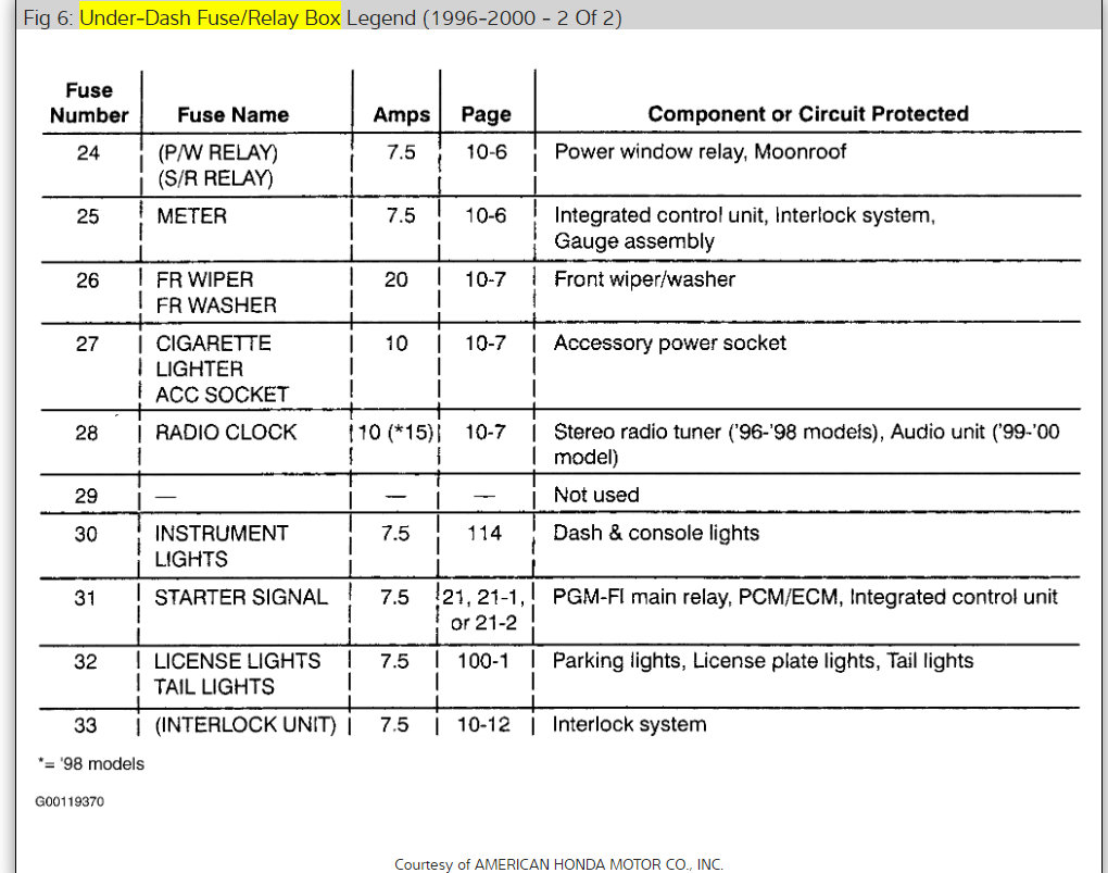

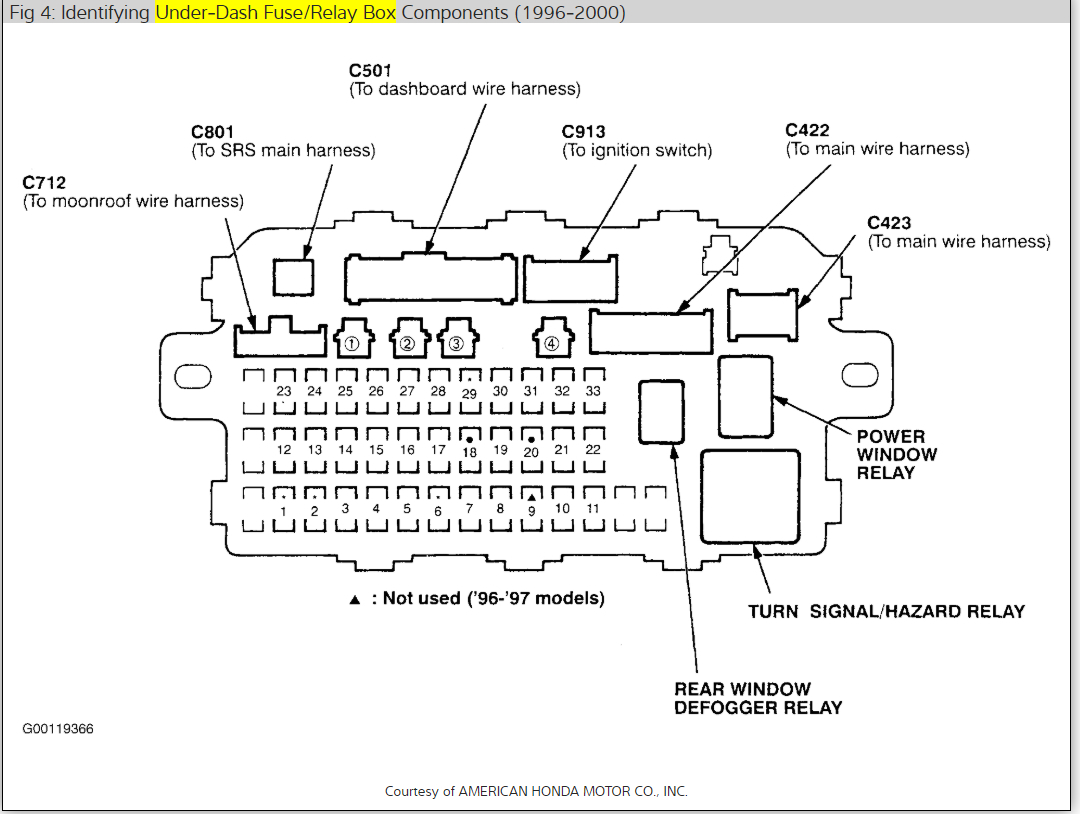

there is an interior light fuse #43 we need to check for power. this guide will help us with the check engine light ALDL wiring diagrams below so you can see how the system works along with the fuse locations as well.
