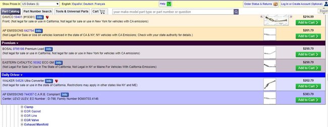

I would only use a Walker or a Bosal. They have a 5-year warranty on the light returning.
I attached them below.

I am unable to locate that pricing. Where did you obtain?
Monday, December 9th, 2019 AT 12:55 PM
  • 52,797 POSTS
Rock auto. Go to rockauto. Com.

What is the difference between the Walker and Bosal?
Monday, December 9th, 2019 AT 1:34 PM
  • 52,797 POSTS
Walker is the top brand and that is what I use unless there is no one available, I will use Bosal.
They both are the only ones who will offer a 5-year warranty on the light.
