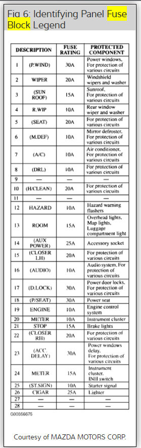

The car that I was replacing the sensor on suddenly the check engine light will not come on at all now and caused a fail at e Check today. It was working fine yesterday and all I did was replace a sensor. What happened now? Thanks

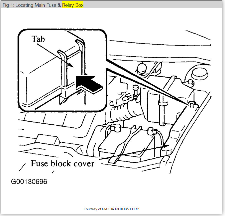

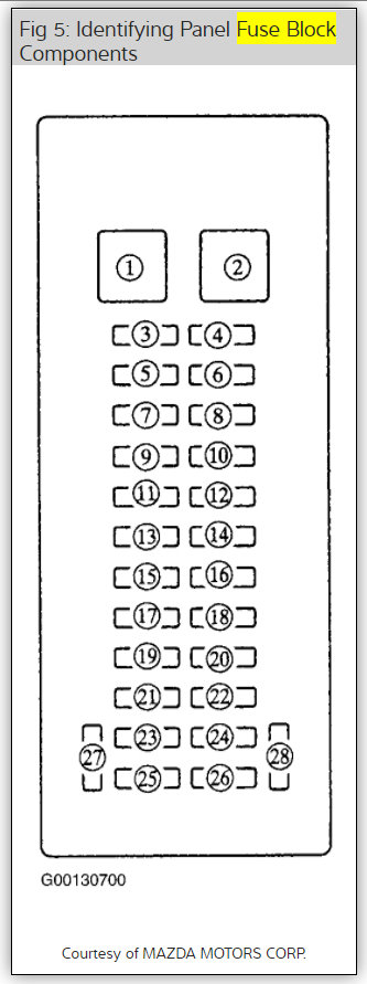

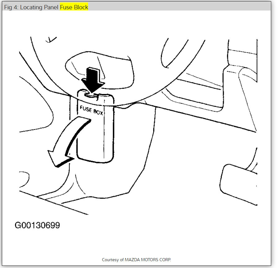

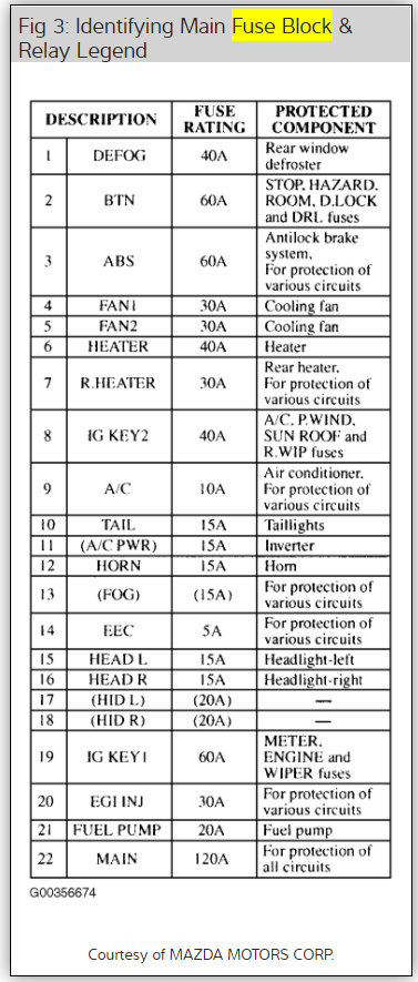

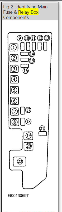

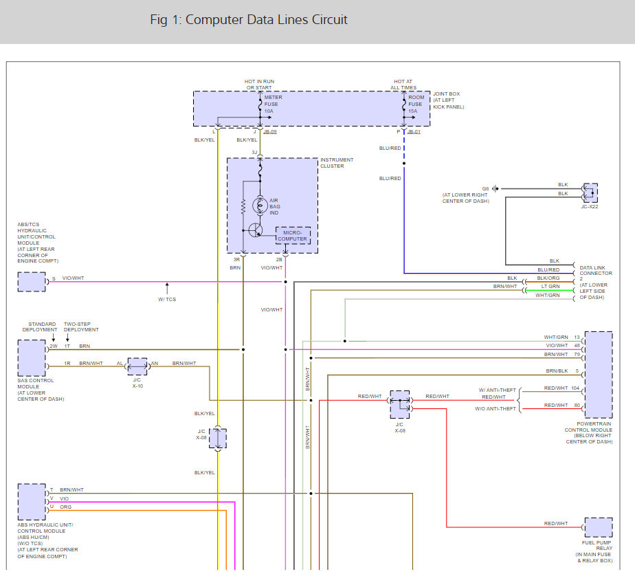

I think you popped a fuse or the sensor shorted which made the fuse fail. Here is a guide to help you check the system fuses:

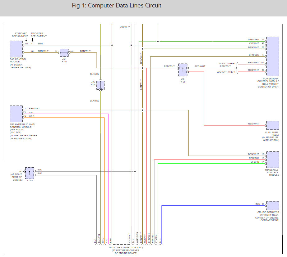

Here are the fuse locations (below) along with a wiring diagram of the ALDL connector.
I would also see if a code reader will power up.

Thanks for all the diagrams. I went to a junkyard and pulled the instrument cluster out of the same model and installed it on my van. Now all the lights work including the check engine. I have to run through a drive cycle again and hopefully the check engine light will stay off. I have a OBDII scanner which is helpful. Only question I now have is, how to turn back the mileage to the correct miles? Thanks
