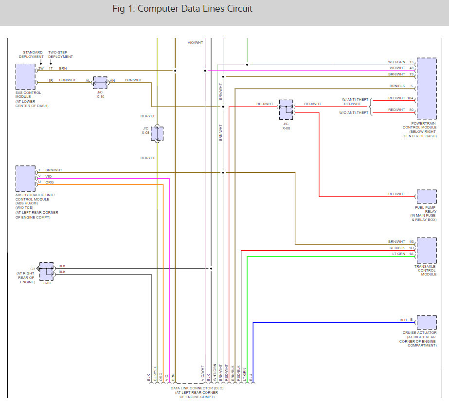

The car that I was replacing the sensor on suddenly the check engine light will not come on at all now and caused a fail at e Check today. It was working fine yesterday and all I did was replace a sensor. What happened now? Thanks

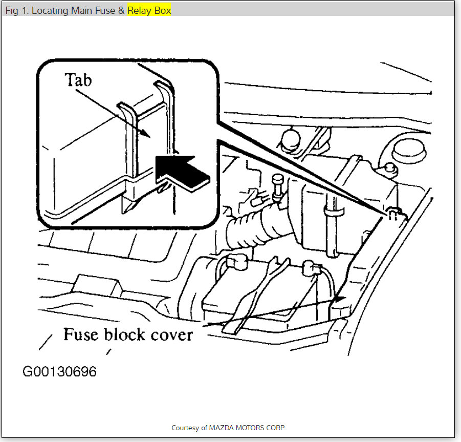

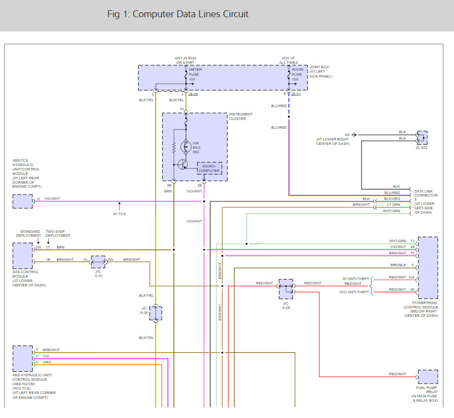

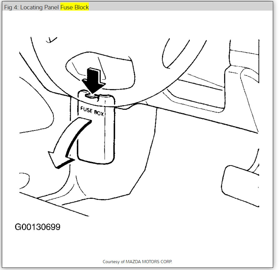

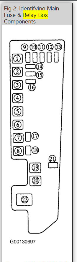

  • 54,832 POSTS

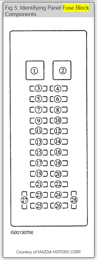

I think you popped a fuse or the sensor shorted which made the fuse fail. Here is a guide to help you check the system fuses:
Here are the fuse locations (below) along with a wiring diagram of the ALDL connector.
I would also see if a code reader will power up.
