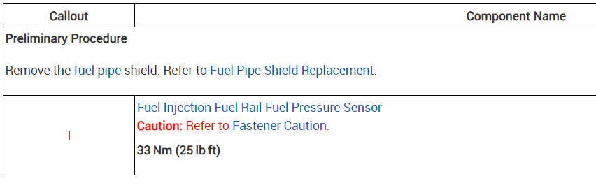

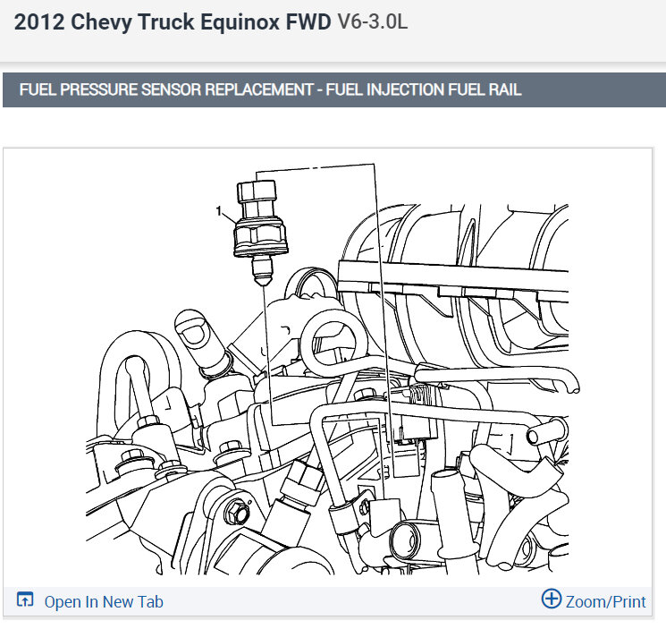

I had codes checked, and they recommend MAF sensors. There is no change since replacing it. It has been difficult to start after fill up twice now and has rough idle. I assume that it is probably a fuel pressure sensor or fuel pump. What is the best way to determine definitively?
Sep 15, 2024 at 6:35 AM
  • 55,694 POSTS
The fuel pressure sensor will make it idle rough and have low power, but can I ask what the codes are, so we don't go down the wrong trial in the repair process? This guide can help, and I have included the location of the fuel pressure sensor so you can check it out and replace it if necessary.
https://www.2carpros.com/articles/repairing-engine-rough-idle-issues
Sep 15, 2024 at 7:55 AM
RFRAZIERRVT

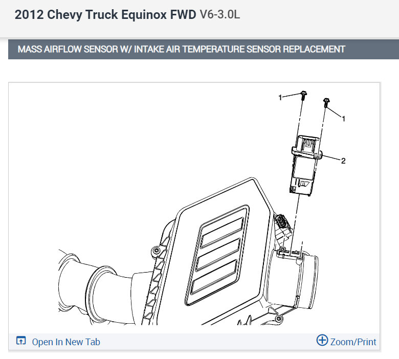

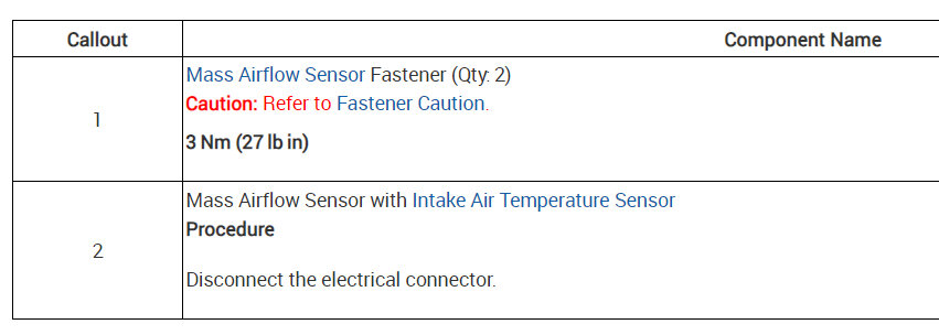

Not sure which code but I believe it was “running lean/bank 2”?
Sep 15, 2024 at 8:05 AM
  • 55,694 POSTS
Sorry, I linked the wrong guide, I fixed it. Yep, a lean code could be the MAF sensor, here is the location, also go over this guide as well:
https://www.2carpros.com/articles/repair-lean-mixture-codes-p0171-or-p0174-on-some-manufacturers
The MAF sensor is a normal service item BTW. Check out the images (below). Please let us know what happens.
