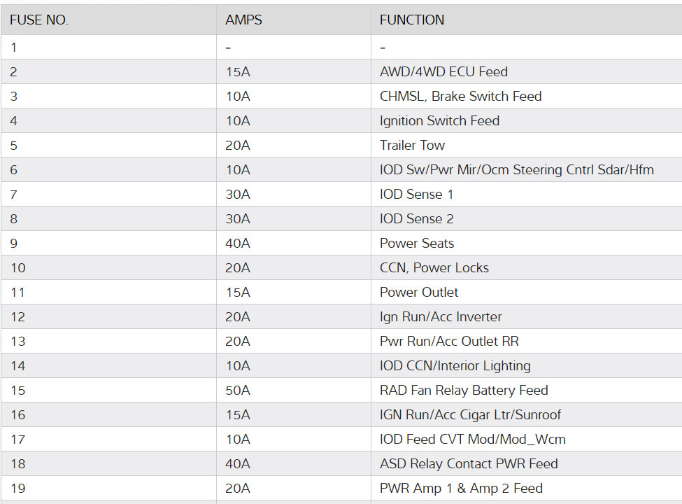

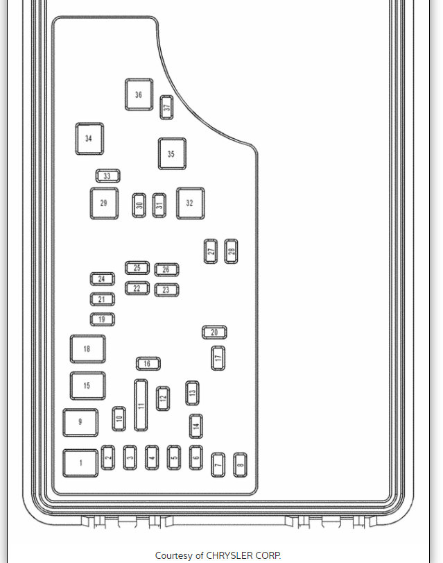

scanner will not power up to read codes.
Dec 19, 2017 at 9:33 PM
  • 55,758 POSTS

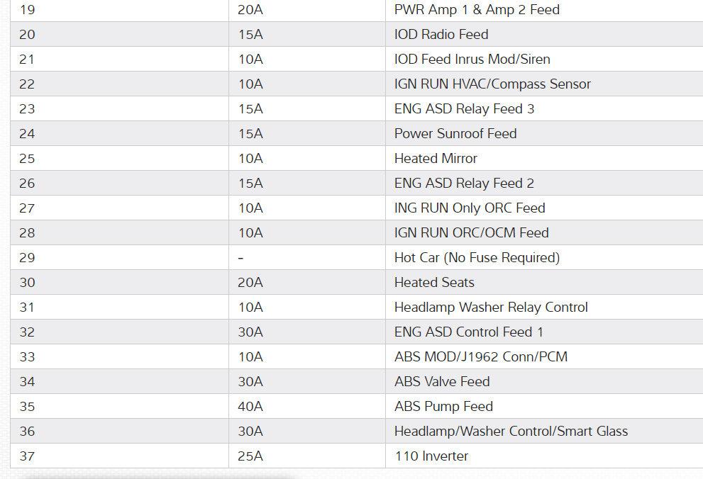

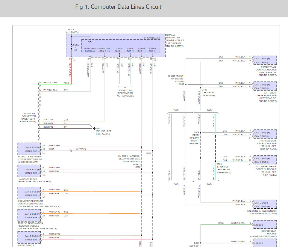

Please check fuse #33 10 amp which powers the ALDL connector.

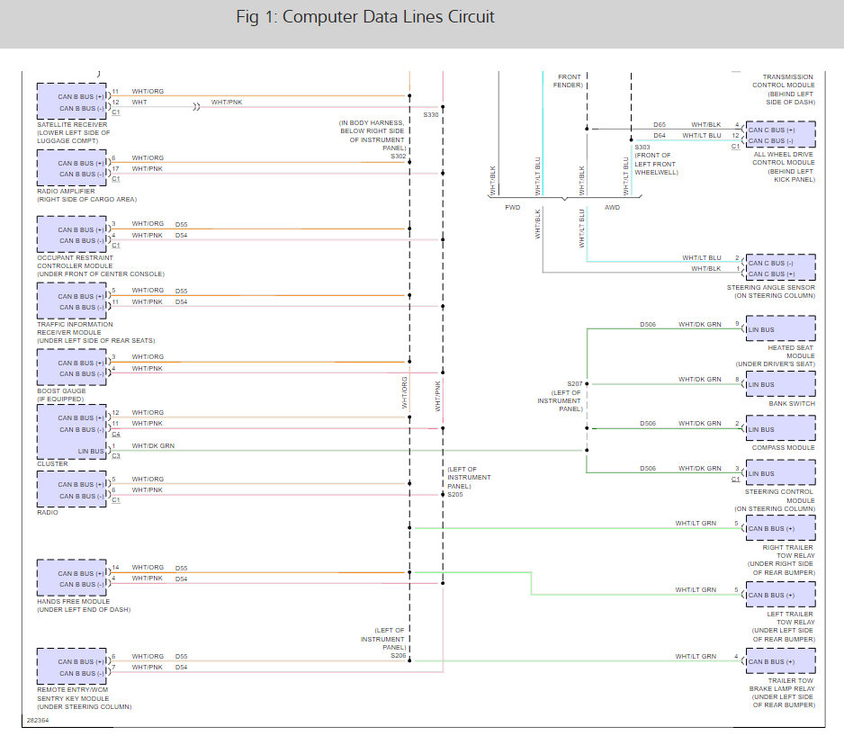

Here is a guide and the fuse panel and wiring diagrams for the circuit:
Please run some tests and get back to us.
