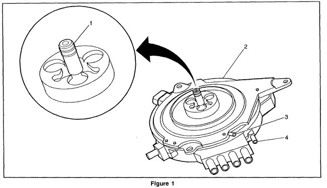

Misfiring in cylinders three and four. Have new distributor, spark plugs, spark plugs wires, injectors. Have done compression test, replaced computer also. Still have a miss.

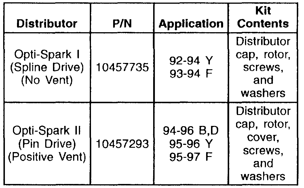

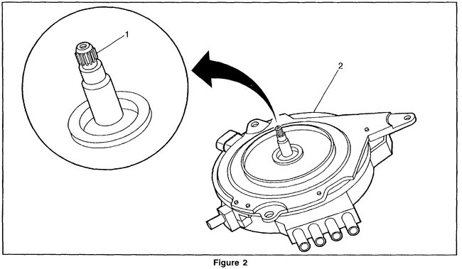

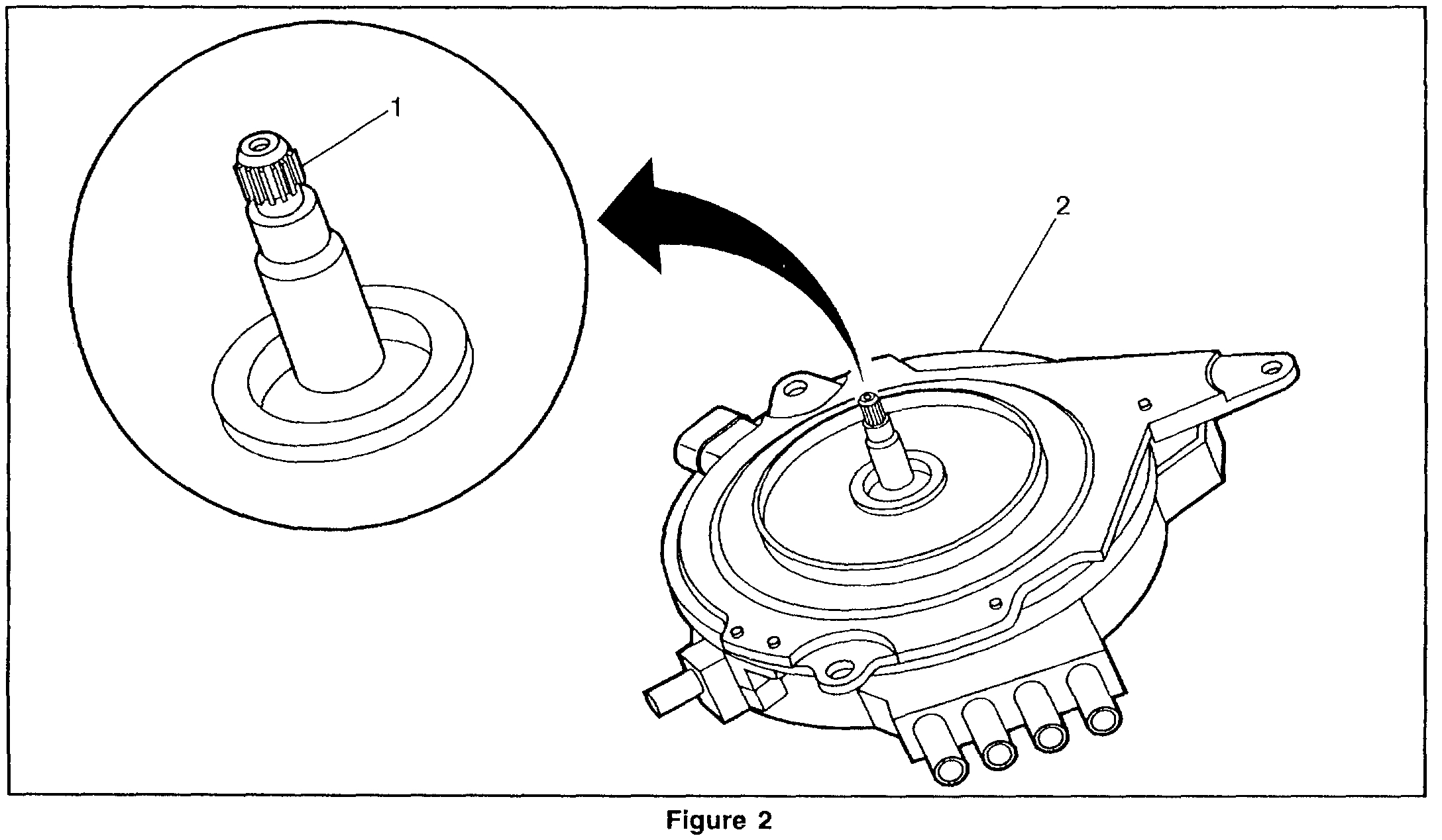

Also, I came across an old technical service bulleting (TSB) you may find of interest. Take a look through it and let me know if it helps in any way. The attached pics correlate with the TSB.

Perform strategy-based diagnosis. If it is determined that the ABITS cap and/or rotor is the source of the concern, then a service kit may be now implemented instead of a complete ABITS assembly.
Parts Information
There are two (2) variations of Opti-Spark Distributors. It will be mandatory to identify which type is to be serviced for proper parts procurement.
pic 1
1. Opti-Spark Distributor II (Pin Drive - WITH positive vent system) can be identified by the intake manifold vacuum hose connection (3), air intake duct hose connection (4), or non-splined pin drive (1). Refer to Figure 1.
pic 2
2. Opti-Spark Distributor I (Splined Drive - Without positive vent system) can be identified by the splined pin drive (1), or the lack of intake manifold vacuum hose connection and air intake duct hose connection. Refer to Figure 2.
pic 3
Important:
it is necessary to use tool J 39997 (or equivalent) for the Distributor Cap Screws and tool J 39998 (or equivalent) for the Rotor Screws. Parts are currently available from GMSPO.
