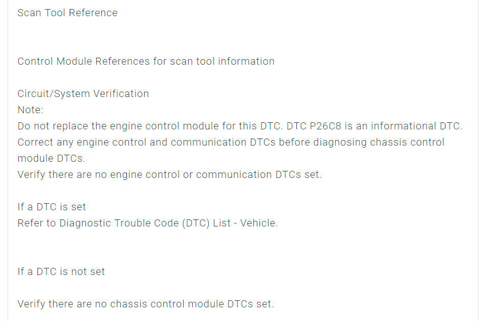

Code P26C8.
Feb 3, 2021 at 12:14 PM
Good afternoon,
Are there any other codes stored?

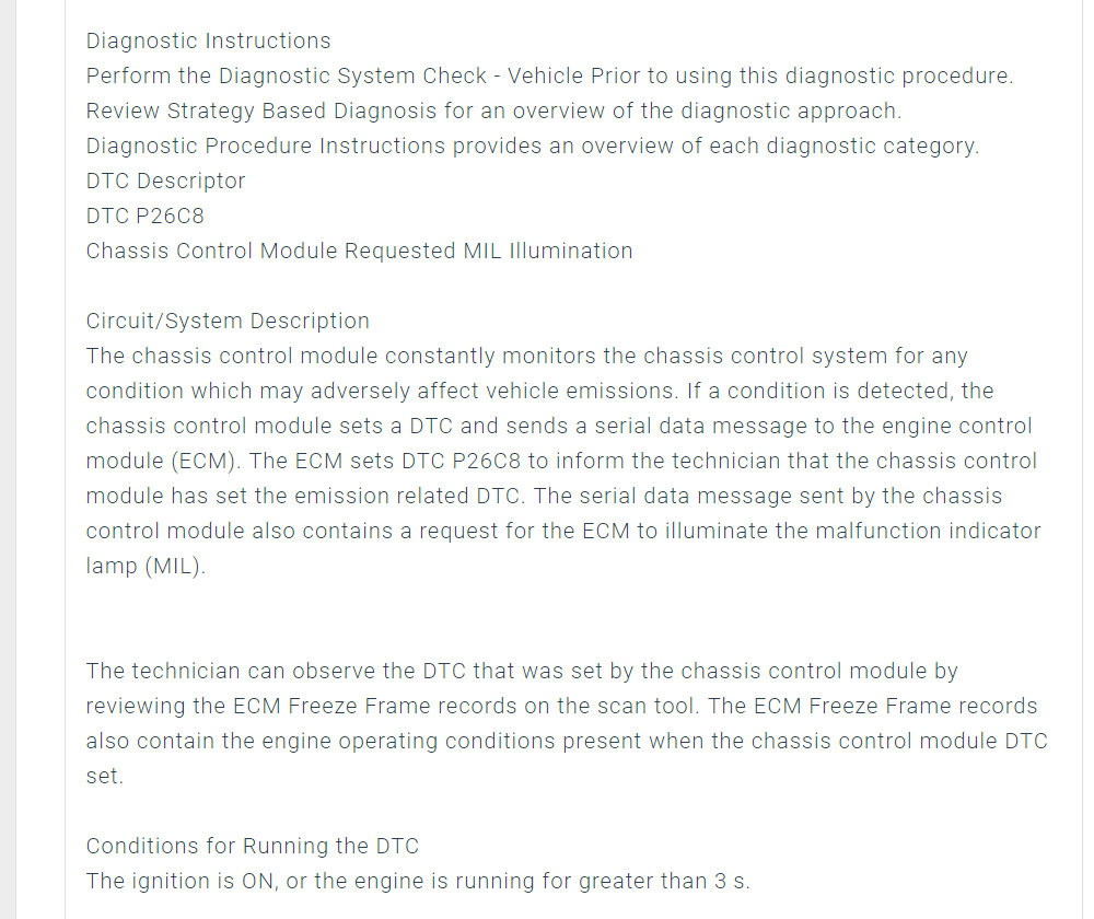

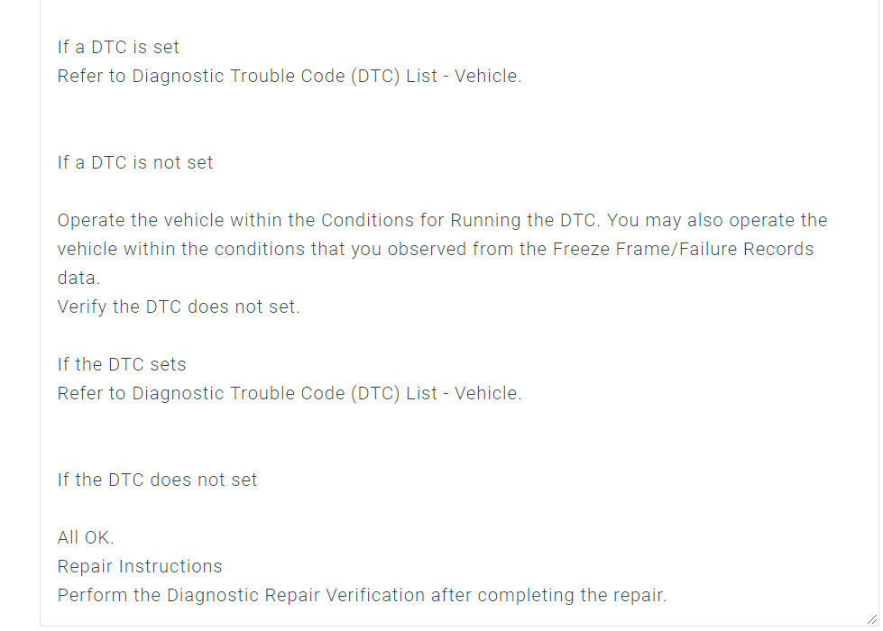

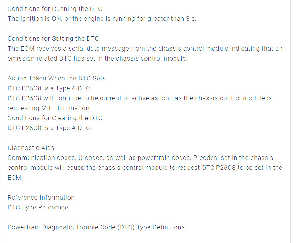

This is a communication code between modules through the CAN lines. I attached a guide for you on the CAN network and the description below.
