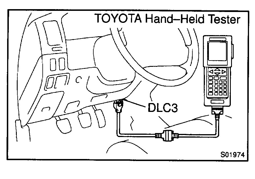

a. Connect the TOYOTA hand-held tester to the DLC3.
b. Turn the ignition switch ON and TOYOTA hand-held tester main switch ON.
NOTE: Do not start the engine.
c. Select the active test mode on the TOYOTA hand-held tester.
d. Please refer to the TOYOTA hand-held tester operator's manual for further details.

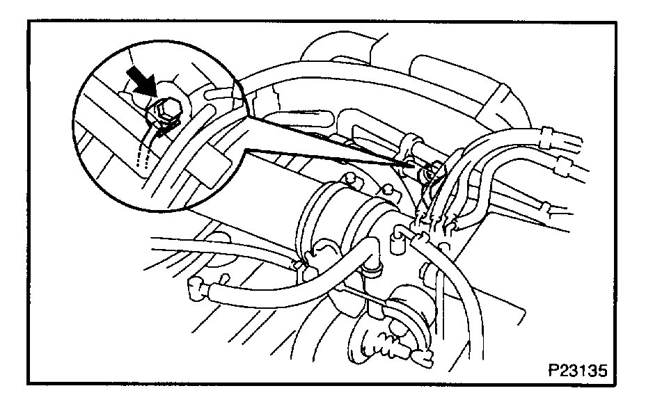

e. If you have no TOYOTA hand-held tester, connect the positive (+) and negative (-) leads from the battery to the fuel pump connector.
pic 2
f. Check that there is pressure in the inlet hose from the fuel filter.
HINT: At this time, you will hear fuel return noise.

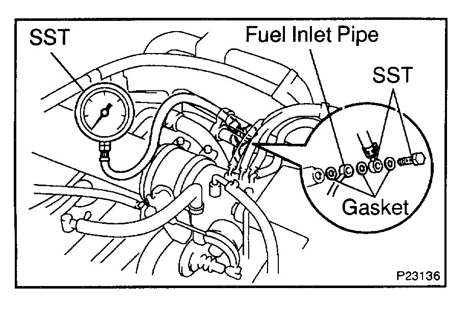

2. CHECK FUEL PRESSURE
a. Check that the battery positive voltage is above 12 volts.
b. Disconnect the negative (-) terminal cable from the battery.
c. Remove the union bolt and 2 gaskets, and disconnect the fuel inlet pipe from the delivery pipe.
HINT:
- Put a suitable container or shop rag under the delivery pipe.
- Slowly loosen the union bolt.
pic 4

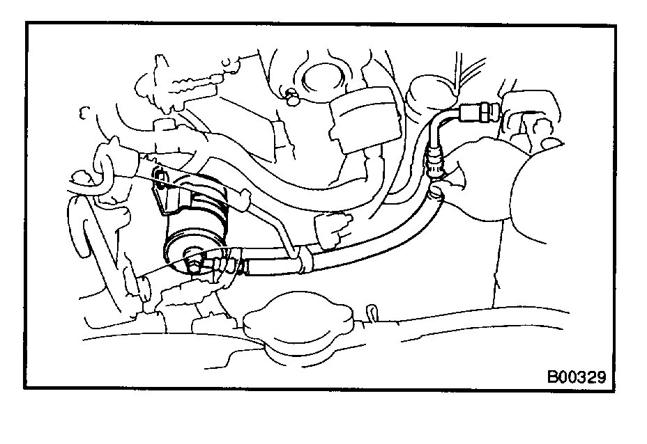

d. Install the fuel inlet pipe and SST (pressure gauge) to the delivery pipe with the 3 gaskets and SST (union bolt).
SST 09268-45014
Torque: 29 Nm (300 kg.cm, 22 ft.lb)
e. Wipe off any splattered gasoline.
f. Connect the TOYOTA hand-held tester to the DLC3. (See step 1.)
g. Reconnect the negative (-) terminal cable to the battery.
h. Turn the ignition switch ON.
i. Measure the fuel pressure.
Fuel pressure: 265 - 304 kPa (2.7 - 3.1 kg/Sq.cm, 38 - 44 psi)
