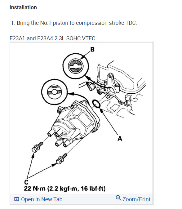

Bought a couple weeks ago had spark plugs and wires changed, fuel filter changed, distributor cap and rotor changed. Light came back on. Has just a small rough idle and a little lag in changing gears when picking up speed to enter highway.

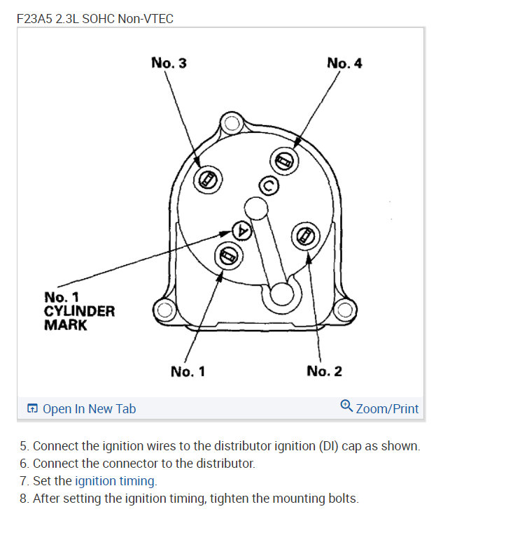

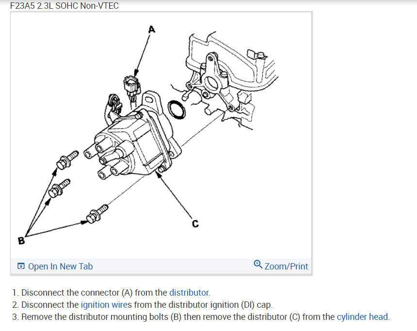

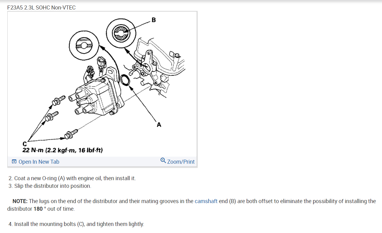

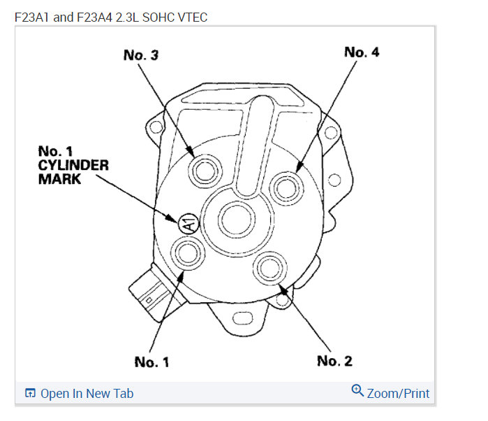

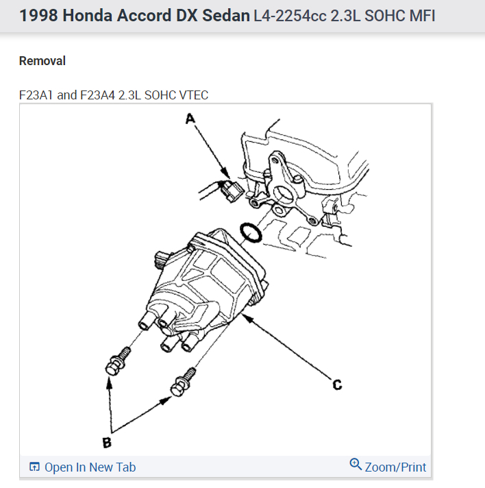

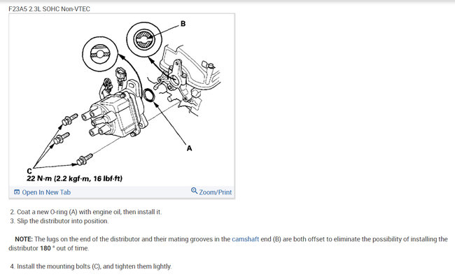

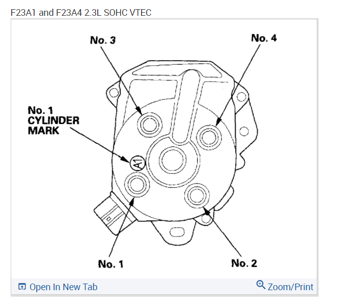

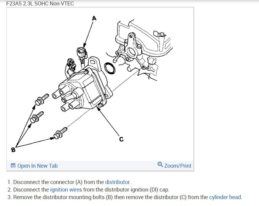

This is common when the ignition distributor goes out. To confirm the issue remove the distributor cap and look for rust colored dust. If found here is how you can change the distributor out I would get a rebuilt unit from Amazon (high quality only). Check out the diagrams (below). Let us know what happens and please upload pictures or videos of the problem.
