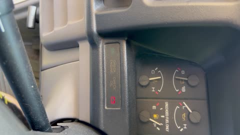

While driving from Laramie to Denver the check engine light came on a handful of times for a few seconds and then went off again. I am not sure where to look or what to check. My friend thinks that is has to to with the wiring harness shorting due to heat from being too close to the head and the intake manifold.

That could be but we need to run the codes which will tell us which system is having an issue, this guide will help:
https://www.2carpros.com/articles/diagnostic-trouble-codes-for-1995-and-earlier-mazda-cars-obd1
Please go over this guide and get back to us.

Good morning, I have gotten the codes to show but I can’t tell the exactly what the codes are.I have a video attached of the code flashes.

Sorry, but the video is too high I can just see the gauges. Can you please reshoot it?
