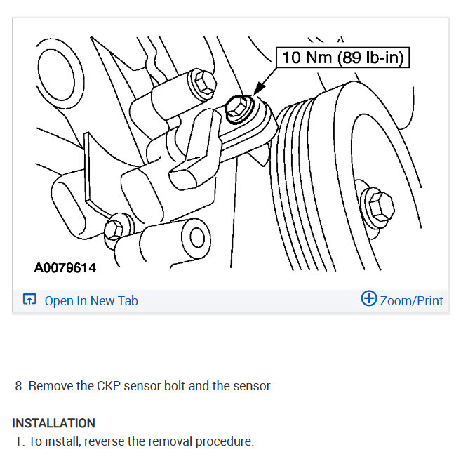

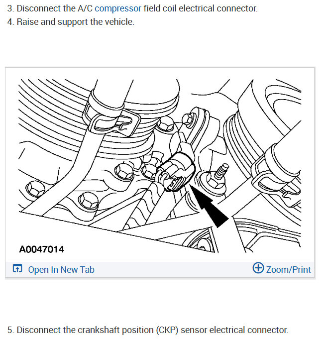

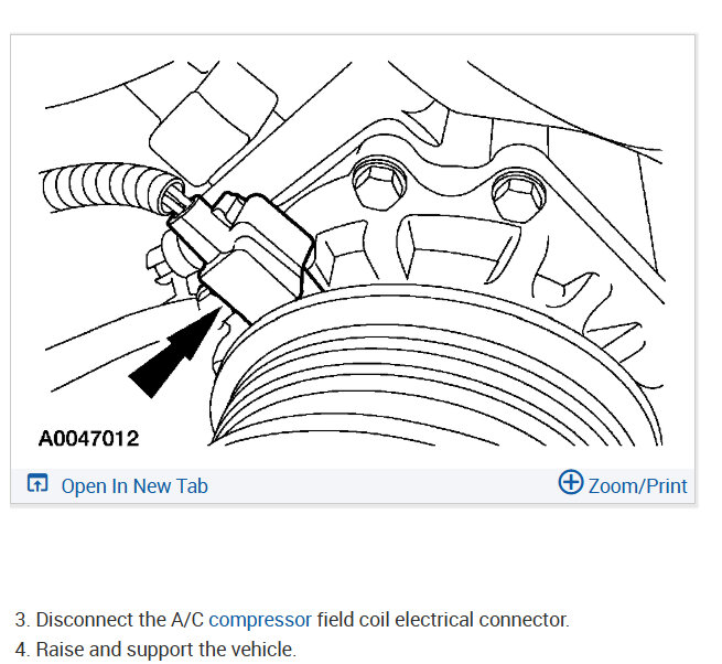

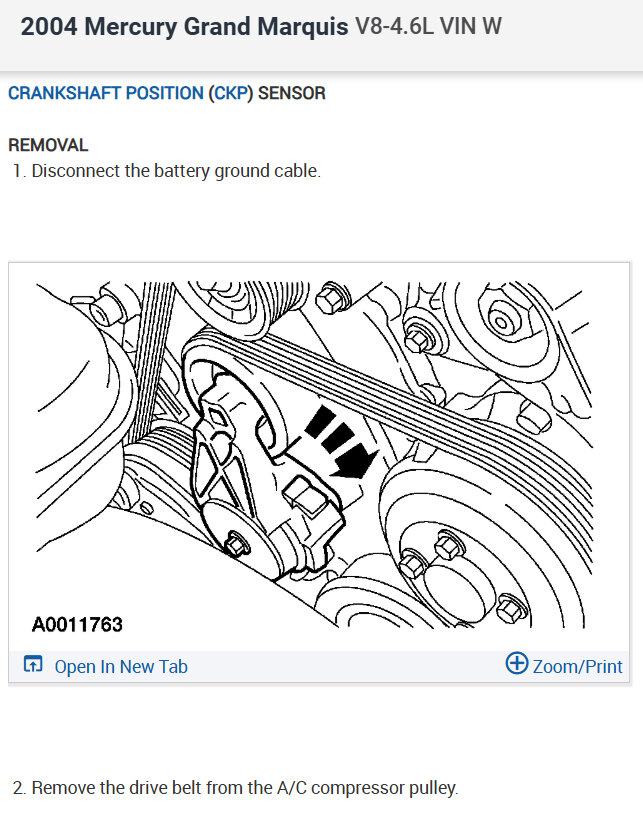

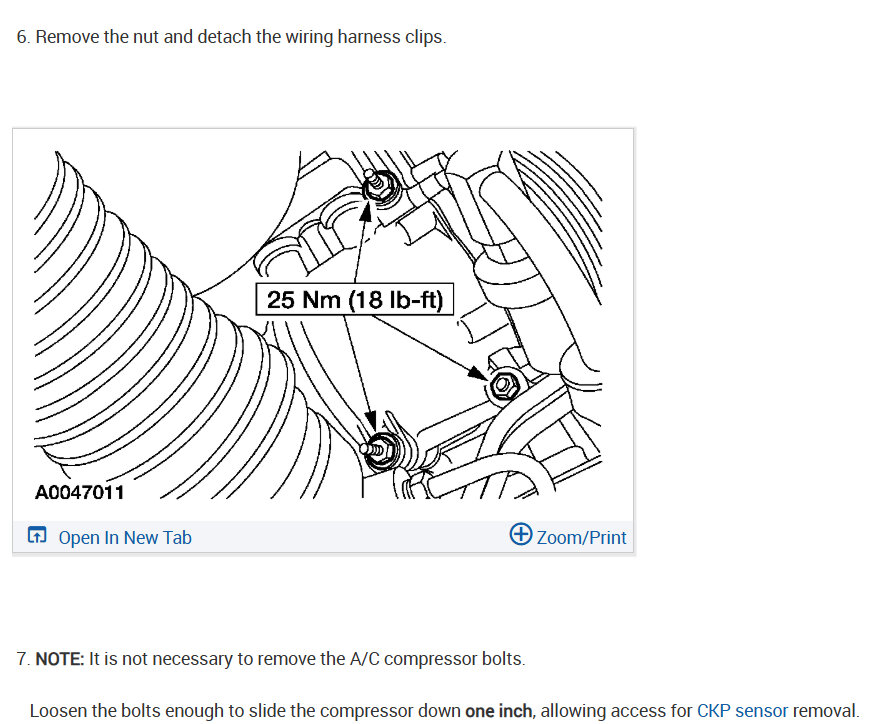

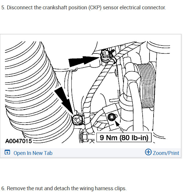

Here is the location and how to replace the crankshaft sensor. Check out the images (below). Please let us know what happens.
