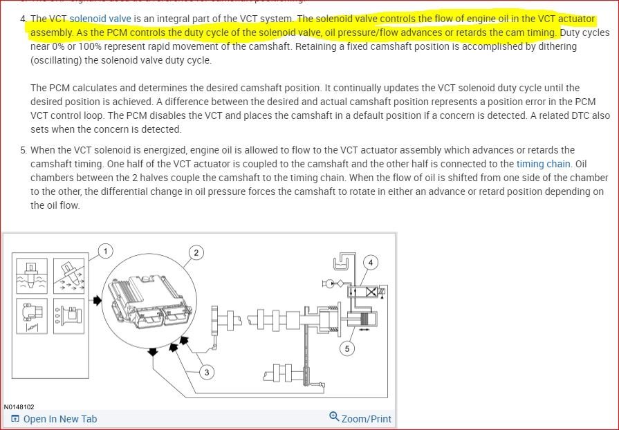

I have the vehicle listed above Titanium. The check engine light came on recently. My dealership is trying to tell me that the check engine light came on for VCT operation affected by worn oil. Meanwhile, my car said that I was at 50% oil life. Looking at my records it had been 5,000 miles since my last oil change. I typically get it changed between 3,000 and 6,000 miles or every other month. The initial diagnosis was indicating an issue with the cam shaft. They had my car for six days, only put three miles on it for road testing, and then changed the diagnosis to worn oil. Something isn't sitting right with me. Does this sound accurate?
Jun 11, 2019 at 2:30 AM
This system runs off of oil pressure. So the condition of the oil is important. As long as you are using the correct weight of oil and change it frequently which is sounds like you do, then I would not suspect the oil is the cause.
I have seen metal get on the screen of the oil control valve and this causes excess resistance/pressure in the phaser and they suspect it is the oil is too thick because the computer only knows the phaser is not responding the way it expects. The only way to truly check is to pull the control valve out and look at the screen or check for metal in the oil.
Changing the oil may see an improvement or cause the light to turn out but if I am correct it will return.
If it were my car, I would be stating that if on oil change is their diagnosis, then they should cover that under the powertrain warranty (assuming you still have powertrain warranty based on age and mileage) and if they are incorrect, what the next steps will be. Reason is, you are not due for an oil change so the oil should be fine.
