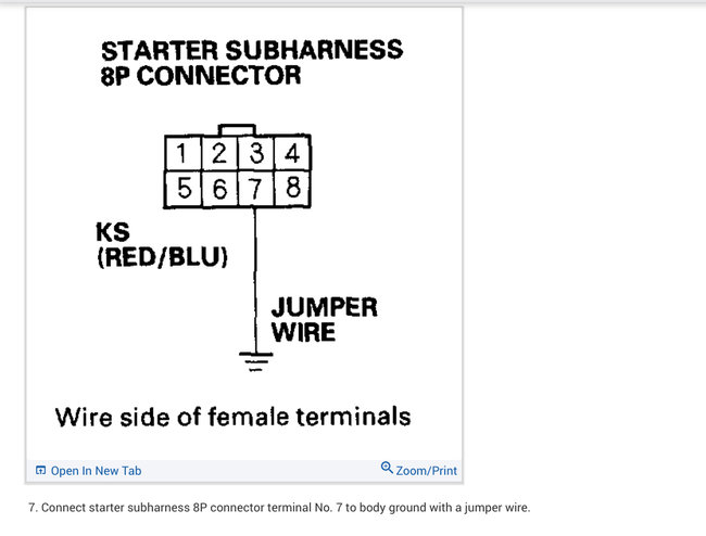

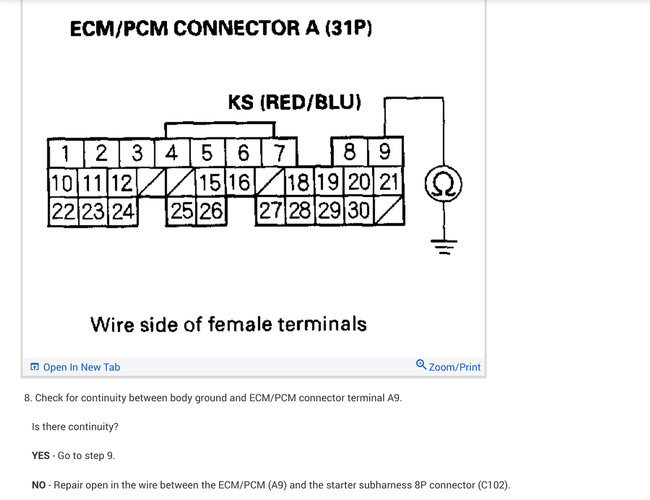

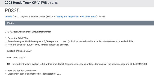

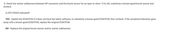

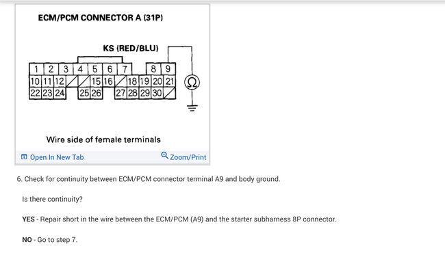

P0325 knock sensor replaced sensor code intermitted goes on. Sometimes stays on for awhile. Check engine no knocking sounds from engine. Checked spark plugs, wiring, fuel pressure and it all good. Only is possibly a bad wiring issue.
Jan 10, 2020 at 10:13 PM
SCGRANTURISMO
  • 4,897 POSTS
In the diagrams down below I have included the diagnostic troubleshooting flowchart for Direct Trouble Code[DTC] P0325 for your vehicle from the vehicle manufacturer. Please go through this guide and get back to us with what you are able to find out.
