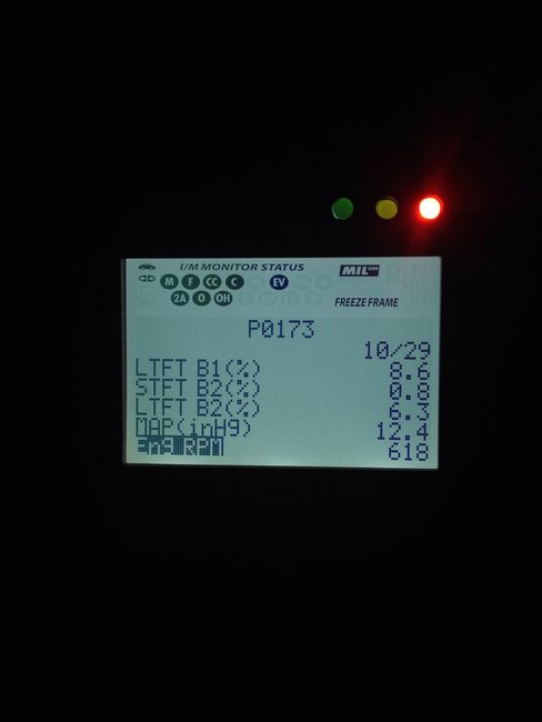

A common issue on Mercedes that set those codes is a defective Mass Airflow Sensor. You would need to connect a scan tool and look at the airflow the MAF is reporting to make sure. At idle you should see between 3.5 - 4.5 grams per second and between 8 and 12 g/s at 2500 no load rpm. Be careful of the lower cost replacements, very often they are out of spec as well.

Mercedes is one of the few companies that use those codes. They show that the ECM is pushing the fuel trim controls over the range they are supposed to operate in. They use a very narrow range compared to other makes. You may not notice the minor change in mileage they cause or other minute changes. However the computer sees them and sets those codes. The only real way to find the problem is to watch the numbers live.

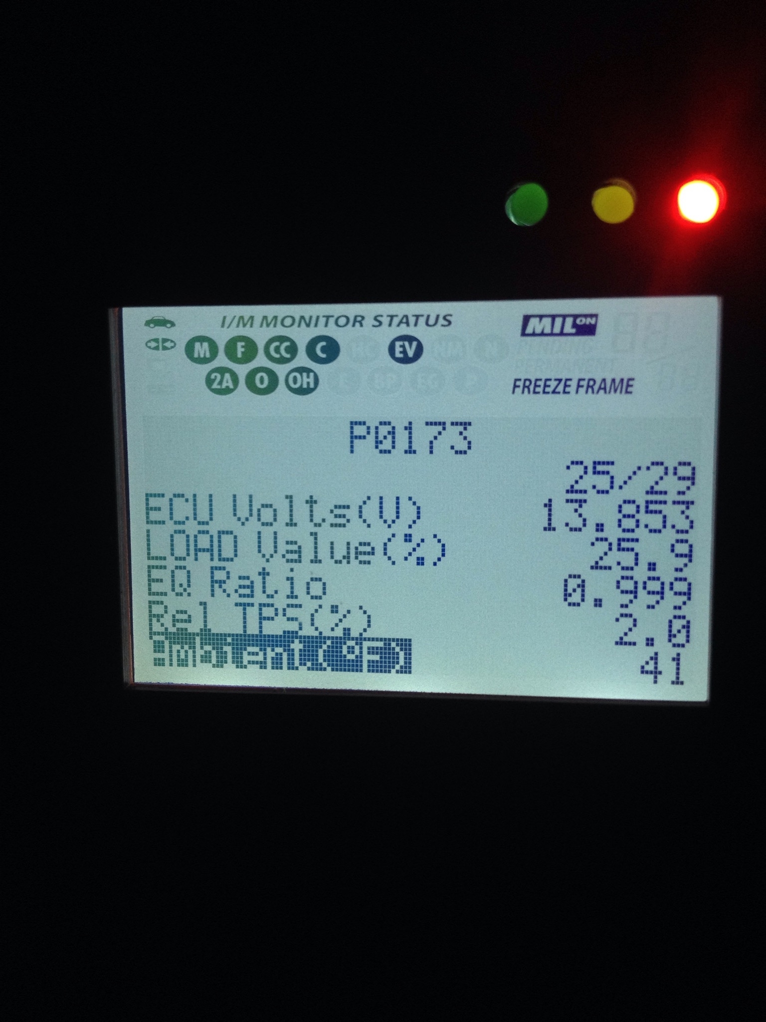

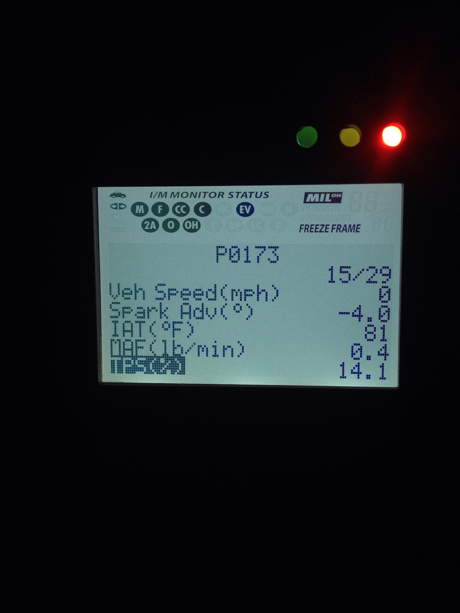

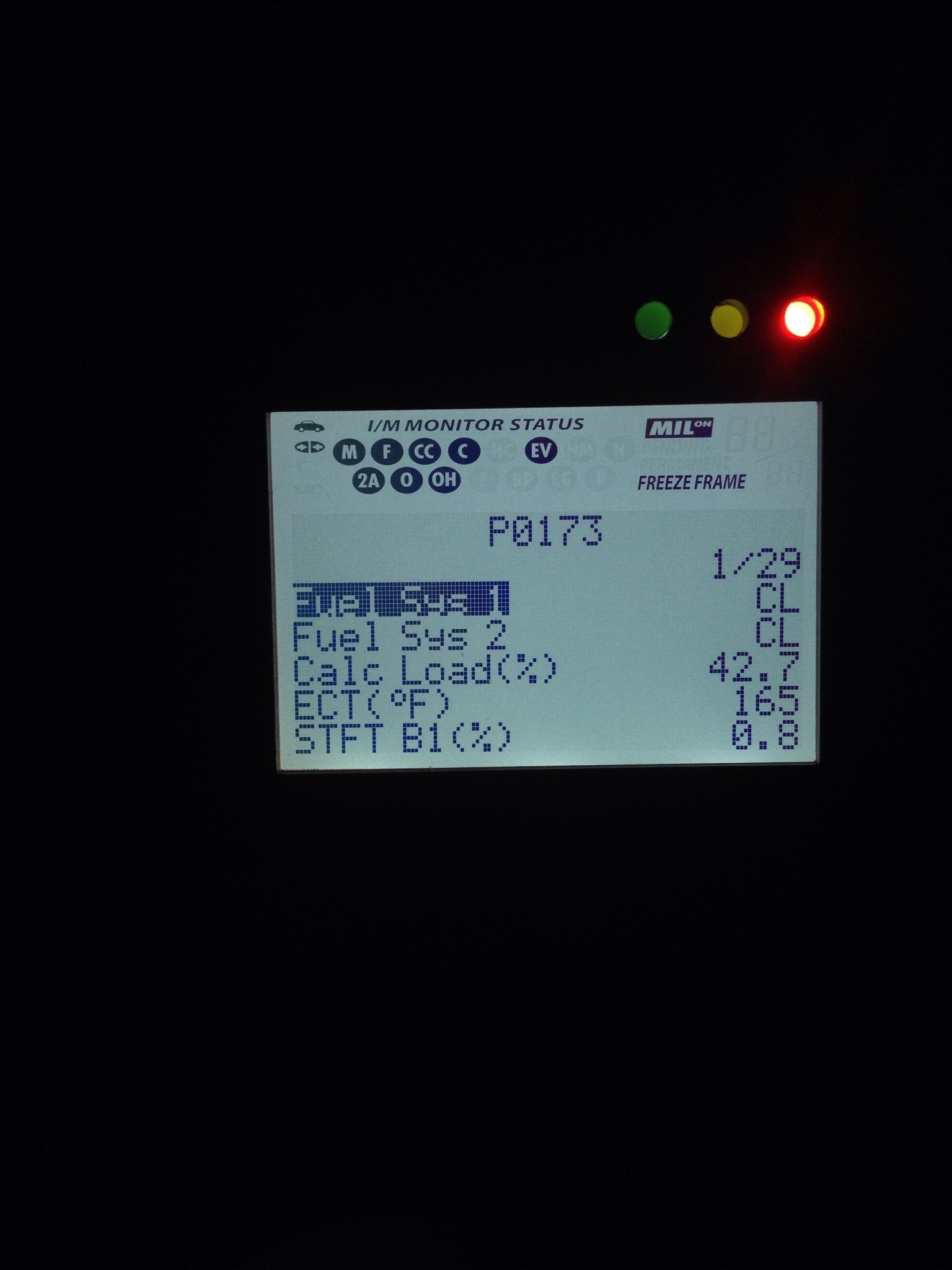

Thank You for answer! Experts say different things o2 sensor, fuel pump, fuel filter, Maf,inject, other say nothing do not worry it is dirty fuel problem, just add 100 ml 96% medical alcohol. who to believe? I want to know what the exact problem. I do not trust anyone. now put my pictures, I do not know what they mean, I captured when the car is off, something they say.
