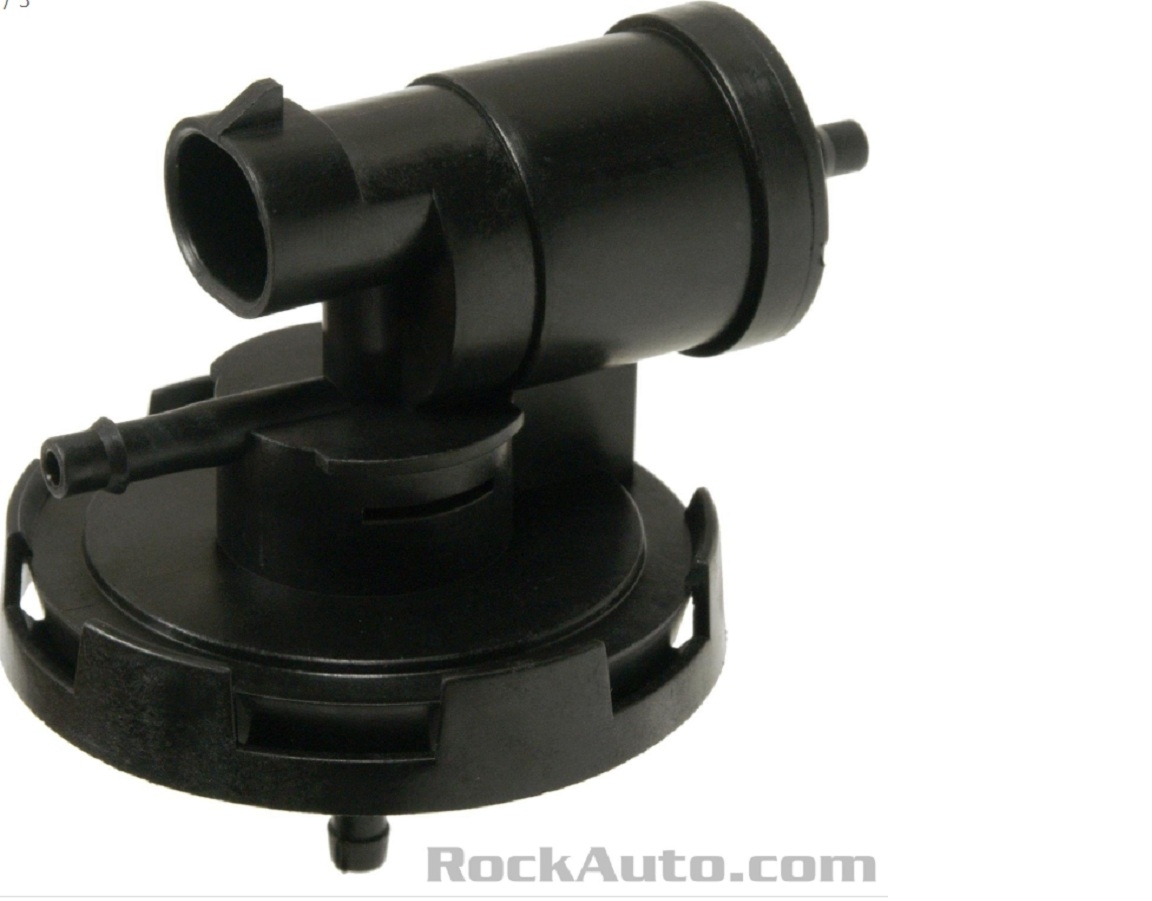

When you have an engine-related problem, please list which engine you have. I have five Grand Caravans including a '94 and a '95, both with the common 3.3L engine, so I'm very familiar with them. If that is what you have, the EGR valve sits on top of the intake manifold, close to the brake master cylinder. (I'm doing this from memory here). The part that's more likely to fail is the amplifier on top of the valve. That's about a three-inch diameter black plastic disc. It has a two-wire connector going into a switching valve on top. A vacuum hose is also attached to that valve. This photo shows what the replacement looks like. It is commonly referred to as a "transducer".
Years ago, the only way to get a new transducer was to buy the entire EGR valve with the amplifier mounted to it. Today you can buy just the amplifier. The first thing to do is to be sure the connector didn't get unplugged and overlooked.
Next, if you would like to pursue this the way a mechanic would, use an inexpensive digital voltmeter to back-probe the two wires in the connector, and tell me what you find. For this type of problem, to be valid, the readings must be taken with the connector plugged in. The ignition switch must be in the "run" position. If you don't know how to use a voltmeter, I can help with that. Stick the meter's probe into the back of the connector, alongside the wire, until it touches that terminal and you get a reading. Do the same for the second wire, then tell me what you find.
Since this is such a simple circuit, and since the replacement part is relatively inexpensive, this is one time I would let you just pop in a new one to see if it solves the problem. Normally we don't spend our customer's money on a part until we've ruled out all the other possible causes. Code 32 is saying the computer sees the two wires are shorted together, or there is a break in one of them. The break is more common, and is most likely to occur inside the valve. The next most likely cause for a break would be corroded or stretched terminals in the connector. (That's much less likely if no one has had that connector disconnected or monkeyed with it).

The bottom line is, . . . if you don't want to do any other testing first, replace the transducer on top of the EGR valve. The same part is used on the identical 3.8L engine. It is also used on the 3.0L Mitsubishi engine. I have that engine in an '88 and '89, but they either didn't use the EGR valve in those years, or I don't remember where it is.

Well I replaced the whole solenoid and it came with that black part on it and havnt reset the code yet so I’ll try that

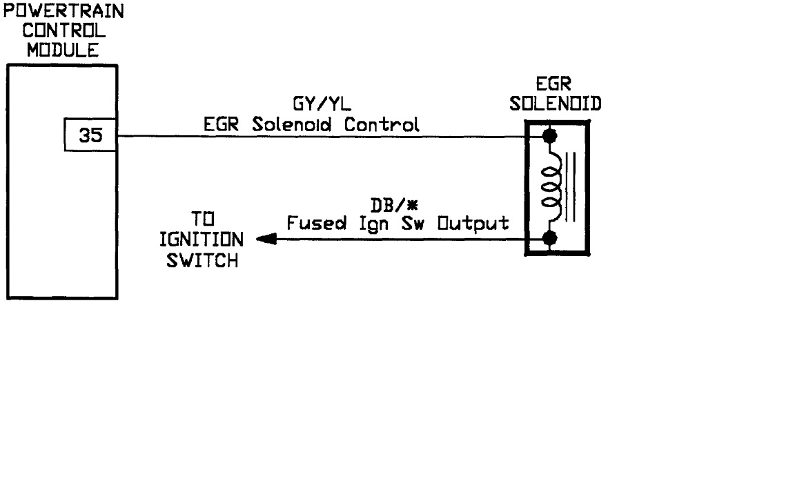

That's code 32 again. Now we have to refer to the diagram I posted earlier. You'll need a digital voltmeter. Do you know how to use one?
For a good first step, if I understand correctly, the Check Engine light will be off when you turn on the ignition switch, then the light turns on later while you're driving. If that's right, have a helper watch for that light, then you go under the hood and gently wiggle the connector to that valve assembly. The ignition switch must be on "run" but the engine shouldn't have to be running. If the light turns on when you wiggle the plug, turn the ignition switch off, then back on, and see if you can make the same thing happen repeatedly. If you can, the suspicion is the terminals in that connector are corroded or are making weak contact. My solution would be to remove each terminal to clean them and bend them to make better contact. When that doesn't work, I'd head to a pick-your-own-parts salvage yard to get a replacement connector and splice that in.
If wiggling the connector doesn't make the Check Engine light turn on, unplug it completely. That should turn the light on. If it still doesn't, that means my suggestion is not valid. In that case, use the voltmeter and back-probe the gray / yellow wire. Remember, for this test to be valid, the connector has to remain plugged in. You should find close to 12 volts. If you do, see if it stays there solidly as you wiggle the plug a little.

Thing is the part I believe came with a new transducer so I don’t see that being the problem my guess would be the connector

So what is the purpose of the transducer is it possible it came with a a bad one? The harness connector looked fine so I’m not sure what could be causing it

So you’re saying that the transducer could have a short inside the part itself? Could I try getting another transducer

No. I'm saying there are multiple possible causes for this code. Normally your mechanic would perform electrical tests first, then spend your money on a part if that's what is suspect. Because this used to be a common failure part, it was less expensive for you to pop in a new one as a test. While it is possible to get a defective new part, this is where the next step is to get more involved with testing the circuitry.
This valve actually works the opposite of what we'd expect. It wants to open all the time, which would cause a really miserable idle. The Engine Computer activates the solenoid to block vacuum, thereby keeping the valve closed when appropriate.
One quick check you can do is to unplug the solenoid connector while the engine is idling. That should make it go from a nice, smooth idle, to running rough and possibly stalling. If it does, the valve is working and the computer is controlling the solenoid. If it goes back to a normal idle when you reconnect the plug, the system is working. At that point we're looking for an intermittent problem.
There's two things left to do. With the engine running, wiggle the wires and solenoid connector to see if the idle quality changes. Flex the wire harnesses, and look for any place a harness runs over a metal bracket. It's somewhat common for a harness to fall down onto the sharp edge of a bracket, and the insulation on one or more wires will rub through and ground out. A short to ground on the gray / yellow wire would keep the valve closed, (smooth idle), but the computer would see no control current flowing through its switching circuit. That can set code 32.
A second test you can do is to measure the resistance on the gray / yellow wire to ground with an ohm meter. If you need help with that, let me know. This test can be done with the connector unplugged or plugged in, but it's still best to back-probe that terminal next to the wire. Poking a meter probe into the open terminal can stretch it, often causing a poor or intermittent connection later. With the ohm meter connected, watch for a change in the reading as you flex the wire harnesses.
If you do read a short to ground on the gray / yellow wire, the computer will recognize that when it tries to deactivate the solenoid. That occurs only after the engine is warmed up, and only at higher road speeds, not at idle. If flexing the wire harnesses doesn't make the short change or go away intermittently, disconnect the large plug from the Engine Computer. This is not at all common, but if doing that makes the short go away, replace the computer. A used computer from a salvage yard should be very inexpensive. One from a '95 model should work too as long it's for your engine size. I think a '93 computer will be the same, but ask someone at the yard to double-check.

I listed the next things to do. Gently wiggle and flex the connector, wires, and the rest of the wire harness to see if anything makes the idle quality change.
Check the resistance from the gray / yellow wire to ground. Keep watching the reading while you again, flex the wire harnesses. Expect to find a rather high resistance, as in the thousands of ohms range, or higher.
You can also check for 12 volts on the dark blue wire. The ignition switch will have to be in "run" during that test. I'm pretty sure the engine doesn't have to be running for that test, but if you do not find 12 volts on this wire, try again with the engine running. Let me know what you find with these tests.
