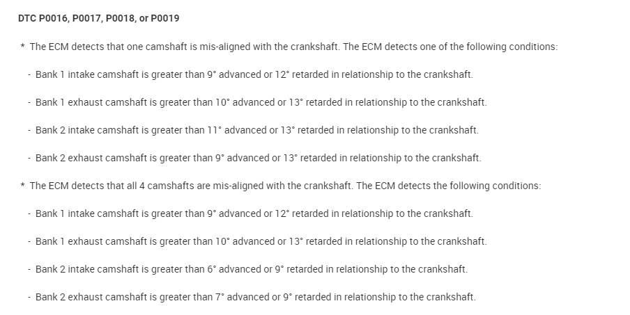

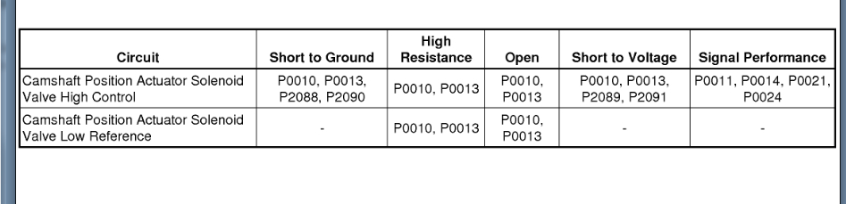

P0011, P0014 - Camshaft position sensor signal performance.
P0017 - ECM detects the cam shaft is misaligned.
Basically these codes are telling you that the ECM is seeing the cam shaft not where it is supposed to be. If you just had the timing chain replaced by a shop, I would take it right back. More then likely they did not set the timing correct.

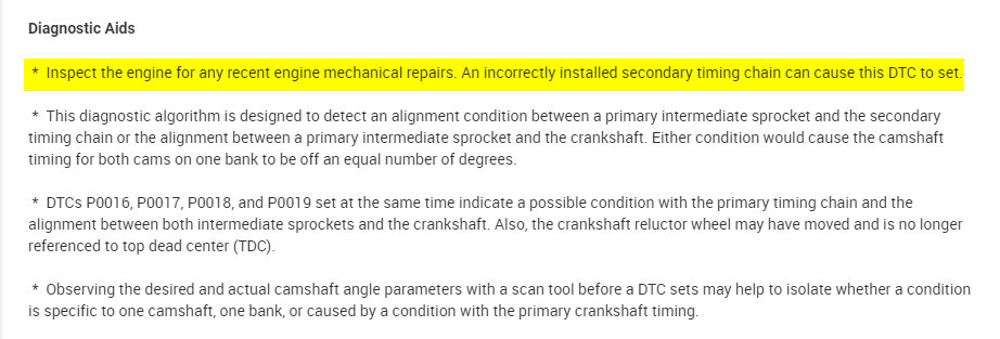

There is a slight chance that they just left a cam sensor unplugged due to the signal performance codes but the P0017 is saying that the cam shaft is misaligned. Normally it only says that if it can see where it is. However, my bet is that the secondary chain is not installed correctly. In fact it says this in the last attachment. Take a look at this info and let me know if you have questions.

As for other possible causes, it could be a faulty sensor but as I said, the fact that the service manual calls out specifically that if work to the timing system was just done to check the work because it will cause this code, tells me they are just missing it.
