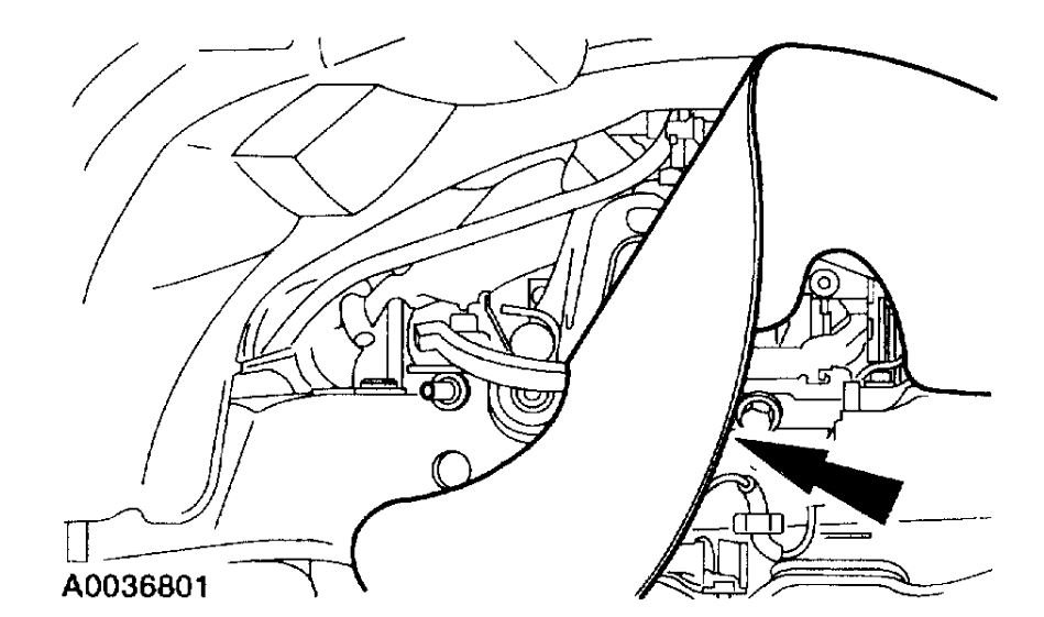

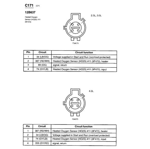

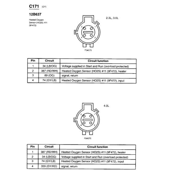

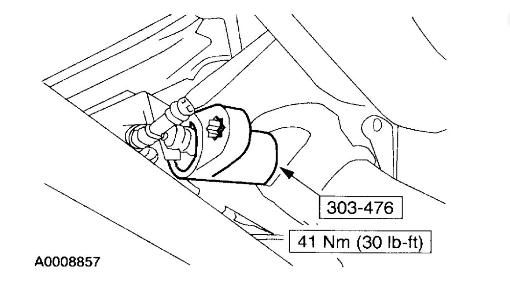

I listed the possibilities for you to review. They all can cause this issue.
You will need a scan tool to monitor live data for this code.

Flow chart
HA40 DTC P1131, P1151, P1132, P1152, P2195, P2196, P2197 AND P2198: UPSTREAM HO2S(S) NOT SWITCHING. DTCs P1130 AND P1150: FUEL SYSTEM NOT SWITCHING AT THE FUEL TRIM (RICH OR LEAN)
HO2S DTCs Reference list
- HO2S-11 = DTCs P1131, P1132, P1130, P2195 and P2196
- HO2S-21 = DTCs P1151, P1152, P1150, P2197 and P2198
- Check intake air system for leaks, obstructions, damage and blockage.
- Verify integrity of the PCV system.
- Check for disconnected spark plug wires.
- Check for vacuum leaks.
Are any of the above concerns present?
- REPAIR as necessary.
- GO to DC25 See: Computers and Control Systems > Diagnostic Trouble Code Tests and Associated Procedures > DC: Mass Air Flow (MAF) Sensor - Pinpoint Test
