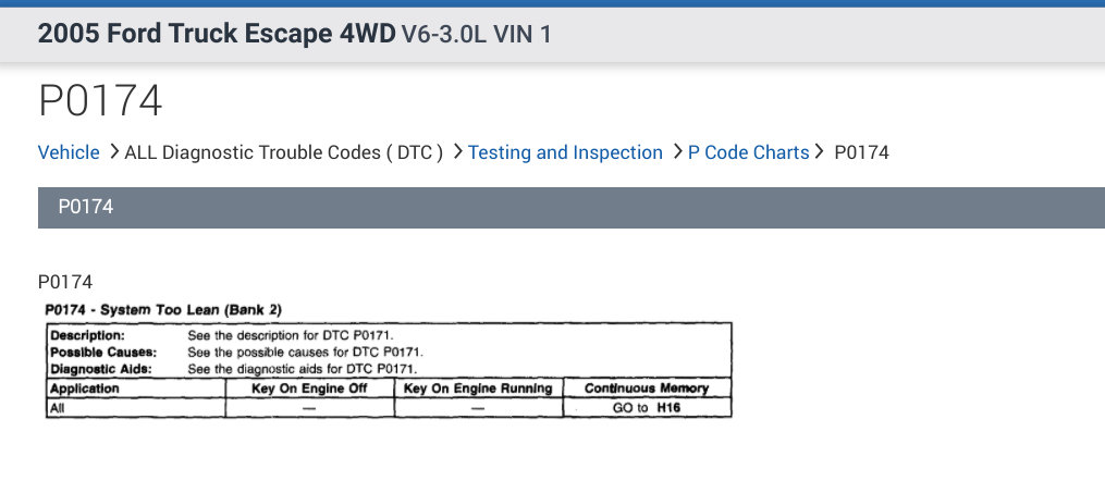

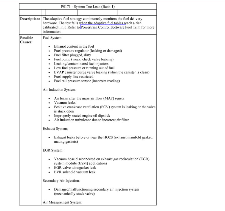

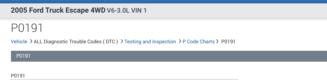

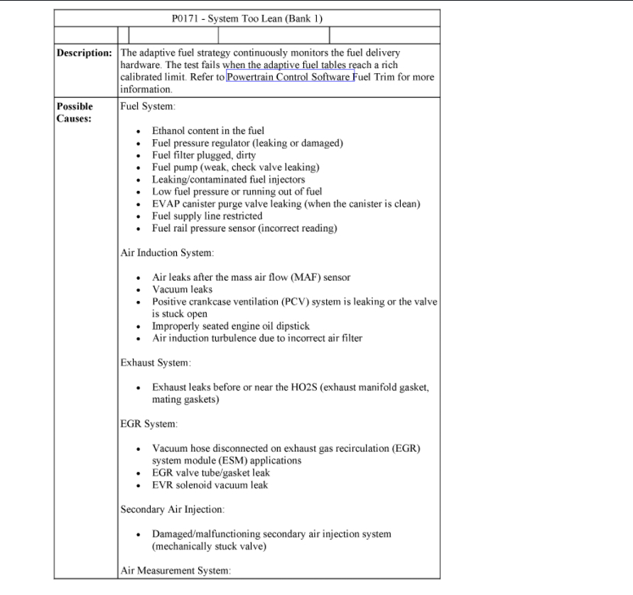

P0171,P0174 ,P0191, and P0191.
Jan 26, 2020 at 7:56 AM
SCGRANTURISMO
  • 4,897 POSTS

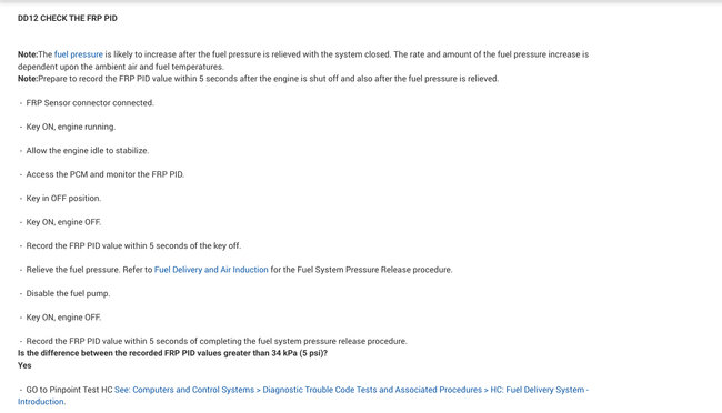

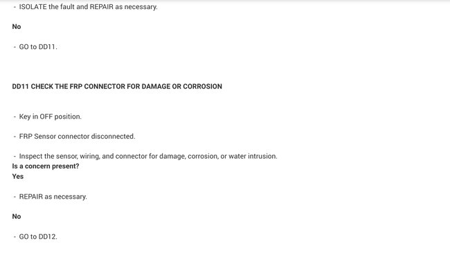

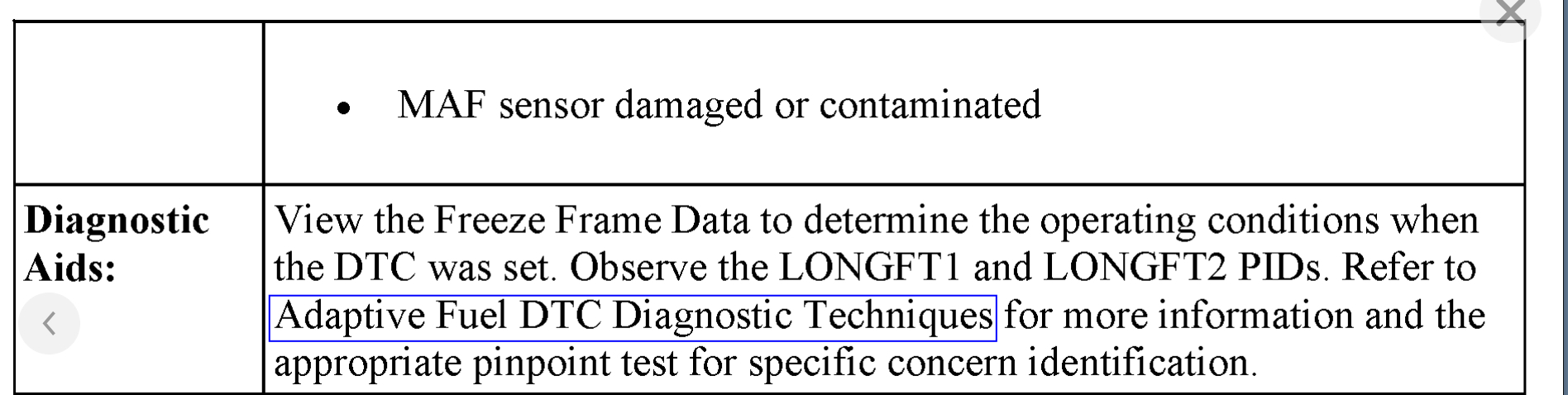

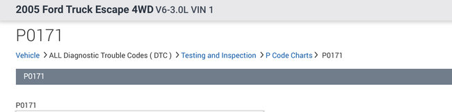

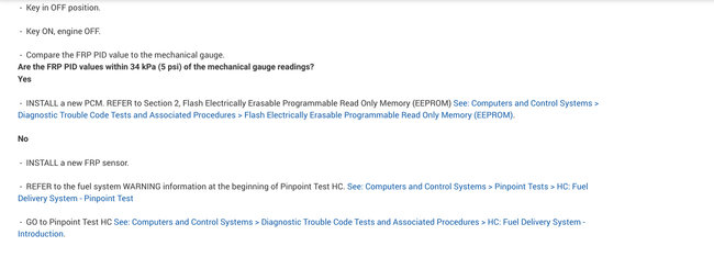

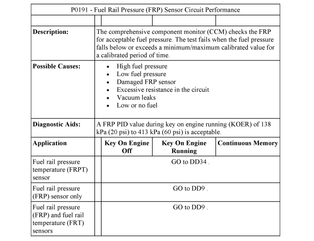

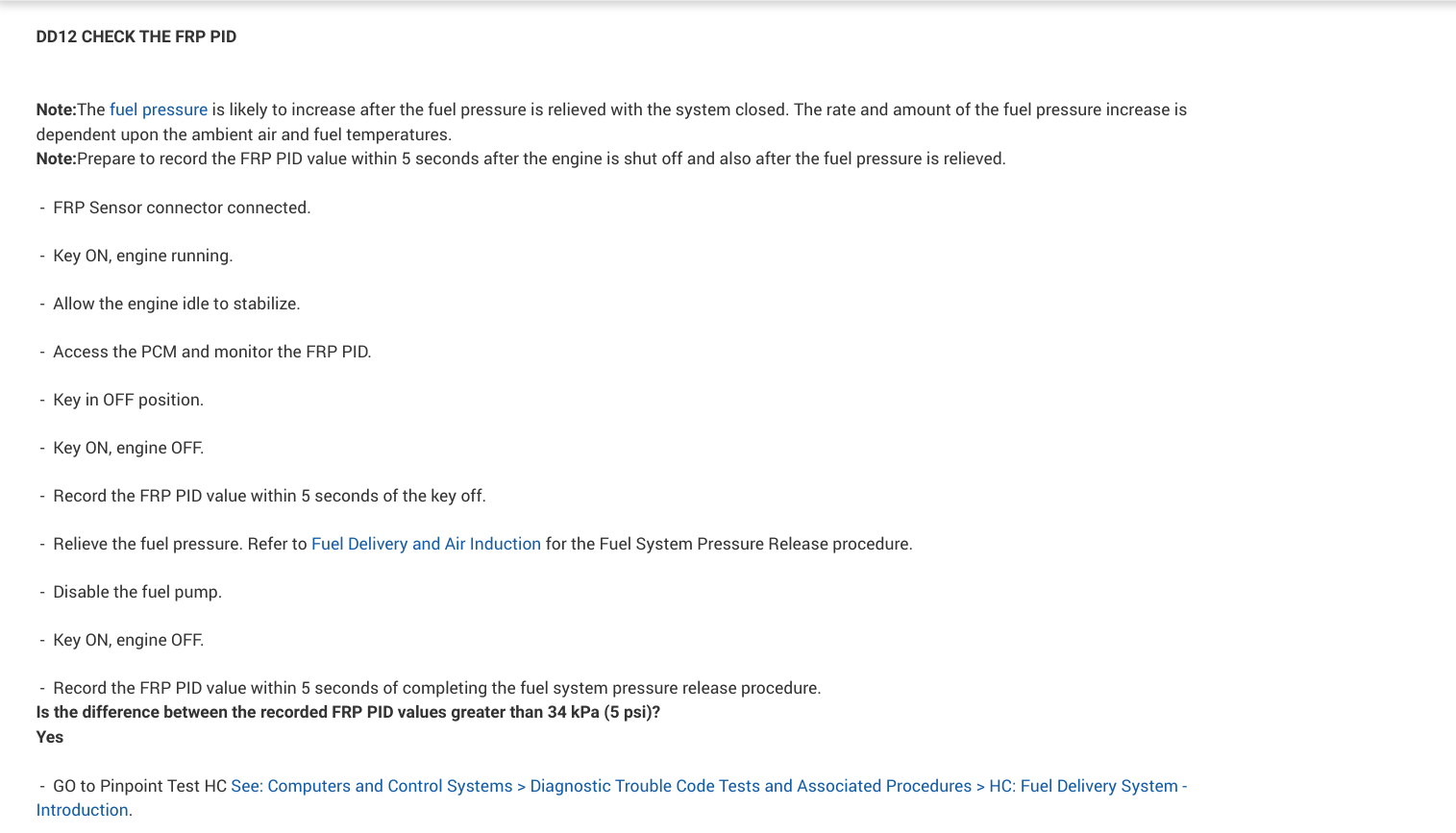

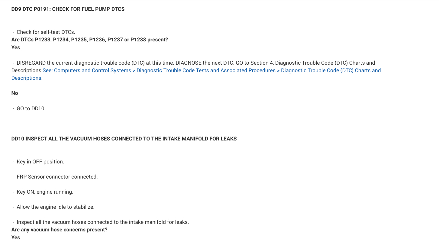

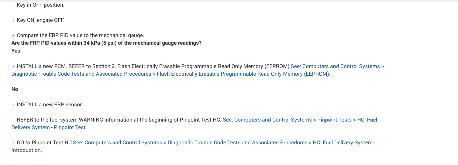

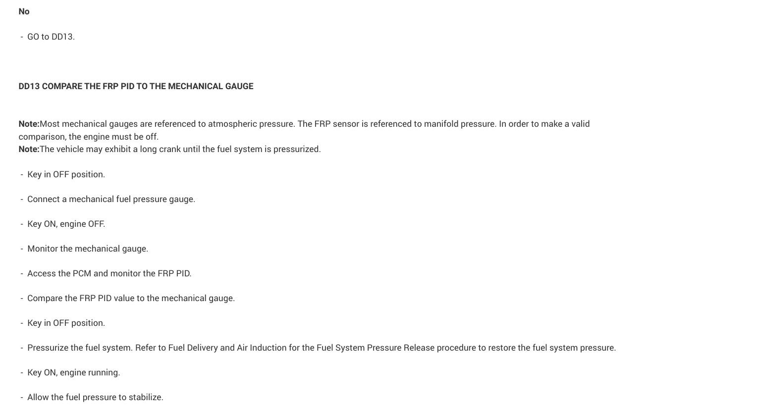

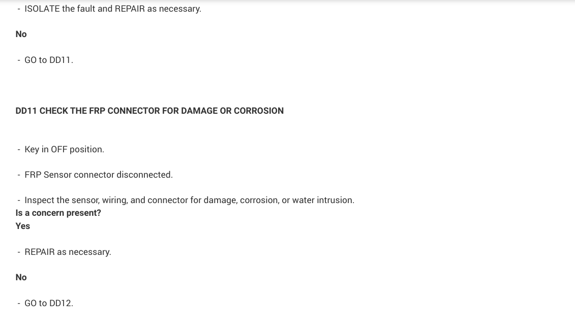

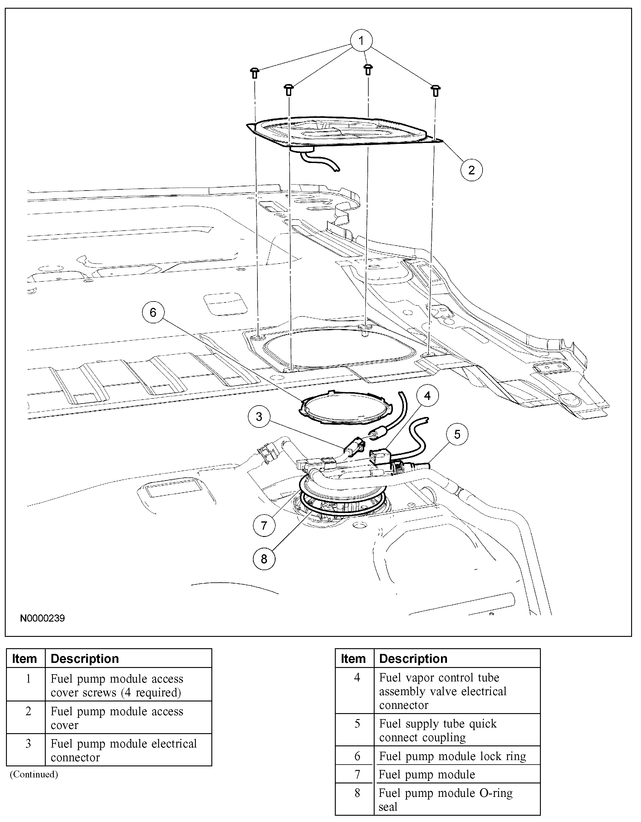

In the diagrams down below I have included the diagnostic troubleshooting guide from the vehicle manufacturer for Direct Trouble Codes[DTC][s] P0171, P0174, and P0191. Please go through these guides and get back to us with what you find out.
Thanks,
Alex

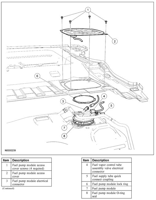

Jan 26, 2020 at 8:56 AM
BMDOUBLE
  • 1,139 POSTS
If the fuel pump in this vehicle is original, replace it! Then retest. I say this with confidence because I have replaced so many at my dealership that when I get an escape with these codes that has the original fuel pump in it, the first step is to replace the pump before any other diagnostics are to be performed.
