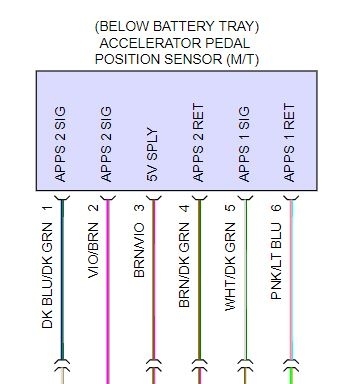

Code said the voltage is low at APP sensor. What pin does the five volts appear on the sensor and where does it originate?
Mar 9, 2018 at 4:31 PM
Good morning.
check the orange wire at the throttle position sensor at the throttle body for 5 volts. check at the pedal sensor for the same.
the voltages originates at the pcm.

Mar 10, 2018 at 5:55 AM
PATENTED_REPAIR_PRO
  • 1,853 POSTS
App wiring.
Mar 10, 2018 at 8:13 AM
GAITHER TUCKER
  • 10 POSTS
Thanks so much for your help. Found shorted five volt supply and fixed the problem.
