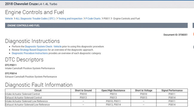

The code indicates an issue within the intake camshaft position sensor. That will put it in limp mode.
When this happens, does it happen when driving for an extended time or only on short trips? Also, is the engine oil clean and full?

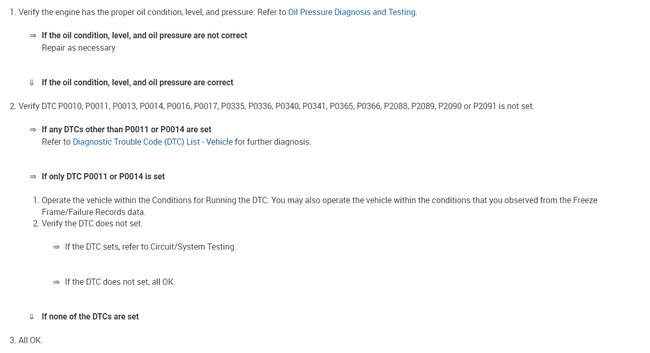

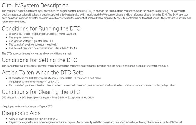

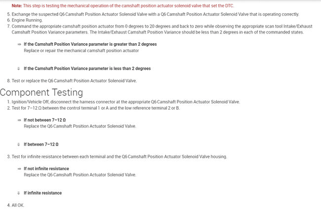

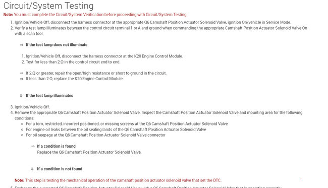

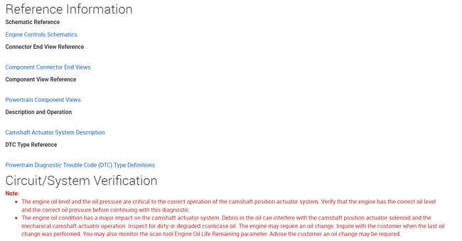

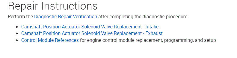

Let me know. I attached information related to the code below. It explains a description of the code, symptoms, and what to check. Take a look through it and let me know if it helps you.
I will watch for your reply.
