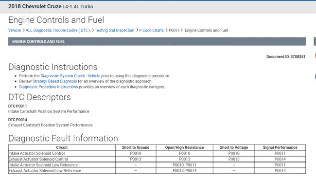

Since December I've gotten the check engine code p0011. Each and every time all but one, my car went into limp mode. But somehow after letting it sit for a while, I would turn the car on to see that the light had vanished, and my car would drive as normal. I'm just concerned as to why this is happening as I've never heard of a check engine light turning off by itself. I believe I have an idea but need a professional's opinion. Thank you all.

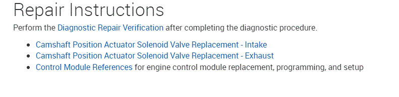

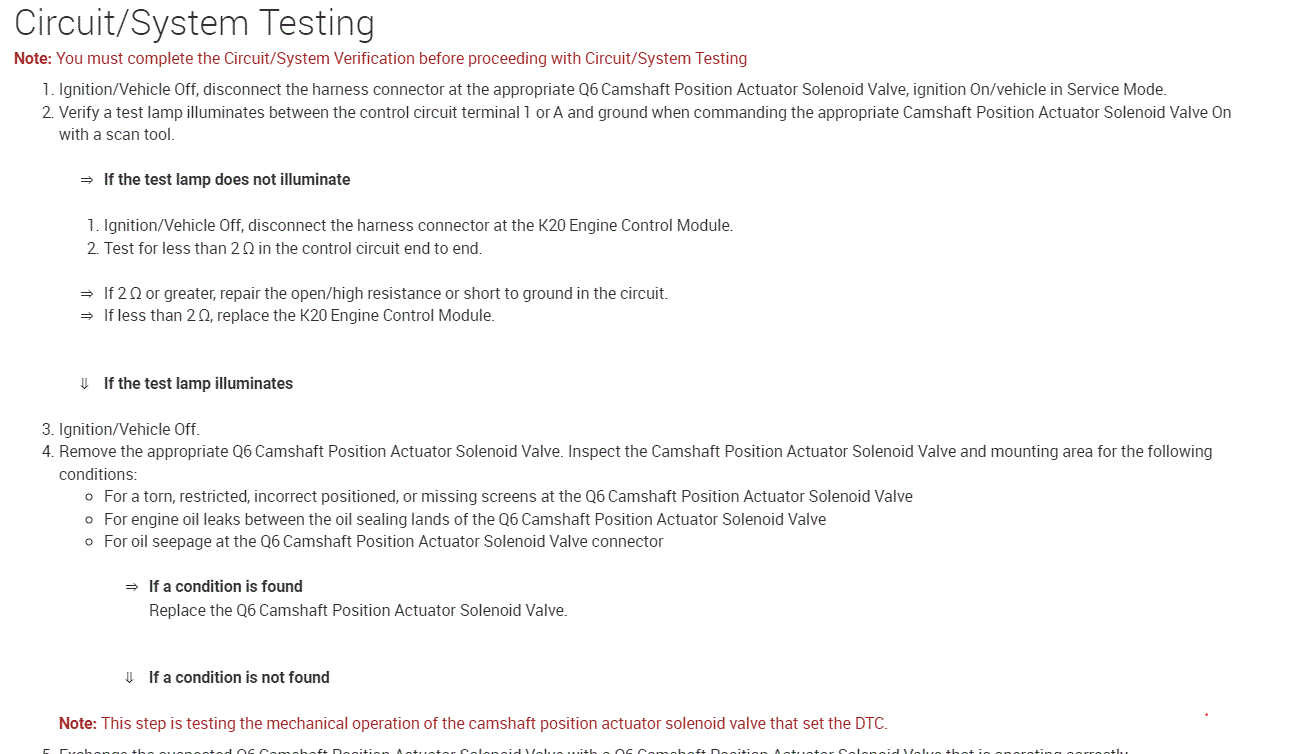

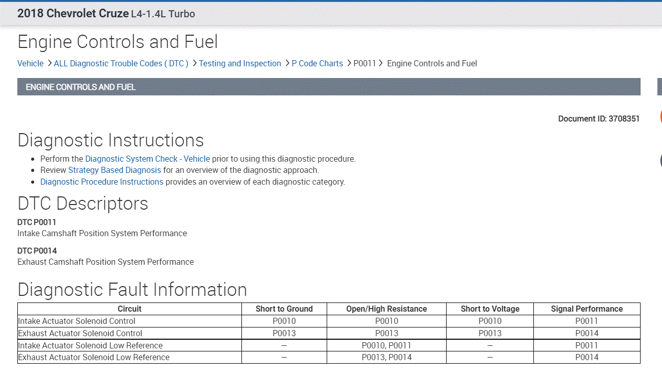

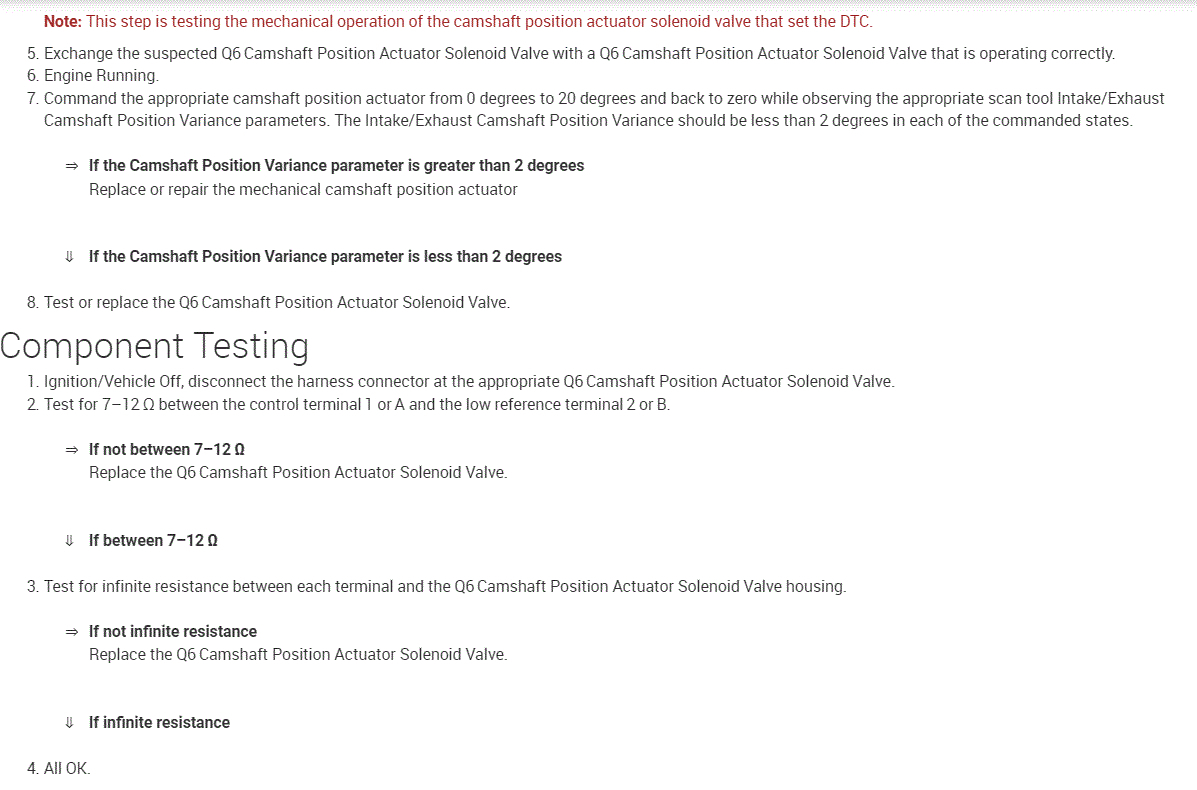

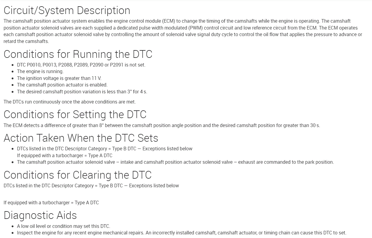

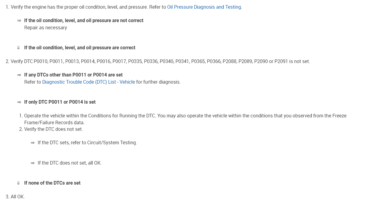

The code indicates an issue within the intake camshaft position sensor. That will put it in limp mode.

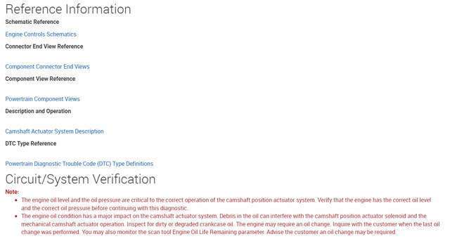

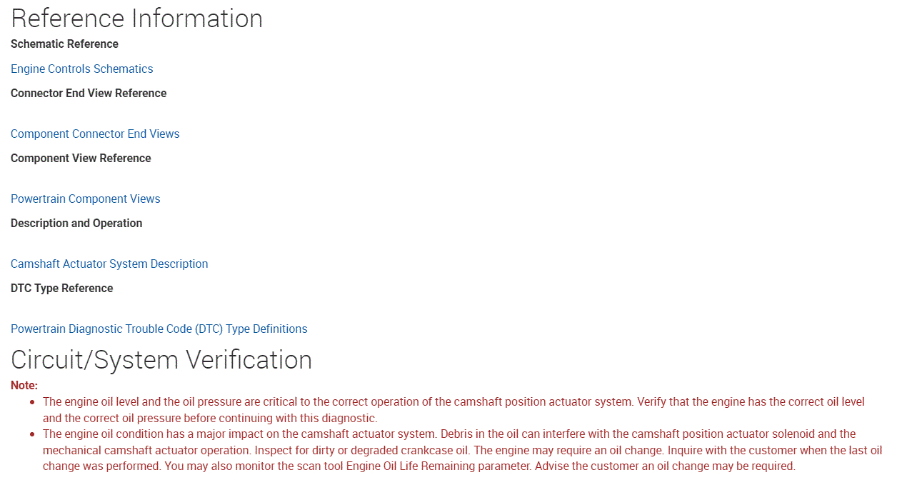

When this happens, does it happen when driving for an extended time or only on short trips? Also, is the engine oil clean and full?
Let me know. I attached information related to the code below. It explains a description of the code, symptoms, and what to check. Take a look through it and let me know if it helps you.
I will watch for your reply.

It is possible. Because of design, it is really important to keep the oil clean and serviced on a regular basis.
Now that it is warming up outside, does there seem to be any improvement? Also, if you just changed the oil, do me a favor. Check it to see if it is clean. I ask because there are detergents in oil. If the engine is really dirty inside, it will cause the oil to get dirty right away.

Okay, what you are saying does make sense. Do this, drive it and see if it continues to stay off. There are screens that can plug the oil flow to the cam actuators.
If it does come back on, let me know and we'll go from there.
